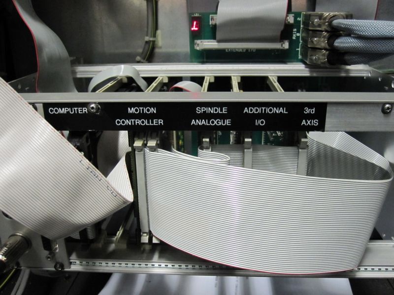

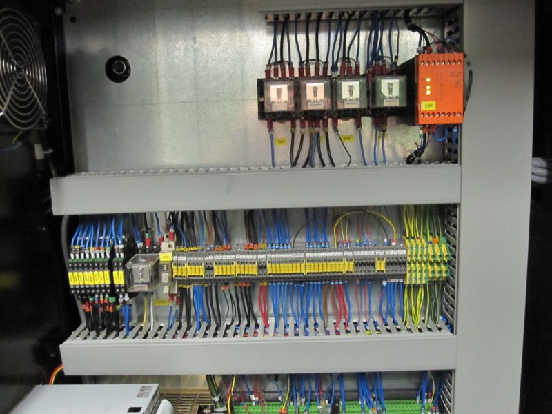

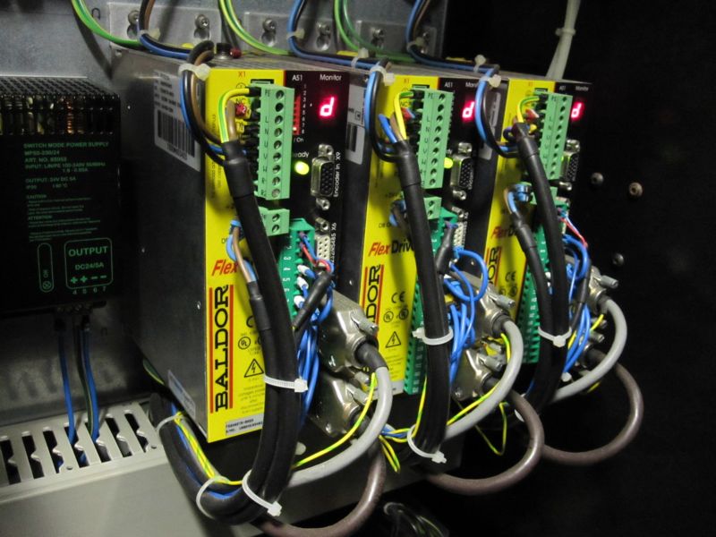

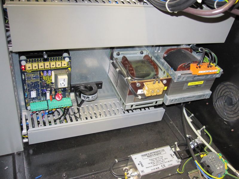

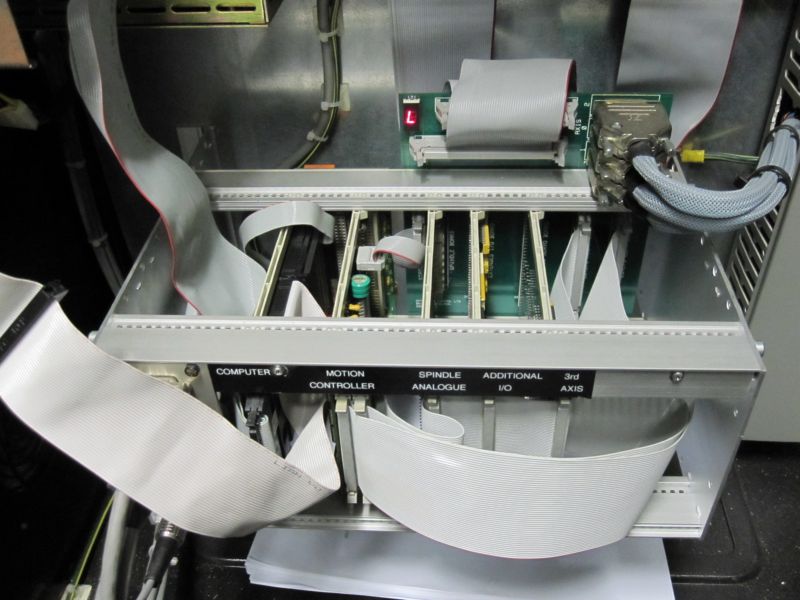

Here are some pictures of the control to help you identify the type.

I'd try and determine if the PC is dead, or its the monitor/cabling - we think it's the computer, but it'll be worth unplugging the VGA connector from the rack, and plugging it into a laptop/desktop to rule the monitor out.
Also, have a search for dspdesign on the forum,eg: viewtopic.php?f=33&t=2131&hilit=dspdesign
Re: Triac will not start up
It may be worth checking the voltage to the computer. I have had to turn up the pot to increase the voltage before. The easiest way to check is on the power plug to the floppy drive. It should read 5volts dc. If it drops below 4.75 then the pc will not power up. There will be a pot on the pc power supply unit which can be adjusted.
It may also be worth pulling the computer out slightly from the rack. You will need to remove the retaining plate & then slide the pc forward & back in to reseat in its socket.
Forget the earlier post about the power up jumpers. I did not realise it had the DSP computer fitted.
After much messing I have come to the conclusion that the DSP Design computer board has chomped its last bits, Mach3 here I come.
