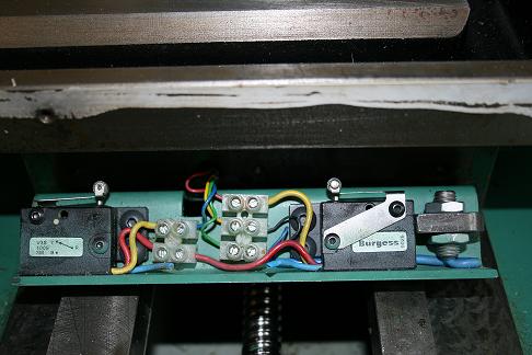

the x axis is not working- tried changing the axis control card- no diffferent. when checking the x datum switches notice 2 blue wires appear to have been cut by the previous owner(note pic) could this be the problem? also i have had to remove the battery from the eurostep controller card as it was starting to leak- what is the battery used for can the machine be run without it? where can i get a replacement?

note the 2 blue wires disconnected

The blue wires are terminated during manufacture but are from the X+ & X_ limit switch. The X axis datum is the proximity switch on the right.( thread showing). You should be able to test it by activating it with a piece of metal while performing a X axis datum request. It may be that the axis is moving the wrong way. What software are you driving the machine from?

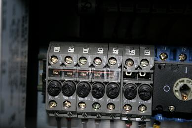

i have checked the cards are seated and ribbon cables are attached properly. i have swapped over the wires to the y axis with the x. the x then works fine. so its not the card as i have swapped the Y axis card with the x and it still does not work, its not the motor, its not the pcb board as i have swapped that too, all fuses have been checked ok. so its something in between- any ideas.
please have a look at pics below to see if you can see anything unusual with the wiring. thanks again.

Post by Denford Admin » Mon 03 Nov , 2008 9:58 am
So... (bear with me - it is Monday morning after all)
X Motor is OK
Wiring to X motor must be OK (Y axis can drive it when motor wires swapped)
X drive board must be OK (it runs the Y axis when swapped ?)
The control board thinks its outputting steps (you say the X counts up/down in VRMilling)
So, that really only leaves the signals from the Baldor to the X drive card...
I'll try and find the details of the rack connections, but you could have a good look at the connectors and tracks to find where the enable, step and direction signals are.

Post by Denford Admin » Tue 04 Nov , 2008 10:25 am
This post with photos of the rack, should give you a good idea of where the step/direction tracks are:
viewtopic.php?t=1763
PS - if anyone has the link or info on the Triac euro card pinout, it would be nice to post it somewhere easily found.
