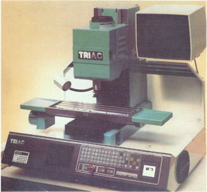

...Trying to check voltages on my Triac's inverter while main drive motor was running at low rpm, accidentally the multimeter's tip came in contact with improper terminal.
Instantly it lost screen entries which makes it impossible to communicate
through machine's dialogue.
Triac looks dead after that and I can only see green straight lines on the crt.
If some of you have experience with this particular mill of 1986 please give me a hint of where to look at.
Replacing the inverter might fix the problem?
Because this machine's main board architecture is based on xx74 series TTL
low voltage I just hope the short circuit that I caused may not have damaged low voltage control circuits.
Thanks in advance.

...Hi Martin. My name is Dima. _All fuses, those on the hidden rear panel and those on the board are intact.
I own another Triac as well. The green one which is earlier version by 2 years i think and wiring is not 100 percent interchangable.
If it were i might have located in which section is the problem.
I have managed to pinpoint trouble in my Orac's X-drive and fixed that overnight but with the Triac I can only cross my fingers...
Roger Martin...That's the one.
