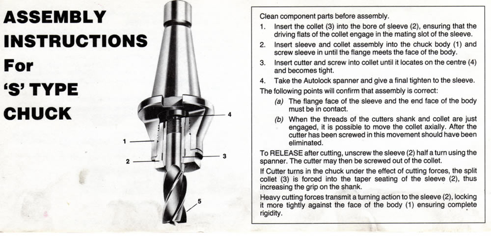

I have even managed to find it
Here you go, perhaps Admin could put it in the downloads, for others to use? As I know a lot of people struggle with not knowing how to correctly operate the Autolock chuck.
Sorry the Pics are so big
, I have limited photo editiing on my work laptop
- autolock1.jpg (128.55 KiB) Viewed 6294 times
- autolock2.jpg (95.38 KiB) Viewed 6294 times
