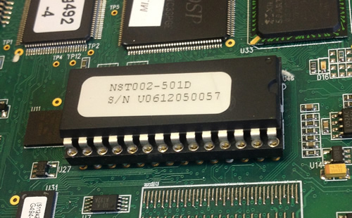

I've never seen this issue with the machine connecting at 9600 baud.
Those cards always used to connect at 57600...I wonder if Mint Workbench negotiates a reliable speed when it connects (VR Milling won't do this and always try to connect at 57600) This might explain why VR will only connect when workbench is running and has already made a connection.
In the distant past we had some strange issues with the EEprom which was fitted to the Nextmove ST with only RS232.
This EEProm can be removed and VR should still connect OK...its worth a try anyway.
- Try remove this EEProm
- photo.jpg (81.02 KiB) Viewed 16336 times

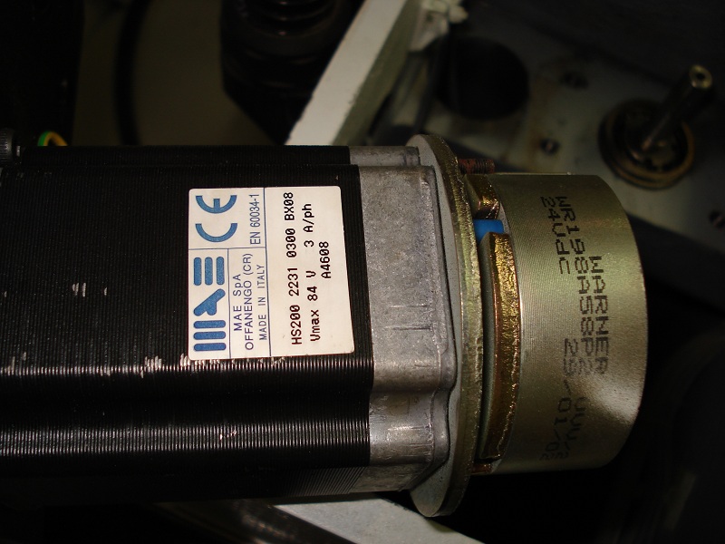

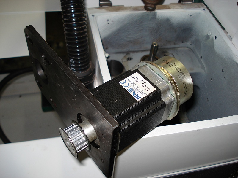

Ok, now I tried to take off the belt and turn the pulley alone and it worked.
The problem is in the motor. Is there some kind of break in the motor that might make this?

Can you post a picture of the motor. We have fitted brakes before but I can't remember on on a Triton.

Yes, I tried with the power off.
I am posting the pictures of the motor.

Re: Routine Problem
It does have a brake.
It's the brass unit sat on top of the stepper motor.
If you remove the brake from the motor you can check the stepper motor then go back & check the brake. It is a 24 volts DC unit & will be locked until power is applied.

I removed the break and tried to move the z axis. Even without the break the motor didn´t run.
It only makes a shrill noise. After removing the break I am able to rotate the motor by hand.
Re: Routine Problem
Try to eleminate the stepper driver or the motor wires/motor by swapping the X axis with the Z axis.
If the Z motor now runs (from jogging the X axis) then the driver is at fault.
If the problem remains on the Z then the motor or wiring is faulty.
