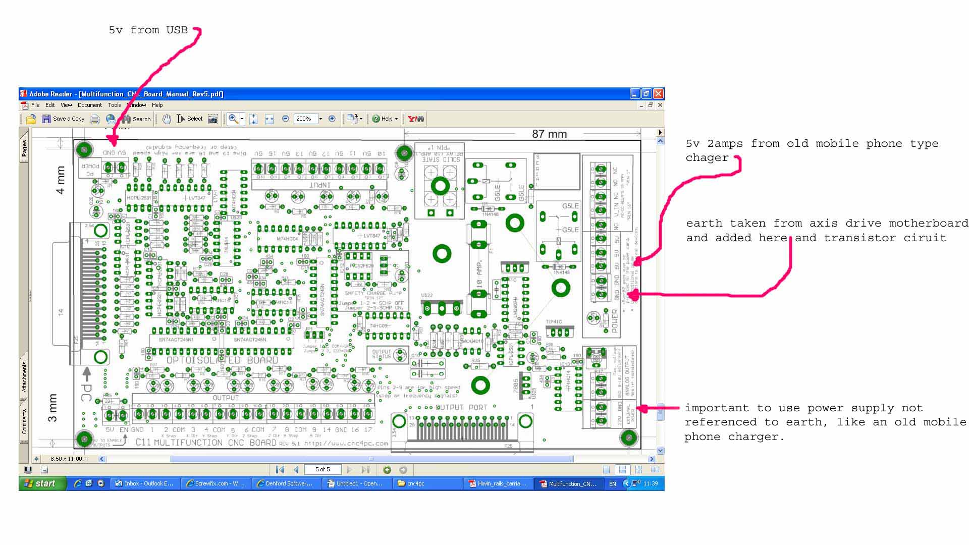

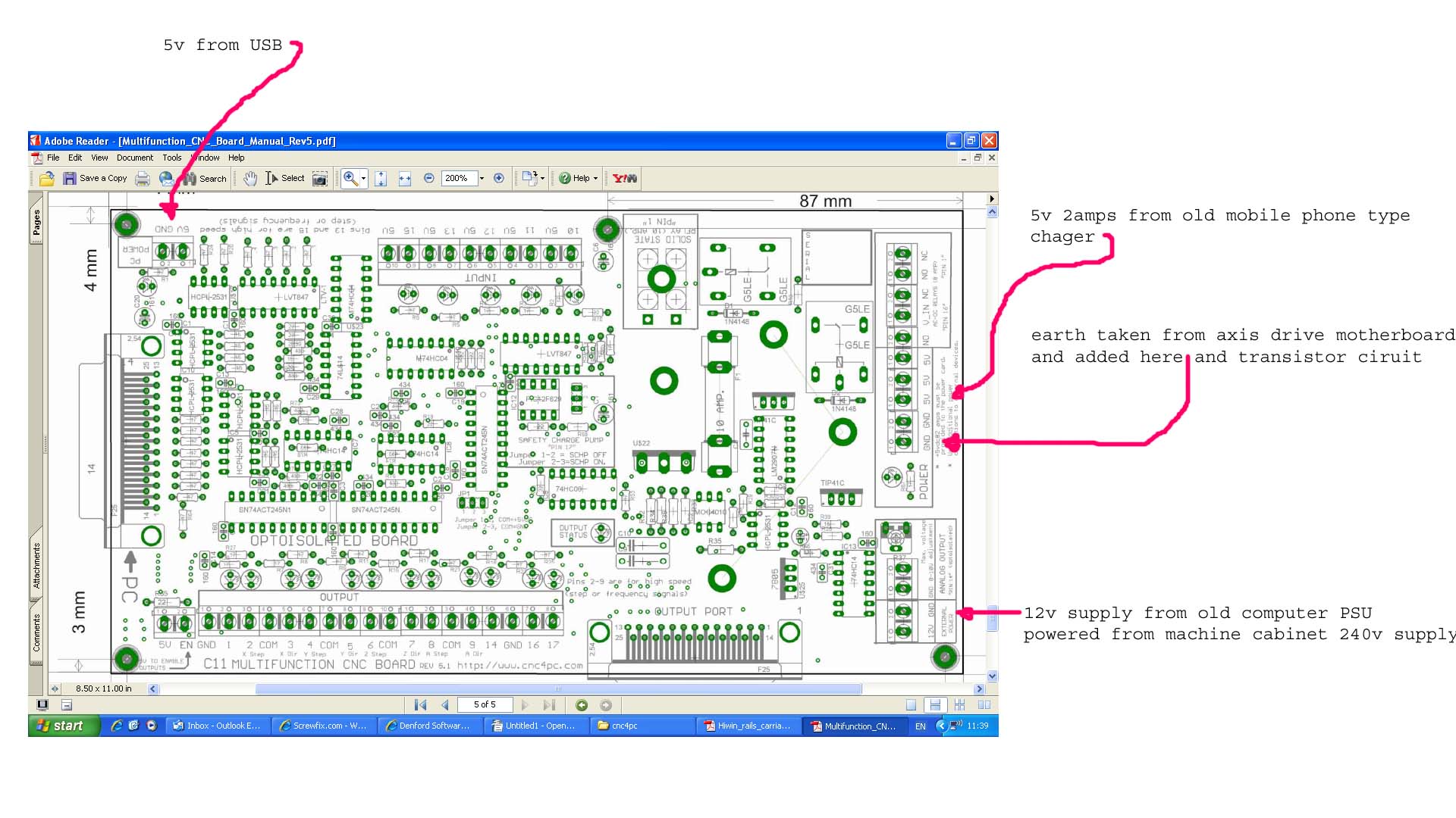

Hi, I've replaced the fuse in the controller which was a massive 20amp with a 5 amp fuse and controller is still working. I've found a 12v old brick type charger and please correct me if I'm wrong, I need to supply 0-12v without a reference to earth like the battery I used. I checked the brick type power supply with my multi meter with one lead on a good earth ( machine cabinet ) and the other to the + and - end of the power supply and I'm getting -0.1v which is jumping around a bit between 0.05v/0.15v when I did the same test with the old computer PSU it was reading the full 12v which basher figured out was my problem. Is this small -0.1v okay?

Spindle now running under full control of Mach. Thanks to everyone and to basher for your help pin pointing the problem. I've upload modified jpeg of BOB wiring just to help anyone following the thread. Next job is to tidy all my cables into the machine cabinet. Next on my list is to buy a license for Mach, then I'll upload some video on youtube showing off my new axis speeds. Only two jobs left, limits and homing switches, and tool release from spindle. Which I plan just operating from a switch manually placed somewhere inside the machine. I'll take a wee breaking for now, as the last three or four weeks have been all about this machine.

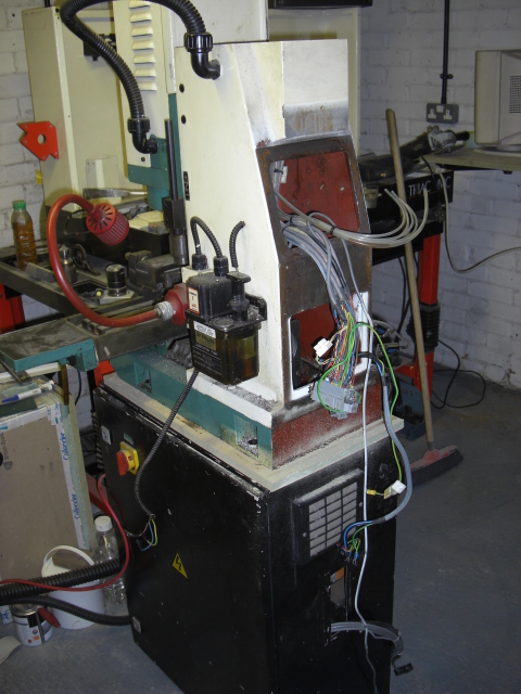

Just an update of where I'm up to on my conversion, I've uploaded some photos on the separation of the mill from the machine cabinet. I've done this to save space. Next on the to do list is weld up a small table to house the mill, electrical cabinet, computer and monitor. I've removed the tool changer as this will be done manually for now, but I am undecided on whether I'm going to use air draw bar or make a manual lever.
- Machine on top of electrical cabinet.
- CIMG1951.JPG (238.8 KiB) Viewed 43319 times
- Machine cabinet
- CIMG1952.JPG (216.41 KiB) Viewed 43319 times
- Back of machine
- CIMG1954.JPG (253.2 KiB) Viewed 43319 times

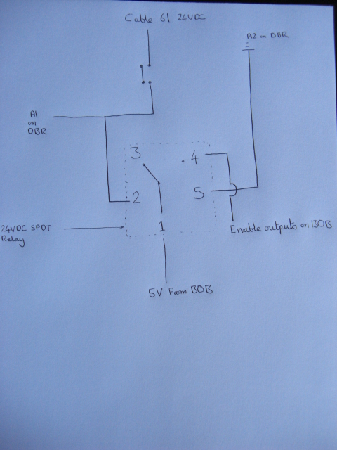

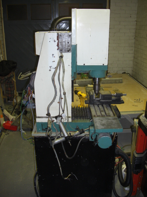

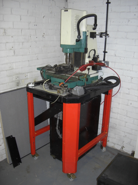

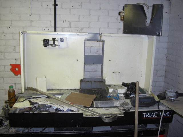

Hi, another update and a request for help. I've uploaded a pic of the mill free from the old machine cabinet and a reduced work bench. I am very happy with the space I have saved
. I have also got the tool draw bar to work from a switch which I have mounted under the machine cabinet, and have incorporated a small safety feature using a 24vdc relay to disable outputs on BOB when draw bar is active (see photo).

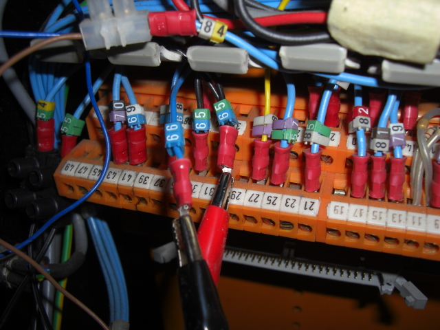

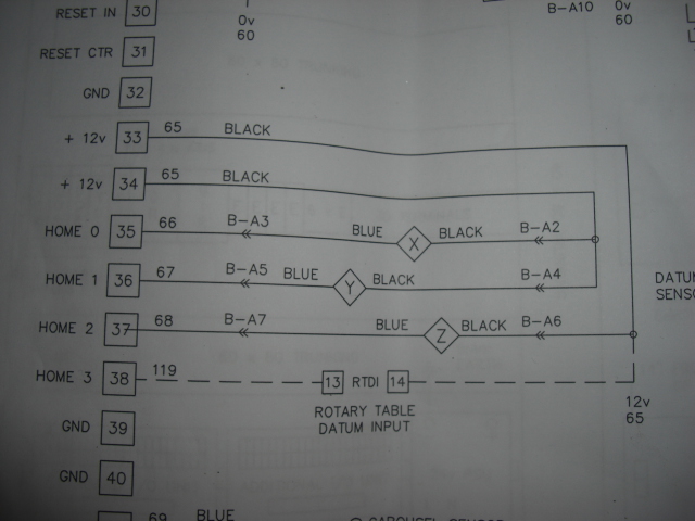

My request for help is on the matter regarding the datum sensors, I have managed to trace the cables from the wiring diagram (see photo) and have done a resistance test on x axis sensor, all is fine. The diagram indicates 12v @ cable 65 going to the sensor and returning via cable 66, the problem is that there is no voltage at cable 65. So next I added 9v supply from another old mobile phone type charger and placed a piece of metal in front of the sensor and noticed a 0.5v increase. Does anybody no a way of wiring and configuring this type of sensor to Mach's 5v I/O?
I am planning of leaving the mechanical limit switch's as they are. As when they are switched power is cut to all drives, Mach will still carry on running through the program, but the machine will be in a safe state. Any information would be gratefully received
Regards Dale
Regards Dale

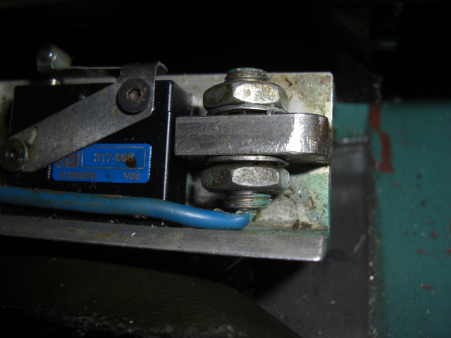

I replaced all the datum switches with micro switches, it was a little tricky as space was tight, but it made for simple wiring as I used the 5v from the output on the BOB and picked up the wiring from the 50 way interface RS board in the machine cabinet. I'll take some video and post to youtube in the near future. Thanks for everybody's help with this conversion
Regards Dale.

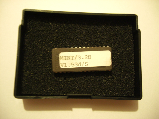

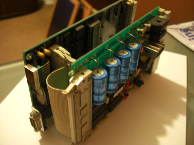

ITEM FOR OFFER
Here are some bits left over from my conversion if anyone whats them I'll ship them just to cover the cost of posting and packing, paypal prefered. If you have read this thread you will understand these parts have been removed from a denford with noise problems so I can not guarantee if there are fully working. They might just keep an old machine going for a bit longer.
Regards dale
