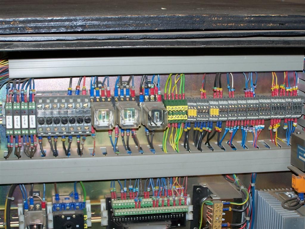

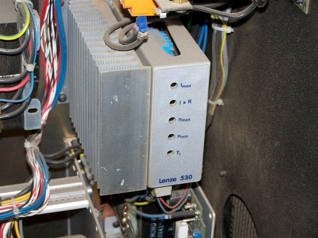

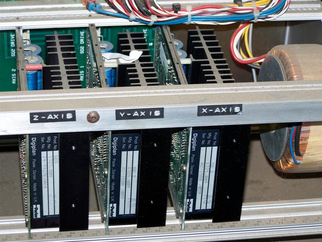

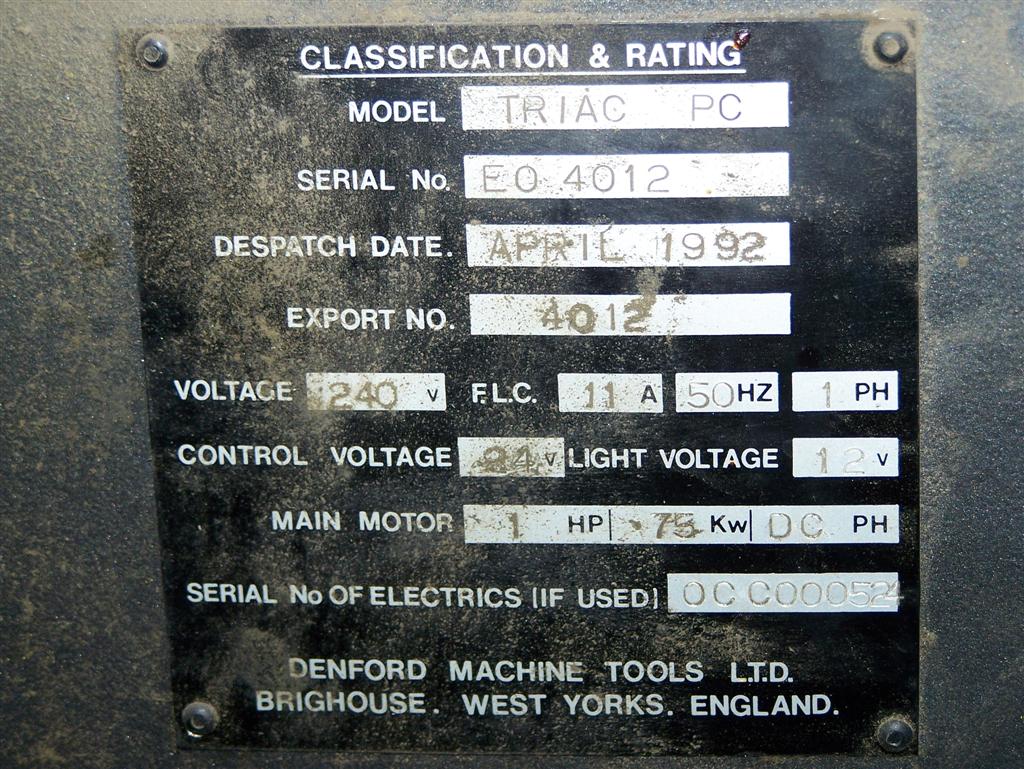

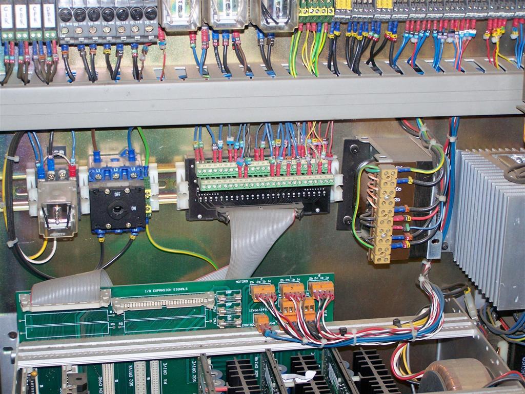

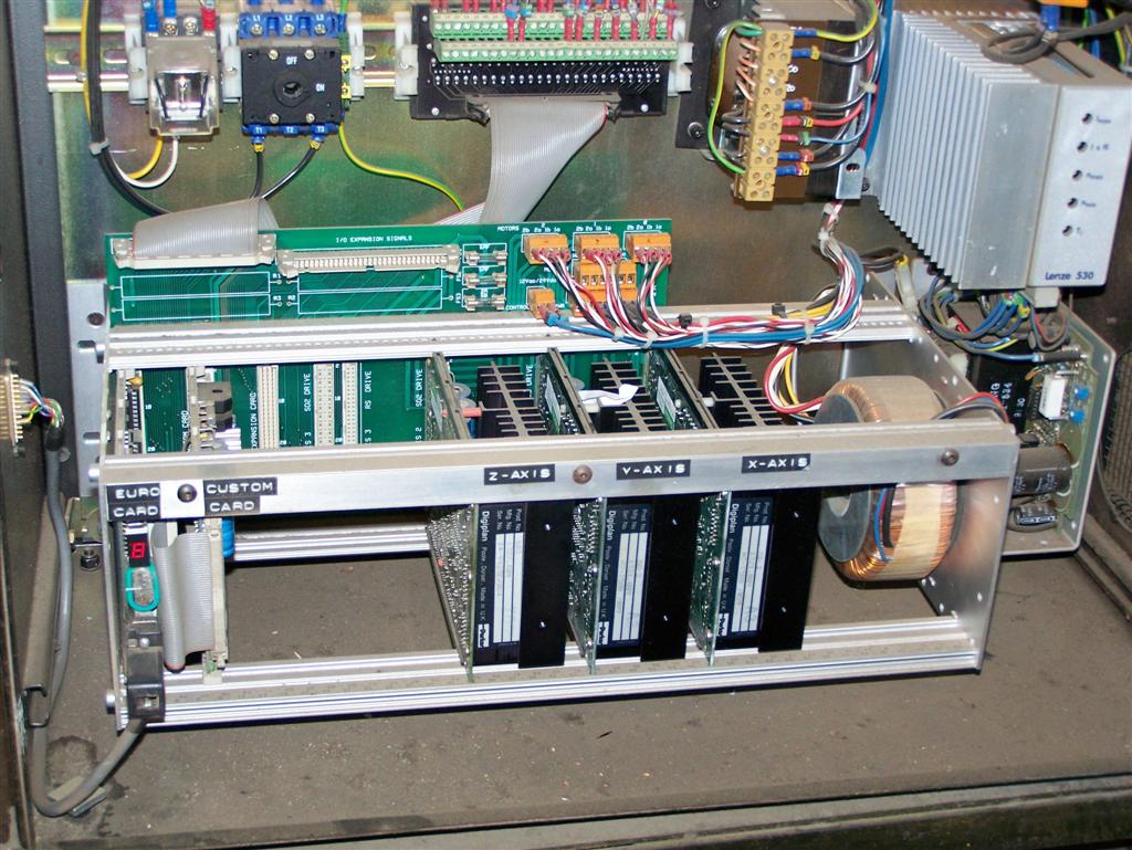

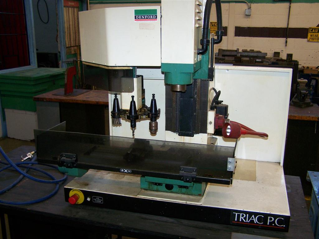

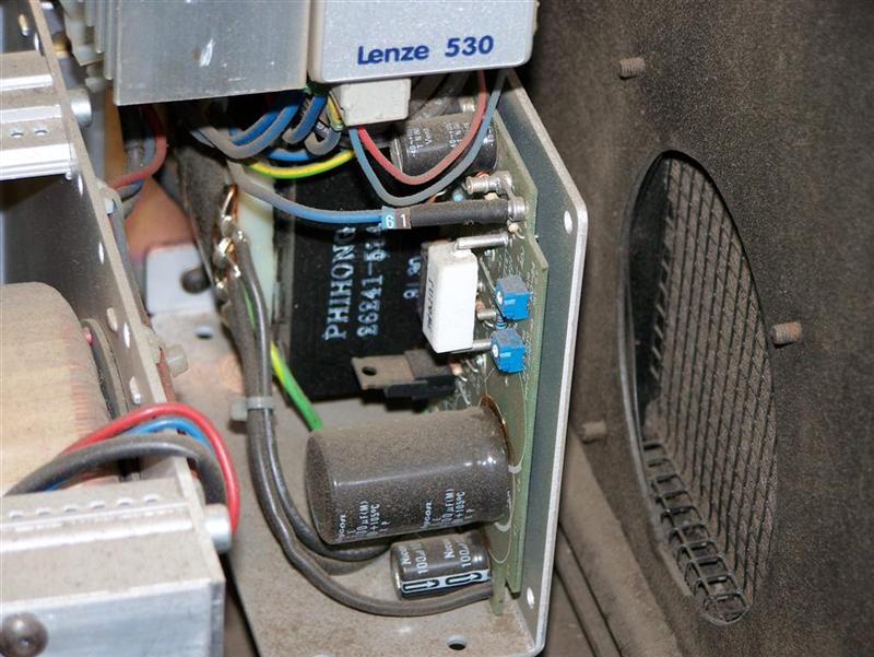

ps - a picture of your machine and the inside of the electrical comartment would help us know exactly what we're all talking about :wink:
Post by Martin » Wed 22 Apr , 2009 12:51 pm

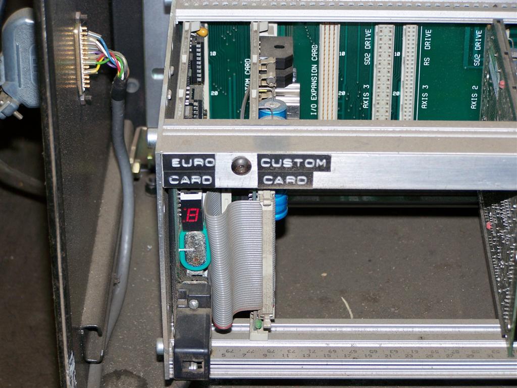

It may be worth also taking a picture of the EPROM fitted to the control card.

Post by codyst » Wed 22 Apr , 2009 13:44 pm
Here are some pics of the machine and control cabinet.

Post by Martin » Wed 22 Apr , 2009 14:19 pm
Can you take a picture of the Eprom on the card in the bottom left? It`s the one with the red 8 segment LED on it.
