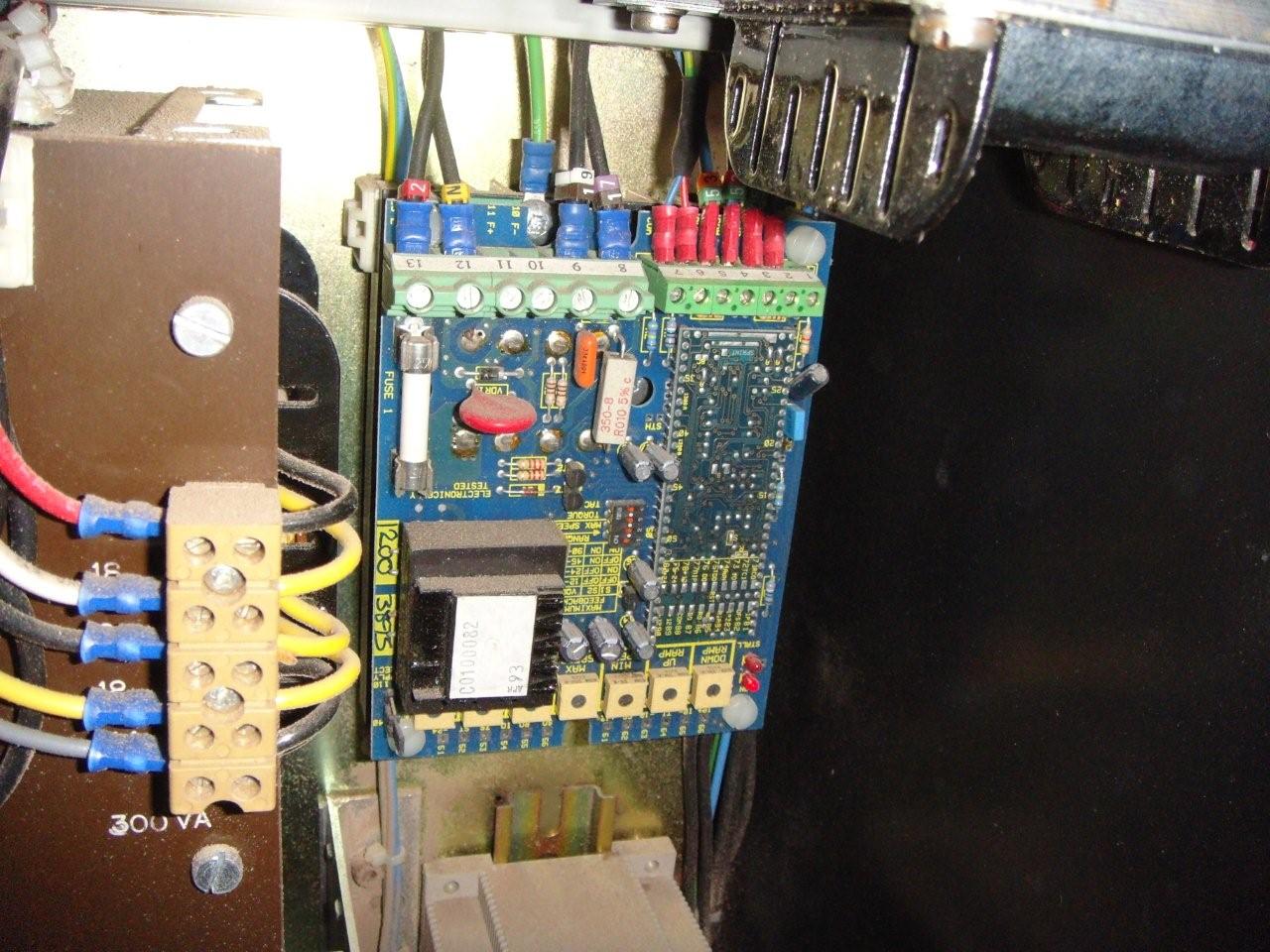

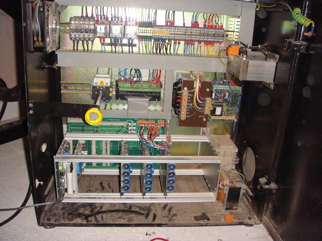

I have attached some photos of the controller hoping someone here can help me before my wife finds out I blew £2k on something broken :-(

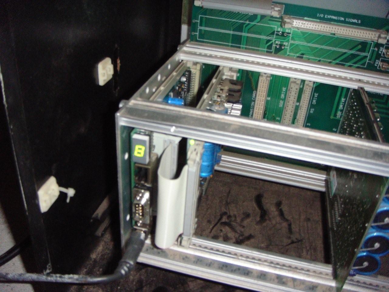

Is the analogue control card the one next to the Baldor card connected by a large ribbon?....i.e 2nd from the left on the rack in my picture?
Oh just one other thing my Sprint card has a label saying it's a 1200, is it still the same manual?
Paul
Posts: 3651
Re: Triac PC Has it died?
Post by Denford Admin » Fri 03 Jul , 2009 9:24 am
- Yes
And this picture should help:
viewtopic.php?f=15&t=634

I fitted the new sprint board copying the dip switch and pot settings from the original and away it went.
After a satisfying myself it was all fine I decided to take off my 10k pot and try the analogue connection again.... as soon as I went to start the motor it took out the RCD in the house!.... which I have to say surprised me some what ...anyway I wasn't prepared to try that again so I went back to the pot and all is well.
I'm thinking that maybe the the analogue failed first and took out my sprint with it.
