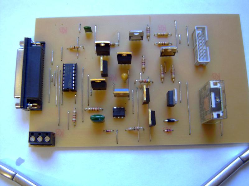

Hi Again
Been quite busy developing this Mach3 interface board.
Soon to be available on Ebay, probably as a kit.
This particular interface board offers
X, Y & Z step and direction.
O - 10V output.
Homming via X, Y & Z limit switches.
E stop.
Charge pump control.
Although developed for the Triac I beleive this could be used with any NC machine but may require a little tweeking.
O - 10V output.
E stop.

Great to see you have been working on the board hpdrifter, and that a kit may be available is great news. I have been working on Haas's latley so being spoilt by a decent control, i will be back to basics on the Triac. Therefore a Mach 3 upgrade might be imminent!
In reply to your earlier post hpdrifter, with regards to cost. Similar to Matt, Not knowing how much work you have put into it it would be dificult to say. But if you are thinking of putting the kit on ebay I assume you already have an idea in mind.
cheers, Roy

Hi All
I am just trying to produce batches of PCB's in a cost effective way before going any further. Machining is not an option for batch quantities as the cycle time is too long.
I have had a number of questions/enquiries regarding using it for other CNC machines. On the final version of the board I have terminal block outputs as well as IDC for the Triac.
This means it can be interfaced with more or less any machine giving a cost effective way of using Mach3.
Providing you can determine where you need to input the X,Y,Z (Step& Direction) to your driver boards and have access to the Limit switch wiring etc. then this will work fine. The additional features of an Estop input, 0 to 10V speed control and Charge pump control are also included.
