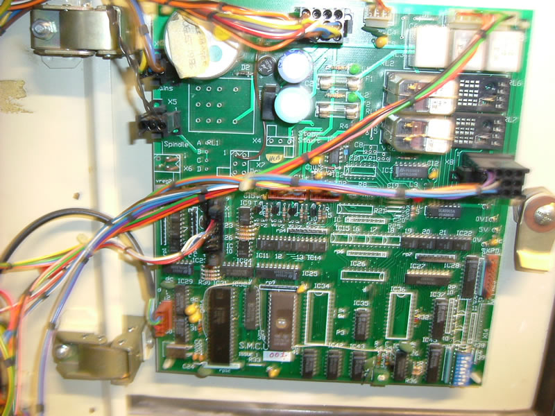

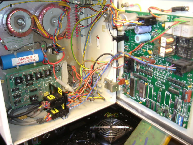

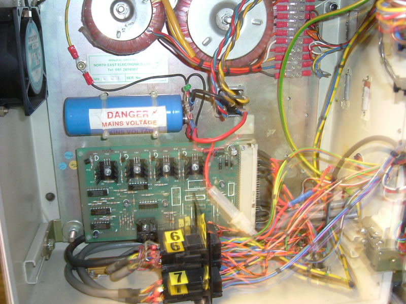

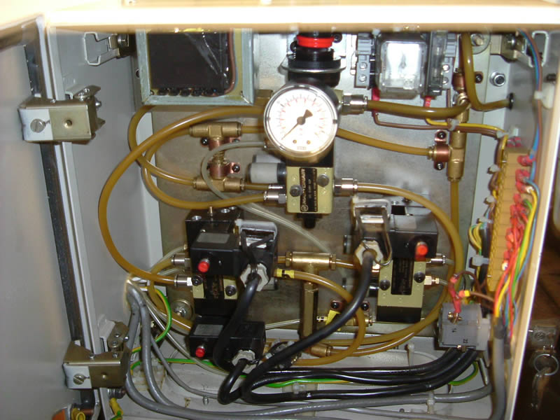

ok, here a few pics of the inside of the rear cabinets. The left-hand one(viewed from the rear) is full of electrnics whilst the right-hand one is mainly pneumatics.
The left hand one does look to have had a bit of a refit at sometime with evidence of old cabinet holes being covered up and redrilled. The factory records indicate it did come back to Brighouse during 1991 for a refit (?) so this might explain that one.
I will also take a pic of the short lead if anyone needs to look at that, but being only around 12" long it is too short to feed the monitor.

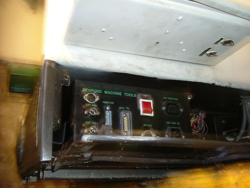

You will also see from the pics the two sockets on the underside of the left hand box.

Ahhh - the pics bring back memories !!!
And if my memory serves me right then...
- The RS232 connector on the top box should connect to the unmarked socket above the vidoe connector on the back of the machine
- The Toolchanger connector on the top box should connect to the 15 pin Aux I/O connector on the back of the machine
