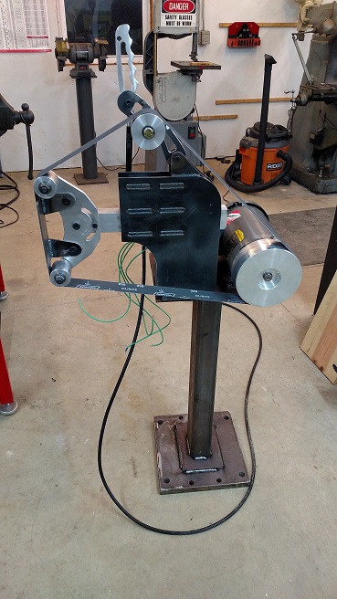

Other than that the Triac has been running great. I have been making all kinds of parts for my 2x72 belt grinder I am making. The Mach4 conversion was a game changer...if the part is screwed up it is always my fault. The only thing I have yet to figure out is why the spindle will not slow down gradually to a stop after running in reverse. Instead it stops abruptly. It is not a big concern since I never run in reverse, but would be nice to figure it out.

The belt grinder looks superb, I recently watched this: https://www.youtube.com/watch?v=a_RlL1O-bK4&t=101s
some really interesting ideas gone into the design.

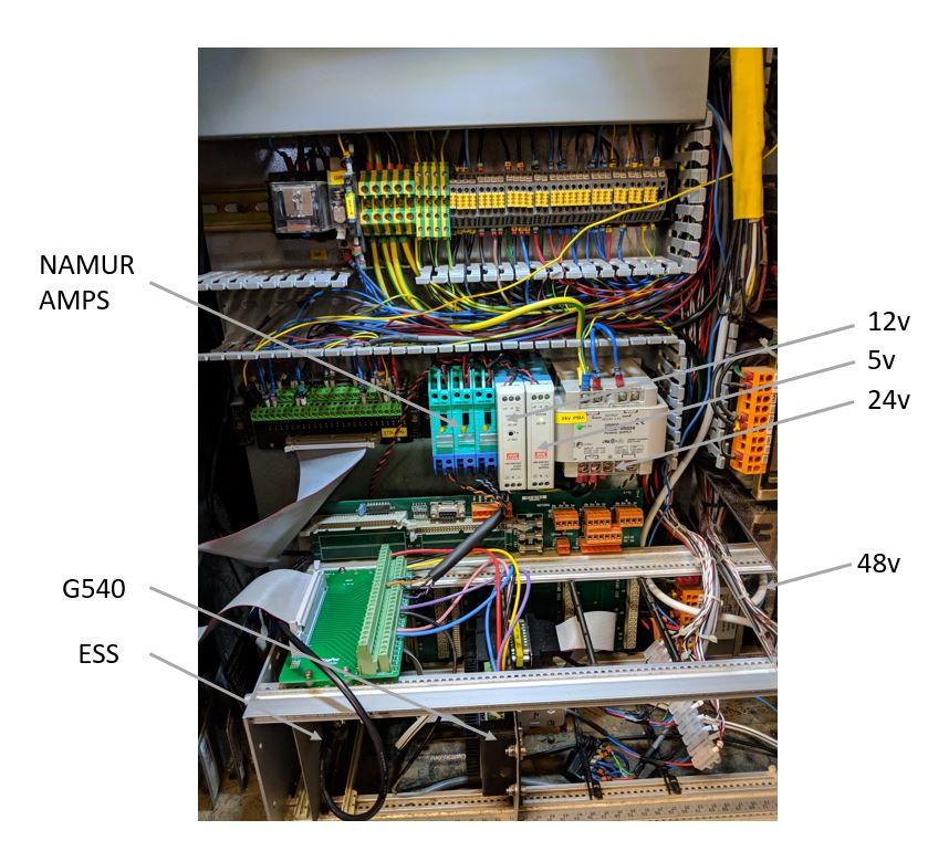

Hey Rob,
Thanks you for such a comprehensive reply. I have a dual core shielded cable ready to try. I will try it ungrounded first and if that makes no difference I will ground it to the 48v power supply that the steppers use.
The other thing that I could try is connecting the ground of the other supplies. I have 5v, 12v and 48v supplies that I have added plus the 24v supply that was already in the cabinet.
This is how it looks at the moment:
