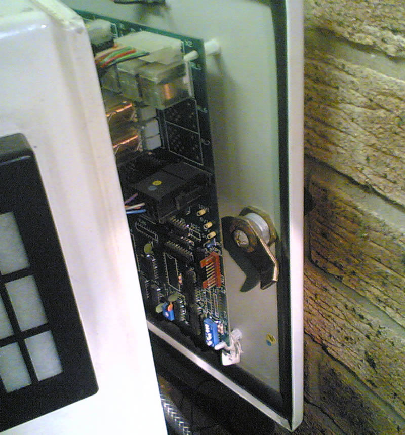

the dip switch settings i need are in the rear electrical cabinet door on a blue switch see below... if anyone could send me there settings - would be most greatful (and maybe a reward if it works) cheers,,, matt...
- dips1.jpg (127.25 KiB) Viewed 15225 times
- electrical cabinet door below external monitor...
- dips2.jpg (92.54 KiB) Viewed 15225 times

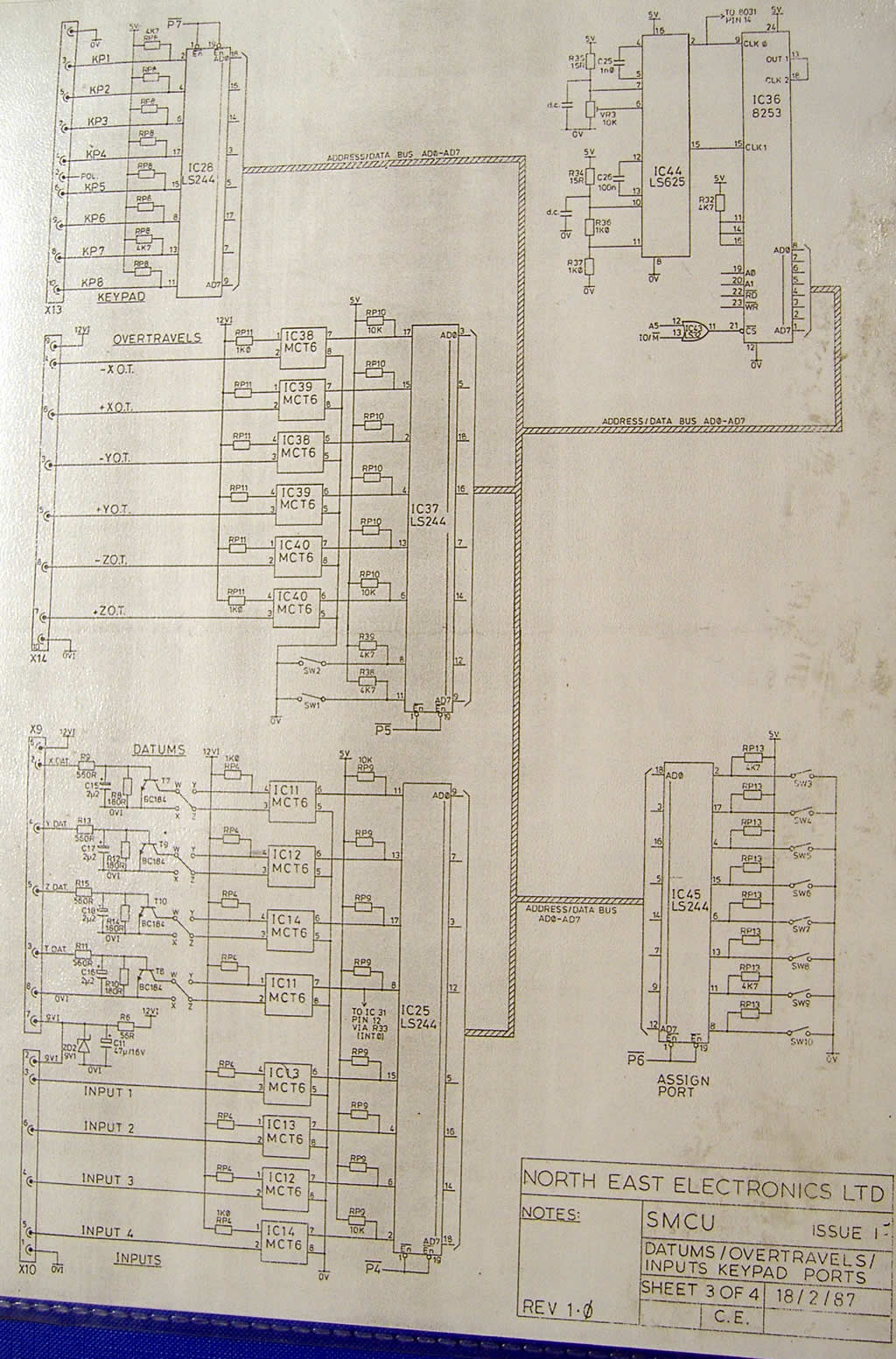

Found some info that looks relevant ...
Seems like the 8-way DIP switch is connected directly to an Octal buffer (74LS244), which in turn connects to the boards address and data bus.

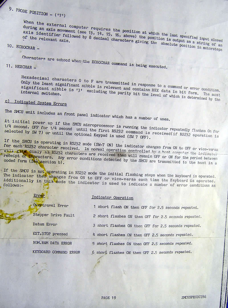

I've run out of (spare) time to upload any more pics, but the only instructions (I can see) about the switches say:
SW7 on is RS232 operation
SW7 off is optional keypad usage
The switches are also mentioned regarding HEXCHAR, and level of parity
I would be tempted to scope up pins 1(/EN) and 19(/EN) of IC45, to determine when the processor actually reads the state of these switches. (The signal should be normally high, and will go low (0V) when the chip is being read)
At least then you have more chance of finding a setting that works and what the switches actually do.

- Schematic of tool changer SMCU board
- triac-toolchanger-smcu-schematic-3of4.jpg (224.52 KiB) Viewed 15145 times

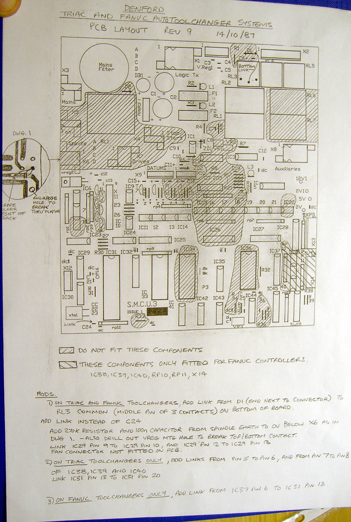

- SMCU board PCB layout
- triac-toolchanger-pcb.jpg (380.05 KiB) Viewed 15145 times
- SMCU board errors and some mention of the switch settings
- triac-toolchanger-sequence4.jpg (136.8 KiB) Viewed 15145 times

It does still ring a bell that there could have been some battery-backed RAM on the ATC controller and your problems could be related to this (I'm not too sure about this so treat this as a 'maybe'!!!).
The Battery-Backed RAM was in the form of a regular 32 pin CMOS RAM chip mounted on a 'fat' socket that housed a battery (the socket looks like a regular dil socket but about twice as fat) Looking at the PCB layout diagram I'd guess it'd be IC33. If it is on a battery backed socket then it could be this that has got cleared ??? I don't have a solution if this is the case
