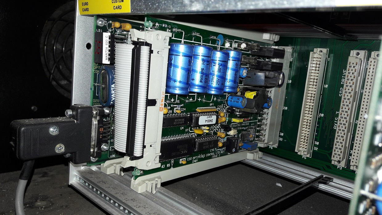

I require a bit more help. I have swapped out the eprom but I only get a .L flashing on the eurocard. Not sure if this is an issue with the eprom or not. The other two boards I have don't have v2.1 eprom, they are green segment boards. Would the eprom from one of those work or is there a way to tell what is going wrong?

The .L flashing just means you are not connected to the software. Have you tried to communicate with it?

Post by minimad30 » Tue 13 Dec , 2016 9:02 am
