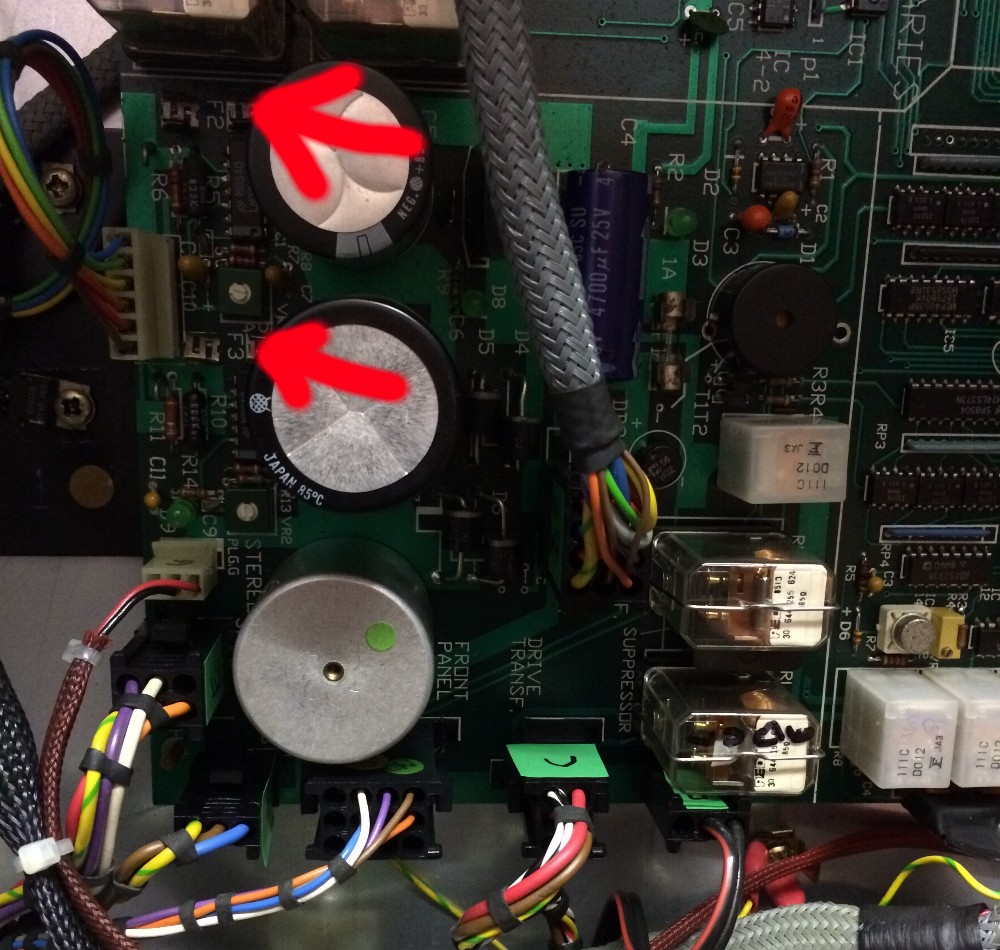

Can you send me a picture of the area where the fuses are blowing. this will give me an idea of what version of pcb you have. It should be relatively easy to fix.

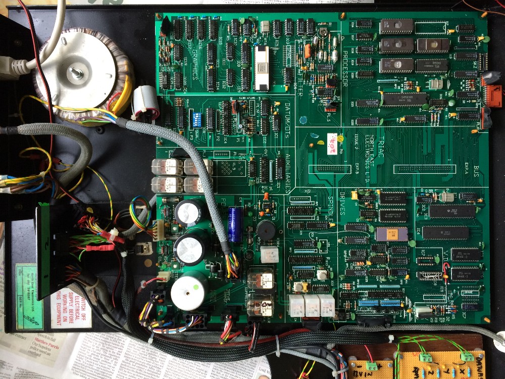

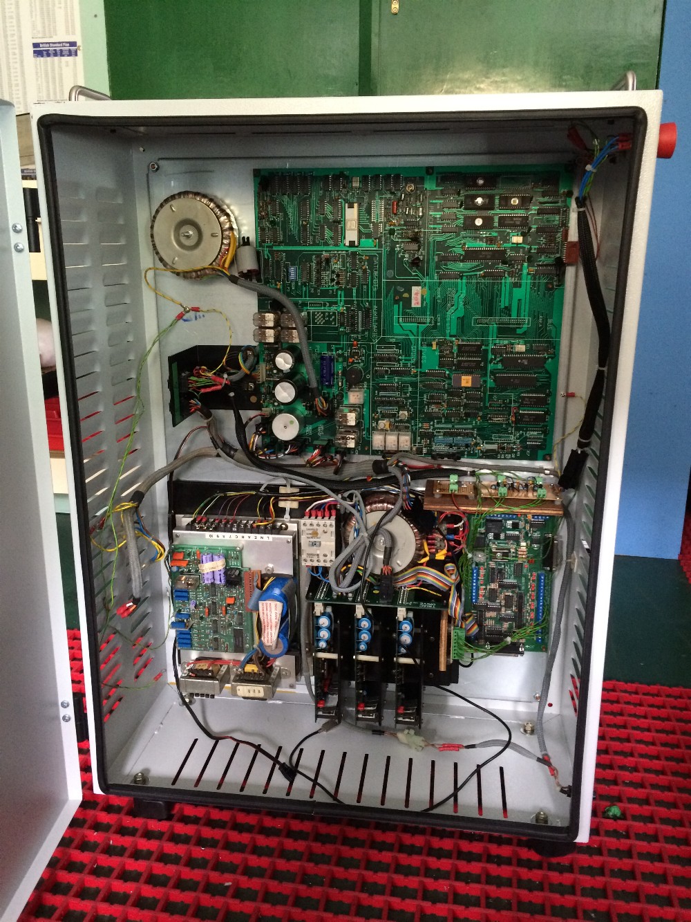

Here is a view of the complete set-up in the old drawer, and then in the new cabinet.(a few weeks ago before wiring complete)
The last one shows a close up of the problem area, (fuses removed)
Its fuse F2 & F3 which are both 3.15 Amp time delay ones.

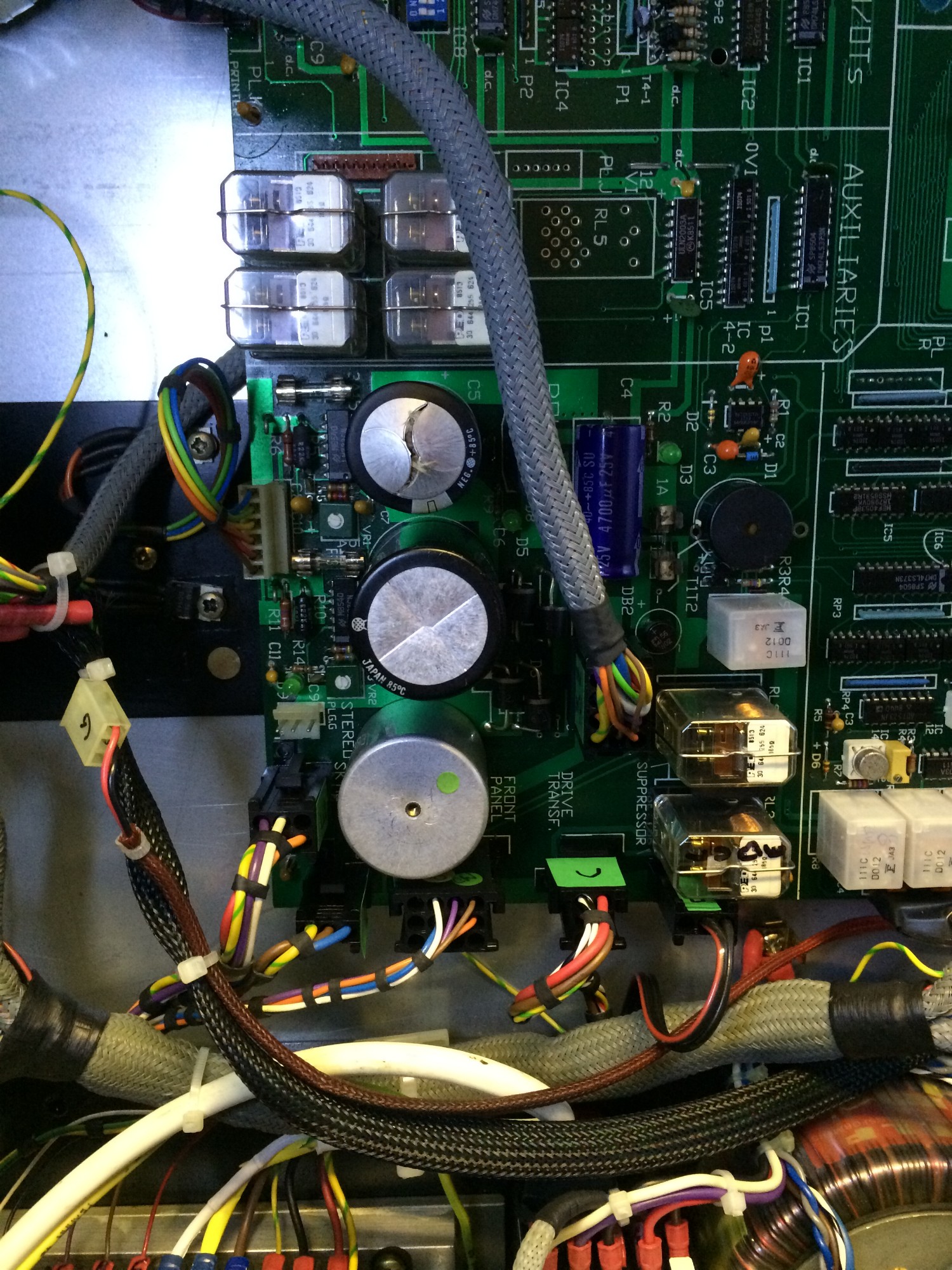

Ok so having some success by not using the stepped down 12v (former stereo) supply and using a standalone supply for the breakout board power.
The fuses were holding out.
However after turning the drives off this morning & then switching them back on, this capacitor has blown. !!!
Whats going on? Is it possible this capacitor was on its way out and causing the fuses to blow?

New capacitor fitted, now back to blowing fuse f3 every now and then??
