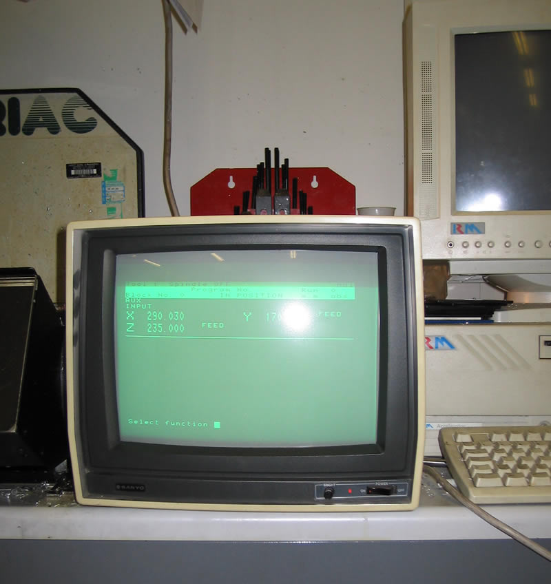

I may have come across a monitor for your Triac. Found one in the stores of one of other depts at work. It looks identical to the one on the Triac so I will try and see if it works. With a bit of persuasion I might be able to get the guys to part with it. Drop me a private message for more details and I can try and take some pics if your interested.

Post by davidimurray » Thu 09 Nov , 2006 0:06 am
Hi Andy
Pic attached. Note that the monitor I have found is A green on green as opposed to a green on black that is on our Triac here. Apart from that the casings, connections etc are identical.

Post by Denford Admin » Thu 09 Nov , 2006 15:04 pm
Yep - we have one marked faulty 1998 - see the classifieds to get it for spares / repair
