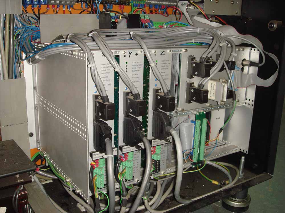

We have an early Triac 200 CNC centre. Inboard rack PC has dongle on parallel port and 3 x BL30 drives. Running Fanucms software.
Recently the Z axis stopped working altogether and the Z axis motor (ML2340 A-10) has been replaced satisfactorily and we are now working again. (Our longterm solution will likely be to change all - from PC to motors)
However ever since the time of installation the machine occasionally and randomly throws up a Y axis following error.
To date this has been dealt with with a workaround involving breaking up code into smaller blocks and resuming machining. Oil pump is working and all lead screws are turn freely. Feed rates are usually low.
We have no information on the BL30 drives and indeed on the whole installation and no spares to swap in and out.
Info from any in the forum would be appreciated.

- Triac 200 Rear view
XYZ BL30 controllers and PC in rack - DSC01268a.jpg (104.47 KiB) Viewed 10211 times

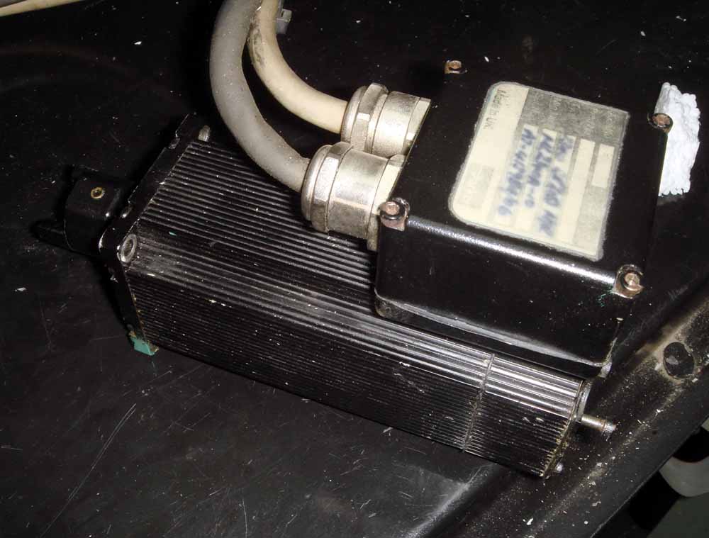

Our machine uses ML 2340 A-10 motors. (2 phase servo with shaft encoder feedback) Photo.
Since my last post I have done the following:
I have been running the Y axis motor (out of its axis) using a function generator input to the user I/O with scope attached to link1 (velocity signal). PC control unplugged.
The function generator was set to produce a 1Hz sine/square/triangle wave of appropriate amplitude to exercise the motor and tweak controls. Sine/triangle wave input produced smooth reversing turning motions whereas square wave produced sharp direction changes allowing damping control to be optimised.
During two exercise sessions of approx 40 mins each the motor was once observed to go into "jittery spasms". These During rotations these jitters appeared to pause the motor momentarily in a certain positions with extra noises. Without stopping the exercise session these jitters stopped without any intervention after a minute or so.
My conclusion is that such irregularity would be instantly interpreted as a following error with the drive under fanuc software control.
When the machine was installed a following error problem was apparant and a motor was exchanged but the drive board not. Apparantly the problem was cured temporarily, but the symptom returned and we have been dealing with a intermittant following error since.
Next; I will remove the Z axis motor and plug it in to the Y drive and see if the problem feature still remains.
If so I could do with a spare BL30 to swap in and test.
Not sure about the effect of Tach Gain control adjustment. The User Guide says this sets the Velocity Amp sensitivity and results in adjustment of the speed of the motor for a given input voltage.
However it would seems that the encoders must have the final say about speed and position.
Comments appreciated.
Peter Watt

- ML 2340 A-10 Servo motor with integral encoder
- DSC01279a.jpg (82.98 KiB) Viewed 10176 times

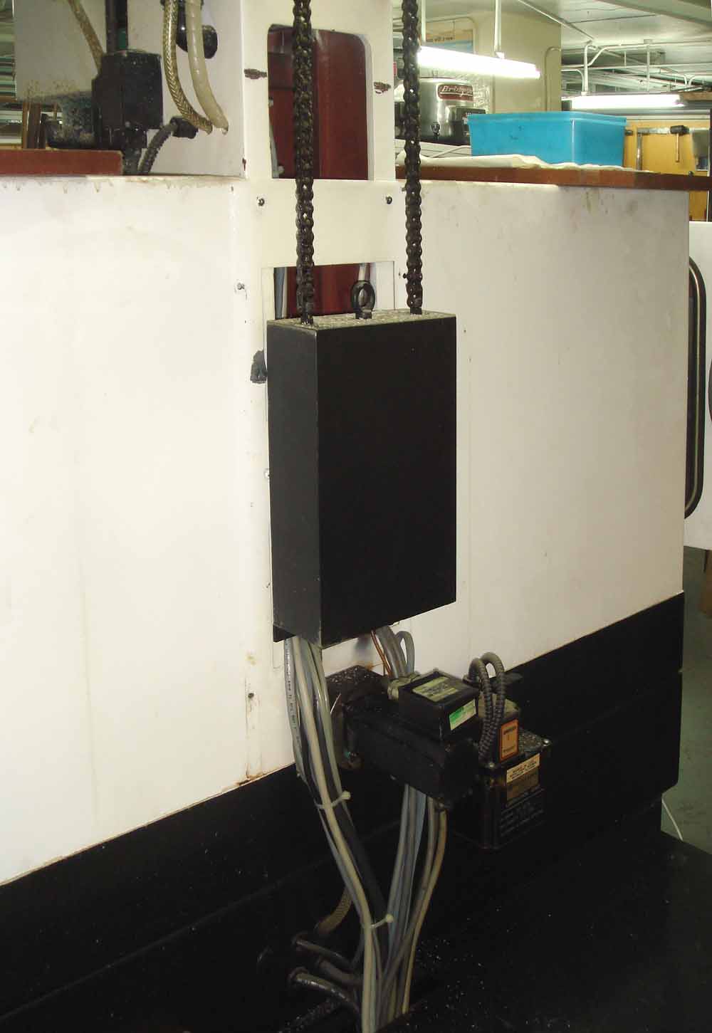

Our Z axis has the counterbalance and all three motors are the same. Photo.
Z of course is new.

- Z axis with counterbalance
- DSC01271a.jpg (75.2 KiB) Viewed 10172 times

Re: Triac 200 Y axis following error
Apologies if this is getting tedious...
Have removed PC front panels (with stuffed ribbons behind) and comms timeout error disappears.
Run FANUCMS.exe successfully.
HOMEing axes (no faults) produces: X = 000.038 Y = 169.995 and Z = 299.038. I am informed these are normal values.
When HOMEing axes (with a fault) X will not go home but produces an unresettable "following error" and the X value now displays 300.000.
In this condition the lead screw can be hand turned and with each RESET press, the X values change from 300.000 up or down.
So a spurious offset is being generated.
When HOMEing axes has completed OK and the AUTO / JOG screens are used a "following error" can be produced whenever any axis is jogged and an X value of 300.000 is then displayed.
Currently now looking at hardware integrity of BL30 X axis driver board. Should I be looking at X axis encoder output?
On BL30 I see motor feedback lines running up to PL9 (20 way). Are these testpoint lines?
Comment sought. Maybe a BL30 schematic?
Thanks for any pointer.
