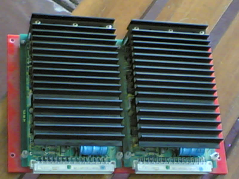

We have acquired a starturn cnc machine in the year 1990's but we have not used the said machine because there were no software and manual included.
In line with this we would like to request your good office to download the starturn 8 software and manual. So we can use this machine for instructional purposes in our school.

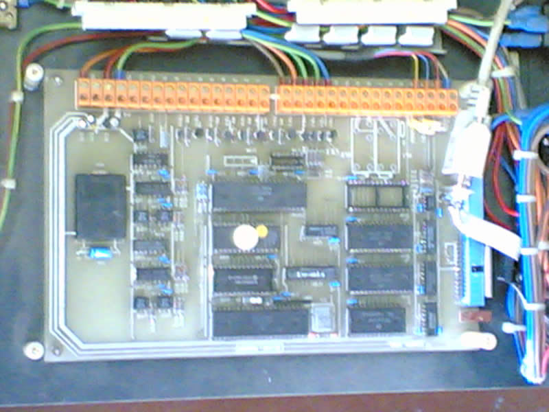

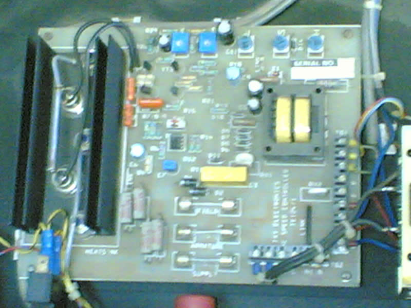

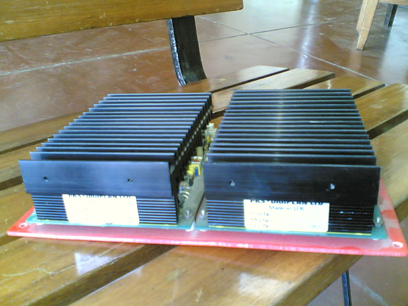

Would like to know the functions of the following parts dc speed controllers, slave board, and bus board. i would also like to know if the RS 232 serial link can be change to universal serial link.
Hoping for your kind consideration.

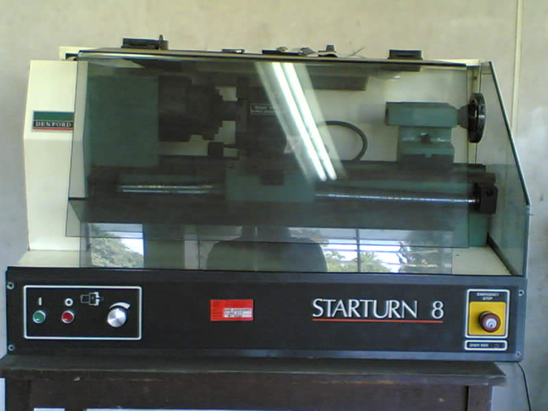

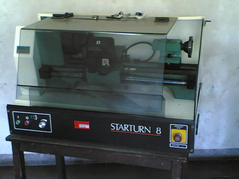

If you could attach a photo of the machine and the electronics, we may be able to help find more information
You would never get the machine working with USB as it is - you would have to retrofit it with some new CNC controller and PC software

help!
Post by nickyjones2 » Thu 10 May , 2007 3:57 am
i hope you can help me run these machine for educational purpose.
thanks
nickyjones
Post by Denford Admin » Thu 10 May , 2007 9:48 am
We can do our best, but I'm afraid we can't just wave a magic wand and get your machines working :!:
We can no longer officially support this age of machine - most of us here have never seen a Starturn 8, let alone used one.
We can help with general advice and how other forum users have upgraded their machines to use windows based software, you really need to investigate the best way to get them working for yourself.
