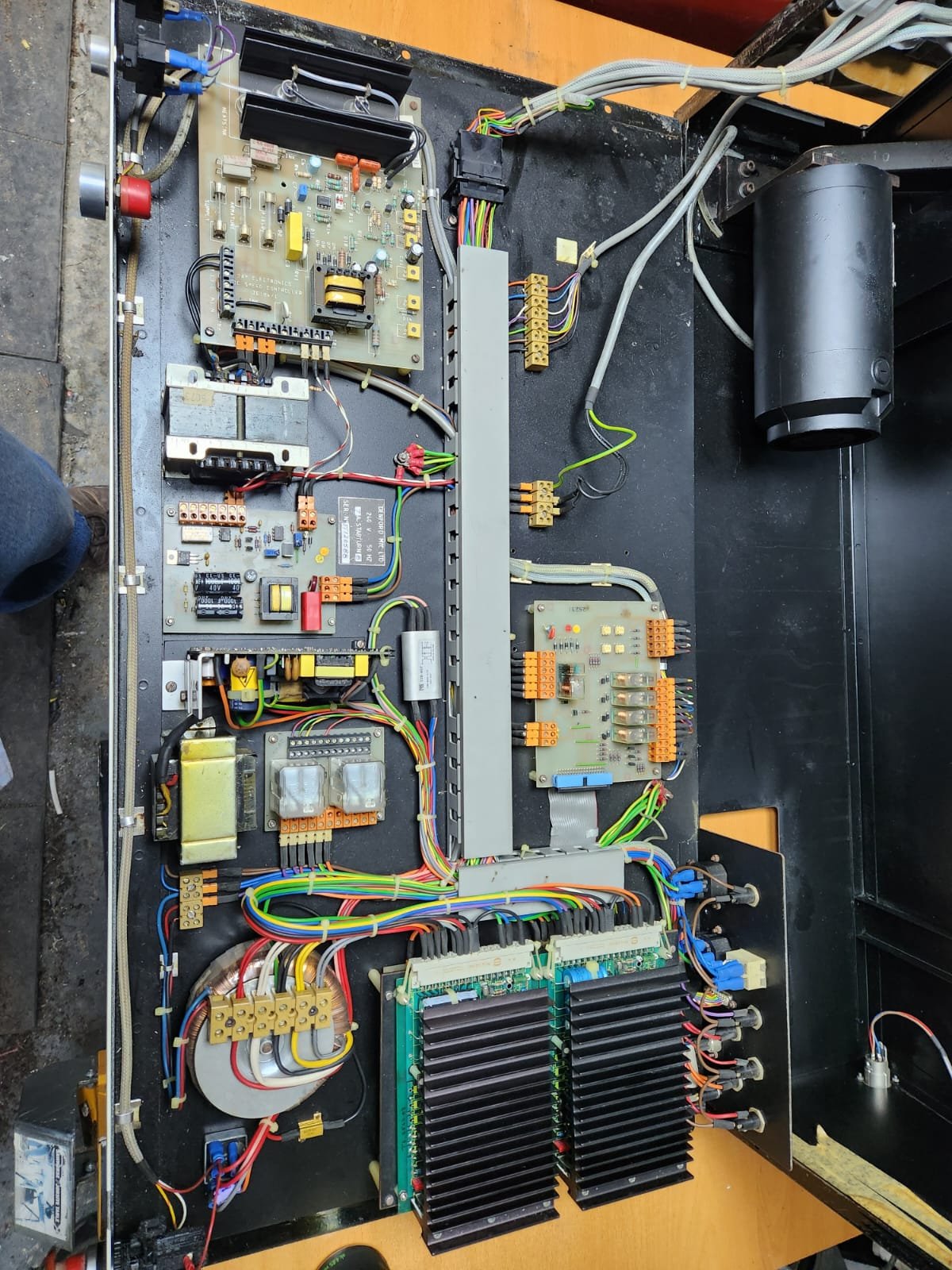

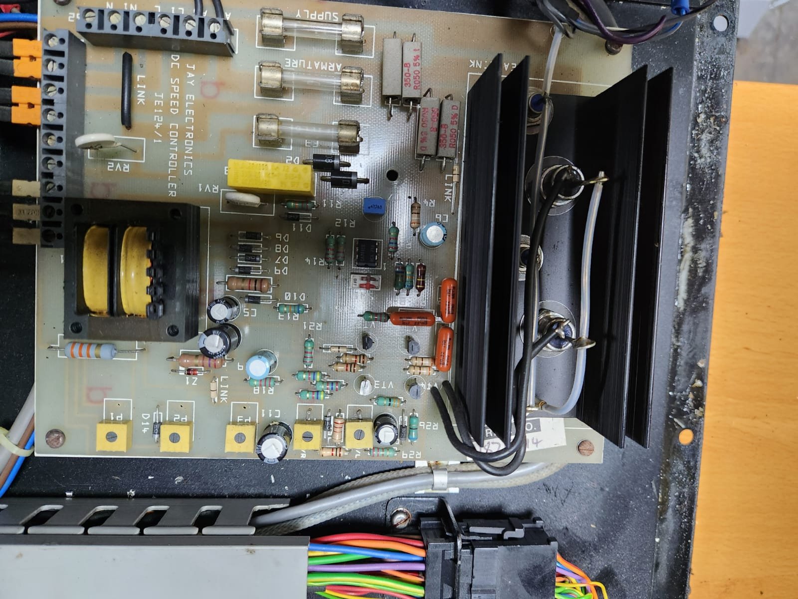

I don't actually know the ST8, post some pics up of the machine and control boards. My ST5 is very close to the novaturn in spec, just a lower speed/power spindle and old control.

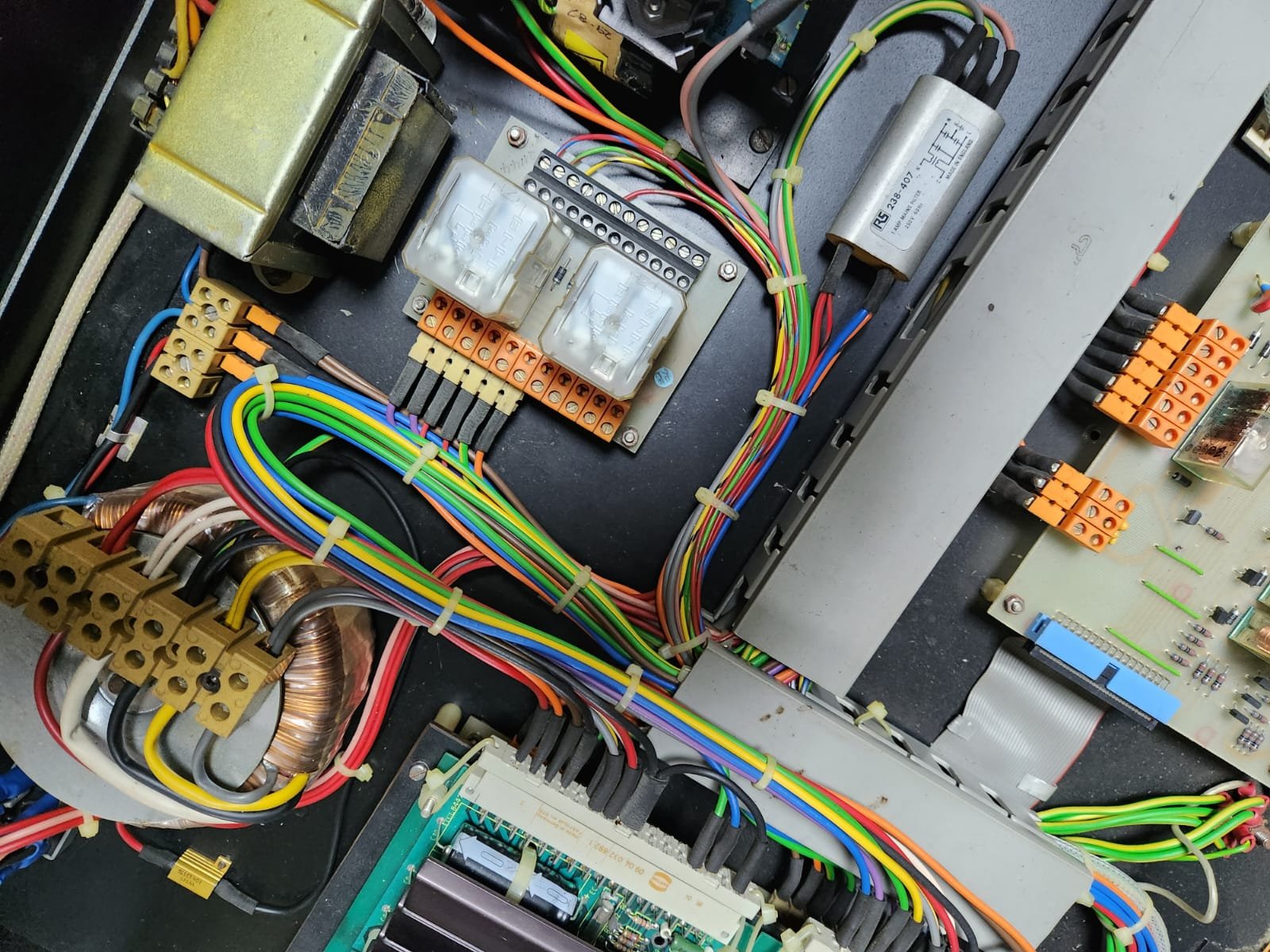

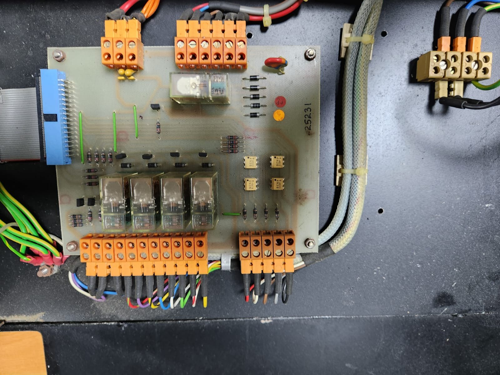

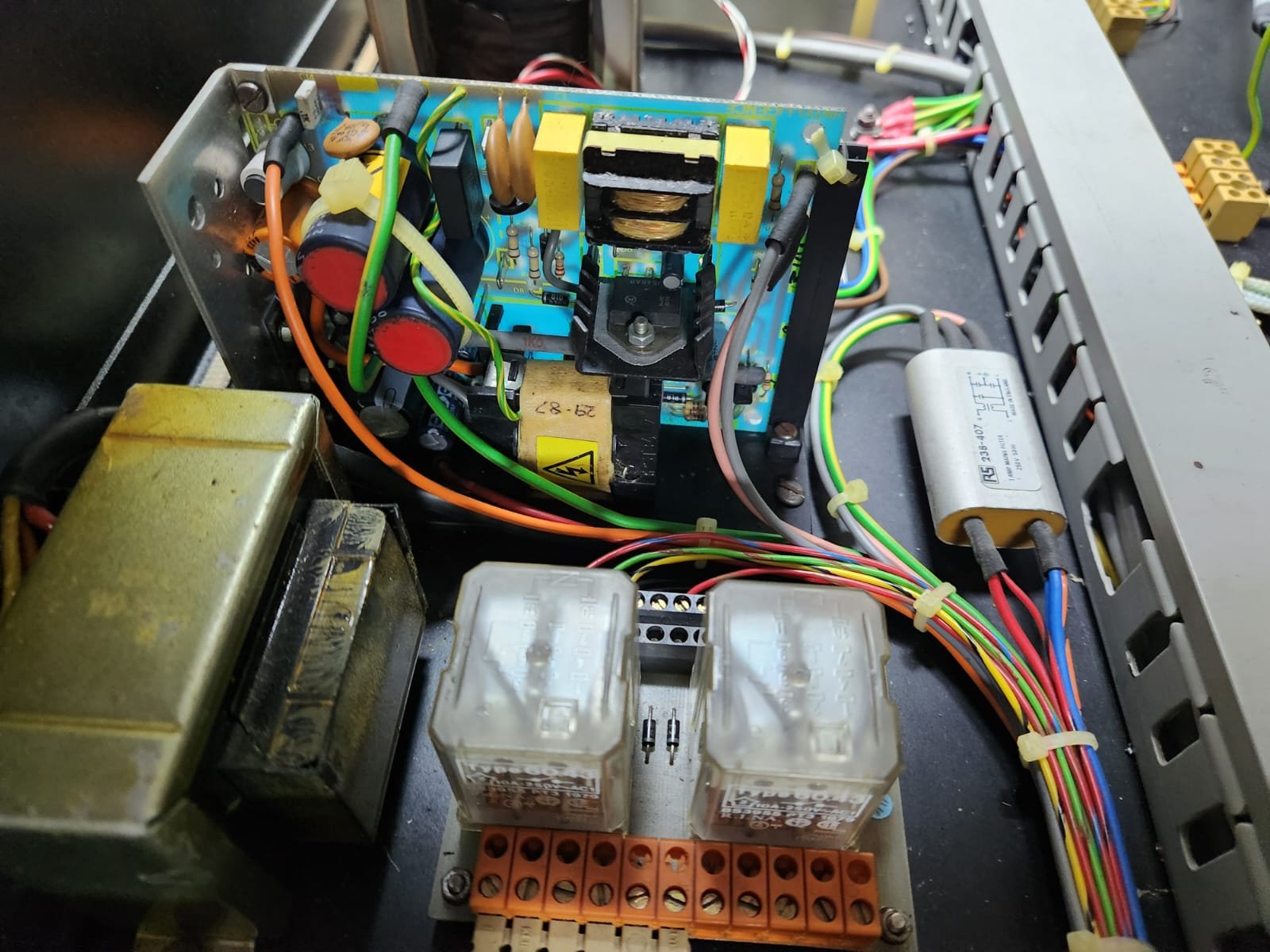

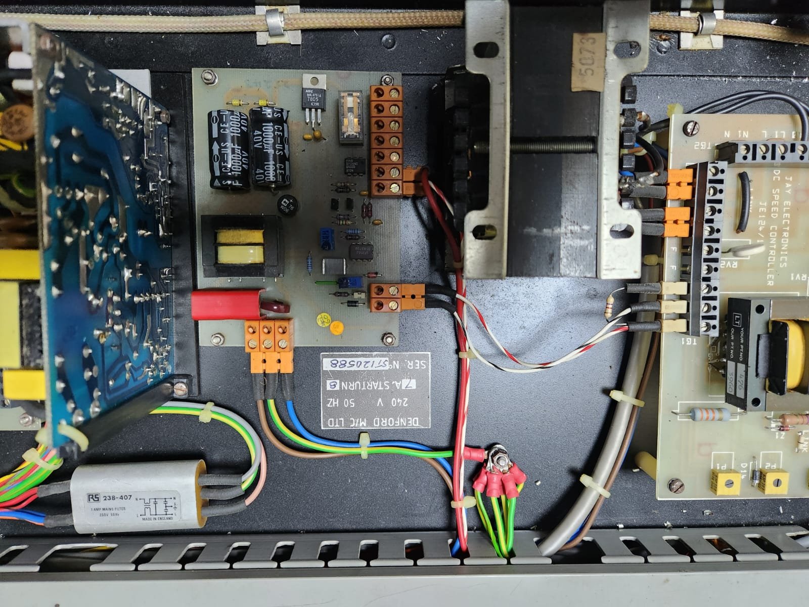

Let me figure out posting pics and i will. I snapped a few while I was in cleaning but i think the control board is hiding under the axis drivers
opentoideas
Posts: 33
Joined: Sun 15 Mar , 2020 3:03 am
Re: New to me Starturn 8 what to do?
Post by opentoideas » Sun 09 Oct , 2022 0:53 am
old Denford electronics
electronics tray.jpeg (373.17 KiB) Viewed 58280 times
Spindle driver.jpeg (302.56 KiB) Viewed 58280 times
relay board.jpeg (292.98 KiB) Viewed 58280 times

Post by opentoideas » Sun 09 Oct , 2022 0:56 am
have to just give credit to Denford for a great layout and machine design.
dropping out the electronics was a simple and easy task. the machine was designed by an engineer that's for sure.
far more used to the norm where you open up a machine and still struggle to get to anything you need.
