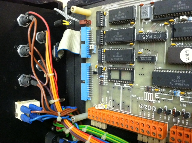

I think that 9way to ribbon is probably RS232 comms to the old GSM controller board.
That controller board will be useless to you once the new BOB is fitted - whatever commands or data it takes is unknown to us.
All you have to do really is find the step+direction wires to the drives and wire them to the BOB then wire the BOB up to the PC via ribbon / 25 way cable

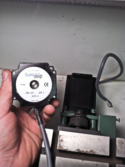

Sadly the steppers on the machine were dead. The X axis was missing a lead (not sure why...?) and the Z just did not work. I tried with 2 different drivers and got no response. Thankfully the spindle motor still works.
I got new motors from automationdirect.com. For the Z axis I used a 166oz stepper (that's all that would fit in the cabinet), and I used a little larger stepper for the X because there was room for it, at 276oz.

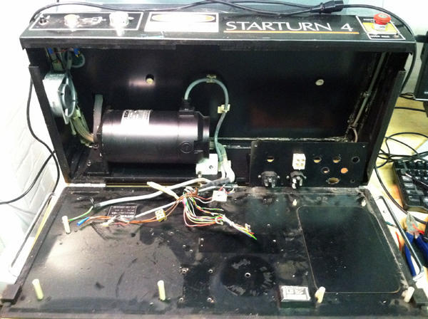

- I ripped out the rat's nest inside and got a fresh start. It looked like this:
- IMG_0441.jpg (258.91 KiB) Viewed 35692 times

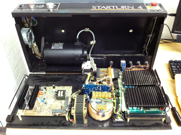

- ...and then this! Ah, much better now!
- IMG_0455.jpg (244.6 KiB) Viewed 35692 times

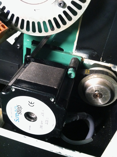

- Bolted on the X axis stepper...
- IMG_0461.jpg (160.66 KiB) Viewed 35692 times
- then the Z axis.
- IMG_0463.jpg (178.21 KiB) Viewed 35692 times

For someone claiming to be unskilled at wiring, that 2nd photo looks pretty daunting
At the end of the day those old 'rats nests' were far too complicated IMO - too many different transformers, voltages, converters and logic boards for what is basically two steppers and a spindle motor.
