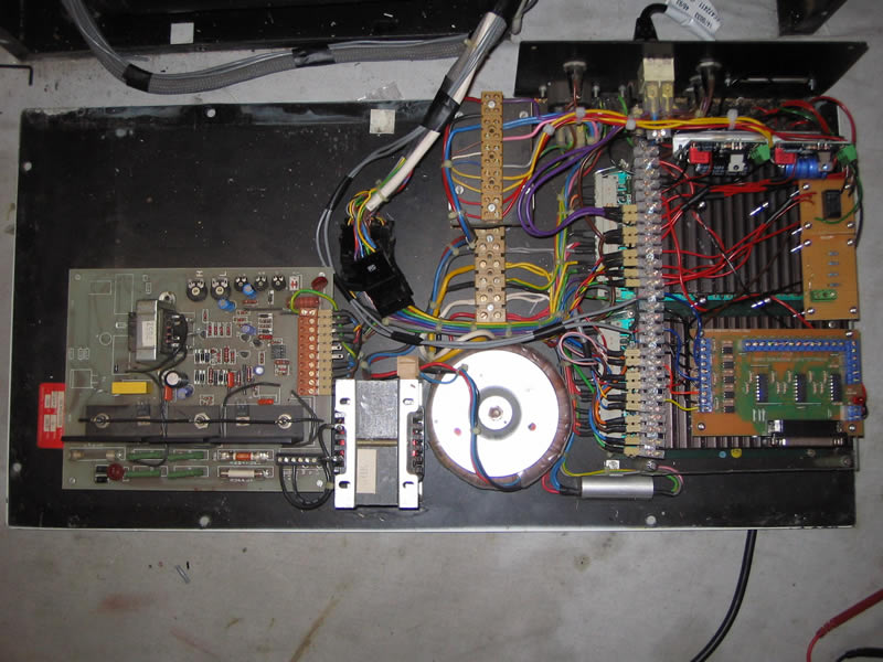

I've been through all the schematics I can find on the site and nothing seems to match, but inside the machine is identical to this one:
download/file.php?id=104
... it would save many hours of wire tracing if someone could point me at a diagram.
The spindle drive now works after a bit of fiddling-about but the X/Y drives are missing so I need to buy some drives, an interface for the spindle controller and a BoB.
I see that someone put an auto/manual switch on the spindle control - what's the advantage of this?

It looks similar to the Starturn 8 documents I uploaded last year.
Even those didn't fully match the actual machine
You've got SD2 or SD3 drives by the looks of it, so search the forum for those manuals (made by Parker)
The spindle drive is possibly Jay electronics which I've never found any info about.
However, from the diagrams I uploaded, you can work out what all the terminals do as other drives were similar.
HTH
