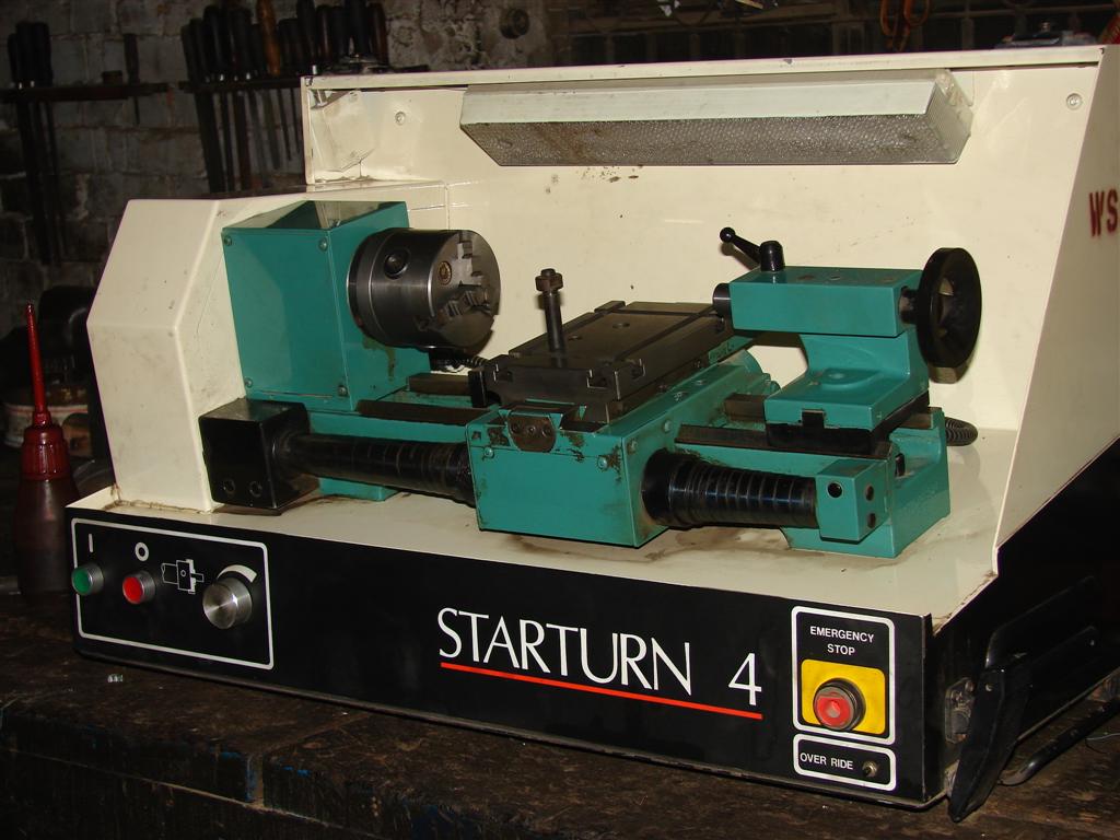

Dear Denford Admin!

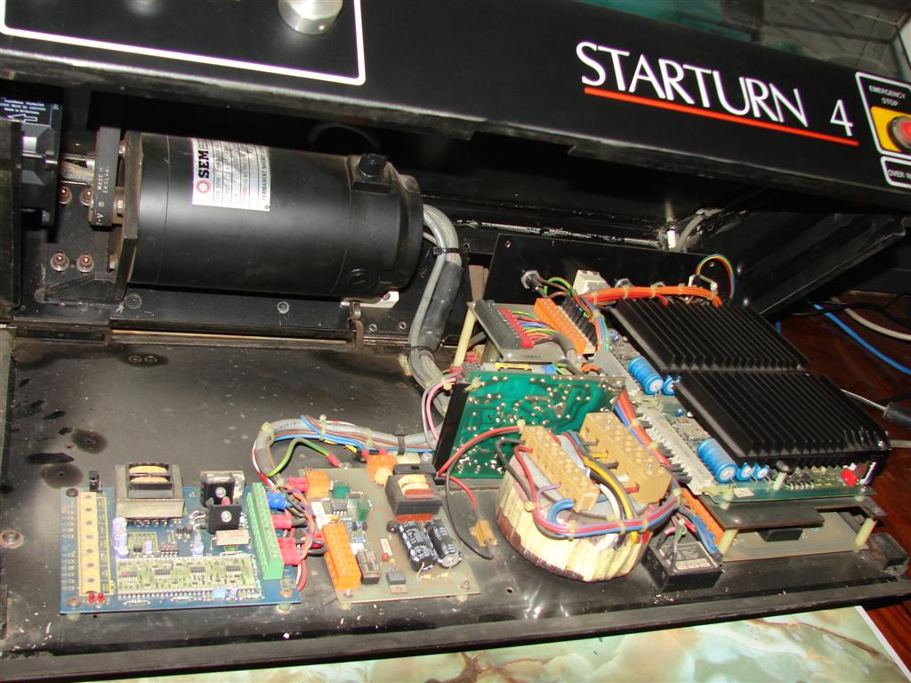

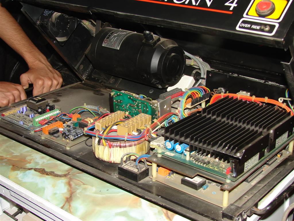

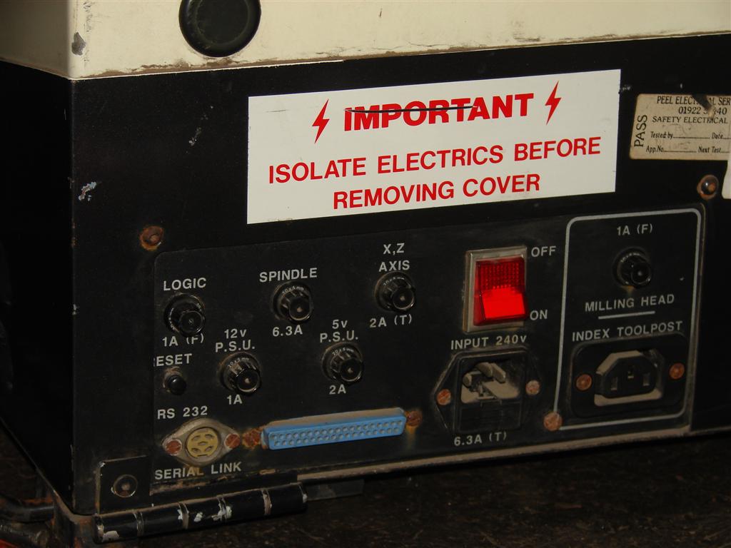

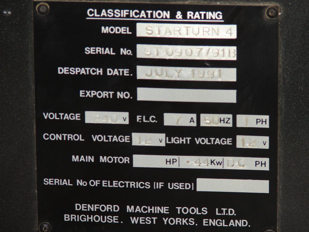

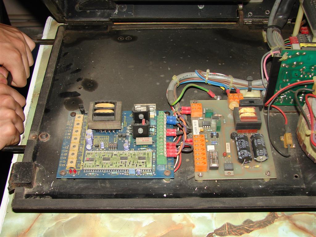

Attached are the images of my STARTURN 4 as per your instruction.Your good self is requested to resolve my problem at your earliest.I can also provide images of the circuit inside the machine if you require.

Re: Need drivers for a Denford Starturn 4
Post by Denford Admin » Thu 05 May , 2011 9:13 am
I'm 90% certain this machine was controlled by an IBM PC or BBC micro.
Your only hope is that the electronic control card is one of the first LCB 3 boards and this may then run from fanucsld
If it's earlier than that then we don't have the old IBM or BBC software
In that case, you will need to retrofit with newer software like this:
viewtopic.php?f=46&t=452

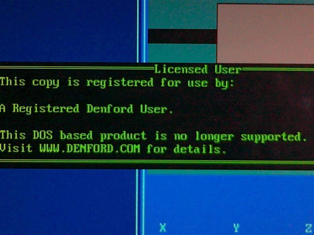

Post by Denford Admin » Fri 13 May , 2011 8:28 am
Can you post a photo of the screen message ?
This DOS product is not supported does not seem like a message from our old software - ie, how would it know it's no longer supported ?
Post by Denford Admin » Fri 13 May , 2011 13:02 pm
Sorry I didn't see you'd already posted a screenshot !
I'm sorry for not noticing this earlier - the message shown is what is in the flash code:
"A Registered Denford User. This DOS based product is no longer supported. Visit WWW.DENFORD.COM for details." is the user name in fanucm.opt
So, the software is saying it's OK and registered to "A Registered Denford User" - can't you press a key (eg escape or enter) to continue using the software ?

I think the stepper drives you already have will work well -
Very basically, you just need to get a breakout board (BOB) for Mach and connect up the step+direction pins on the drives and the home switches from the machine.
