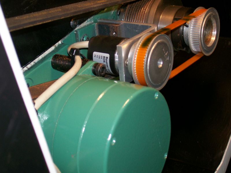

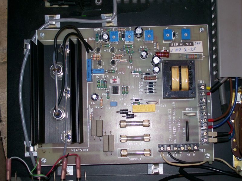

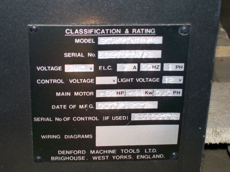

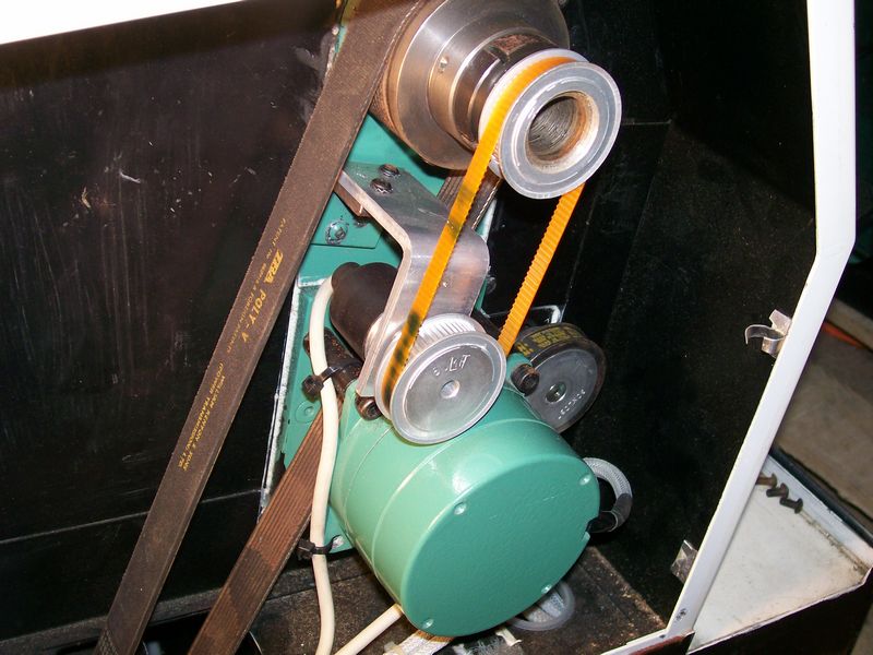

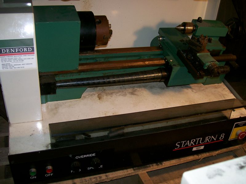

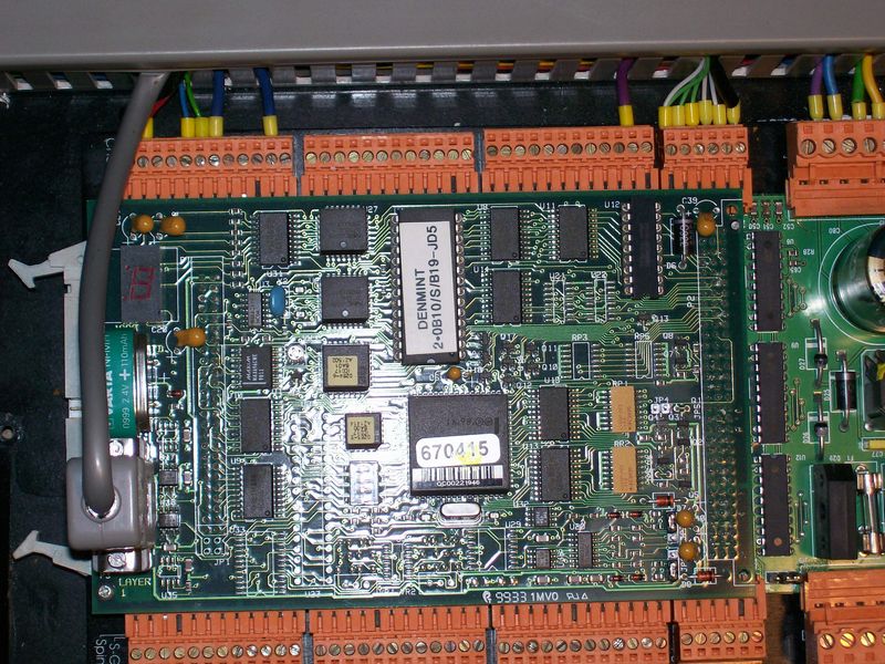

I have a Starturn 8 and was wondering what software I need for it? I dont have the Denford tutor and need help trying to get the machine to work without it. Thanks.

Because you have an optimised smartstep control card, I guess you're looking to be using Fanucl (or similar)
