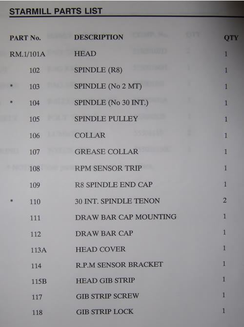

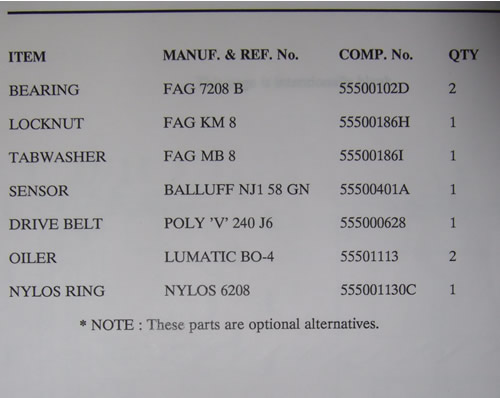

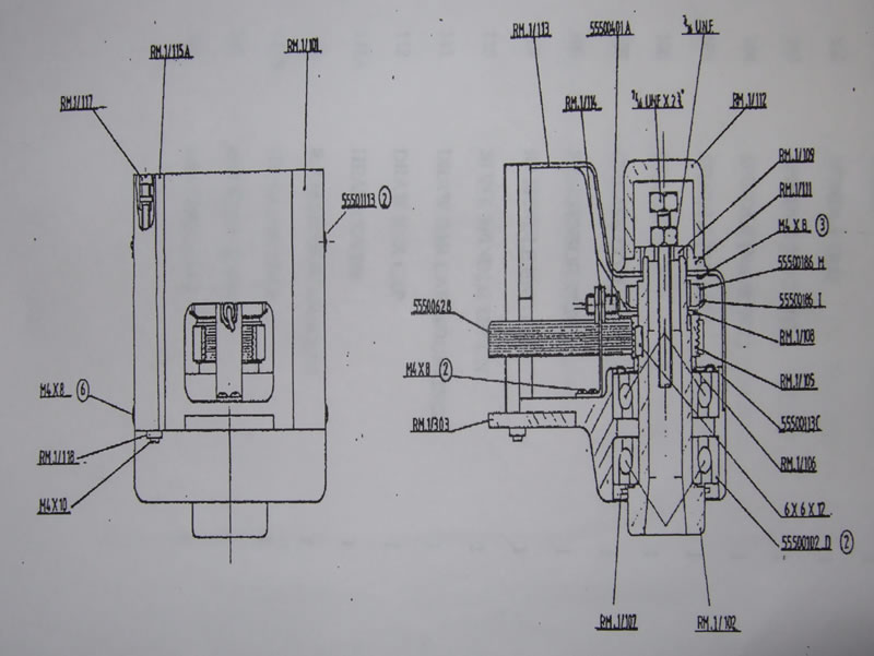

Hello does anyone know what the spindle bearing model is on the Denford Starmill, I know it is made by THK but without dissmantling I am not sure of the part number?
TIA
SRG
Post by Denford Admin » Fri 02 Feb , 2007 14:09 pm
These drawings may help...
The Novamill which is the successor to the Starmill uses the same bearing, and our notes say to use SKF 7208B only
