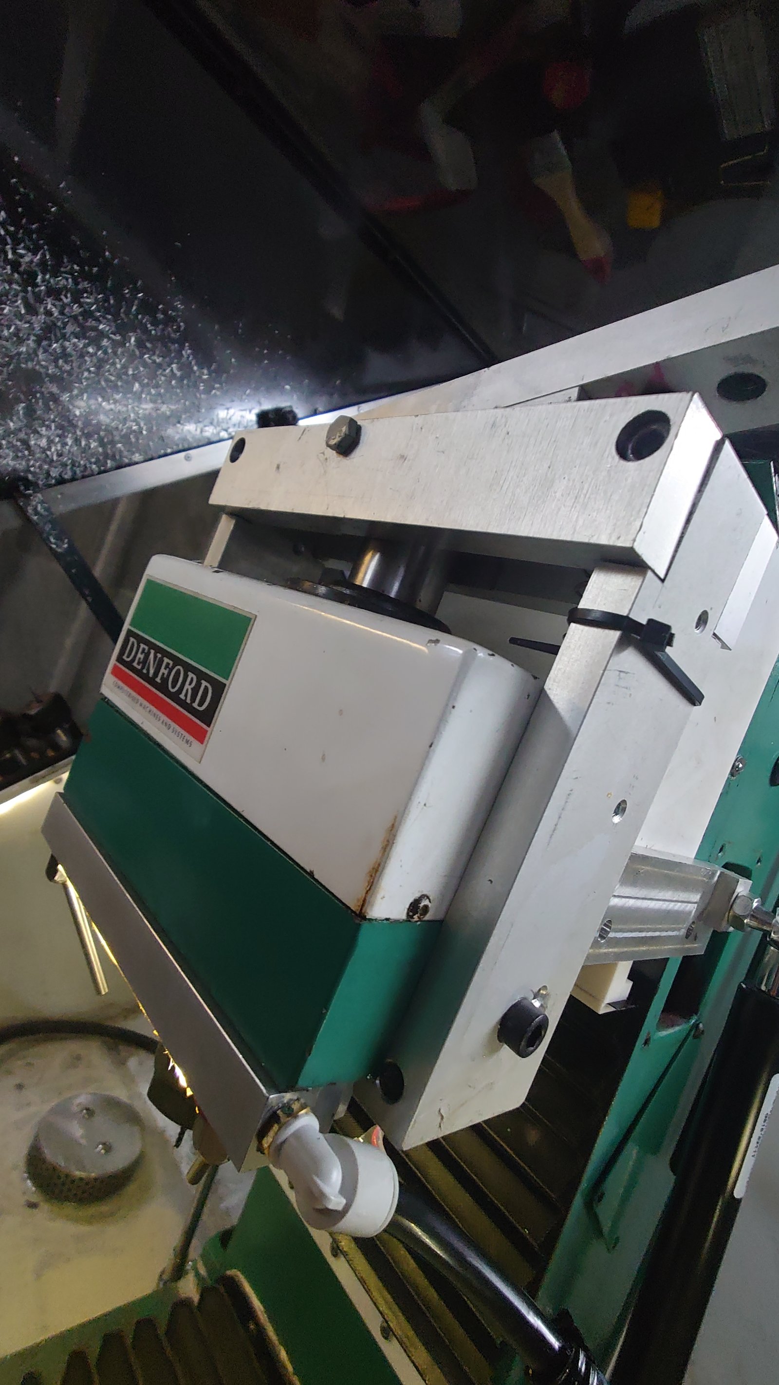

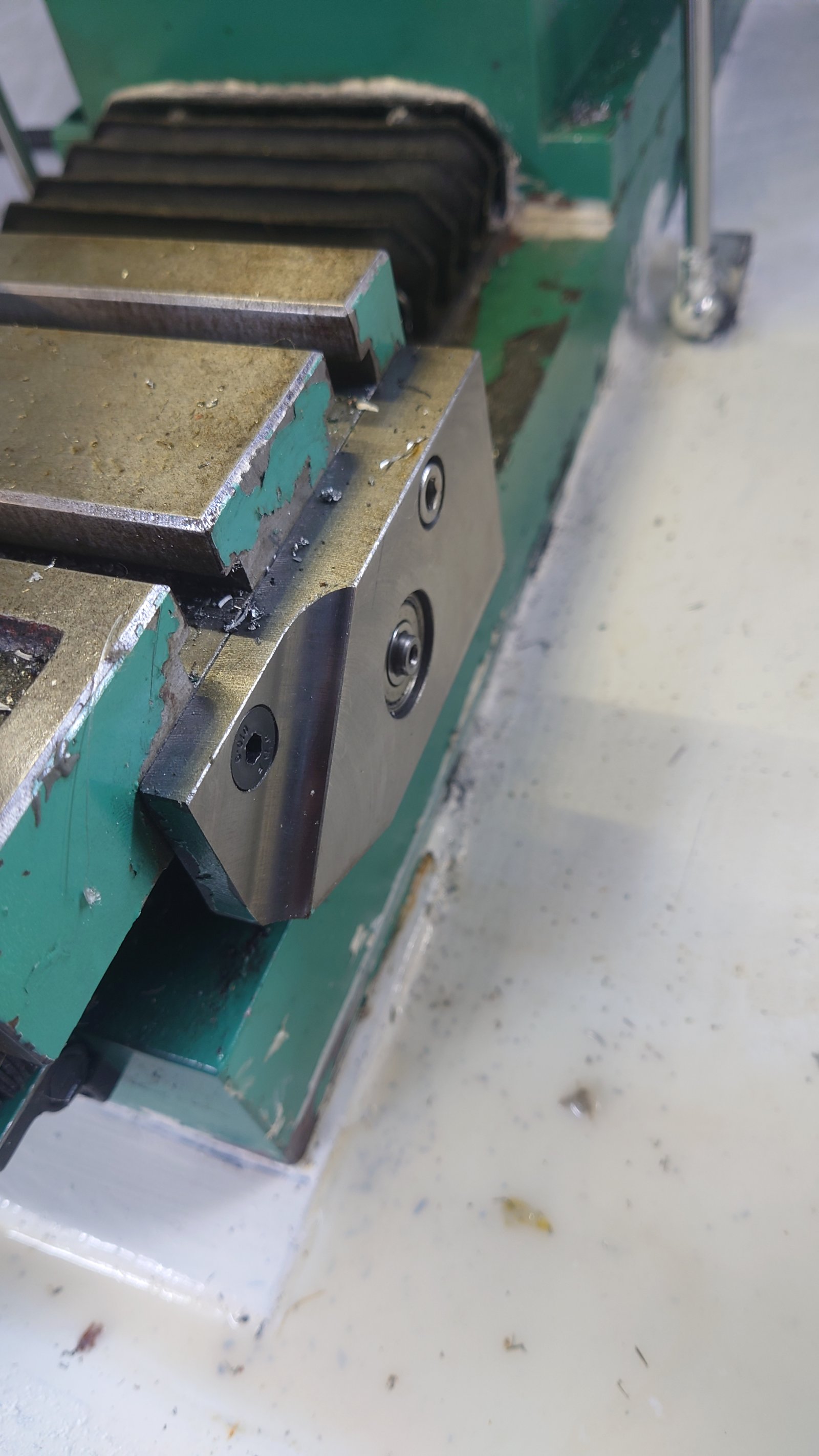

The starmill is stated to have 170x100mm table travel. I had to replace my stepper motor on the x and lost 5mm. Since then I have machined down the end bearing block down by 10mm to get to 175 once the block no longer interfered with the case I made a new plate to hold the y home switch. That gained me 10mm on the y travel. I have also made a lever action TTS tool changer system which is working well.

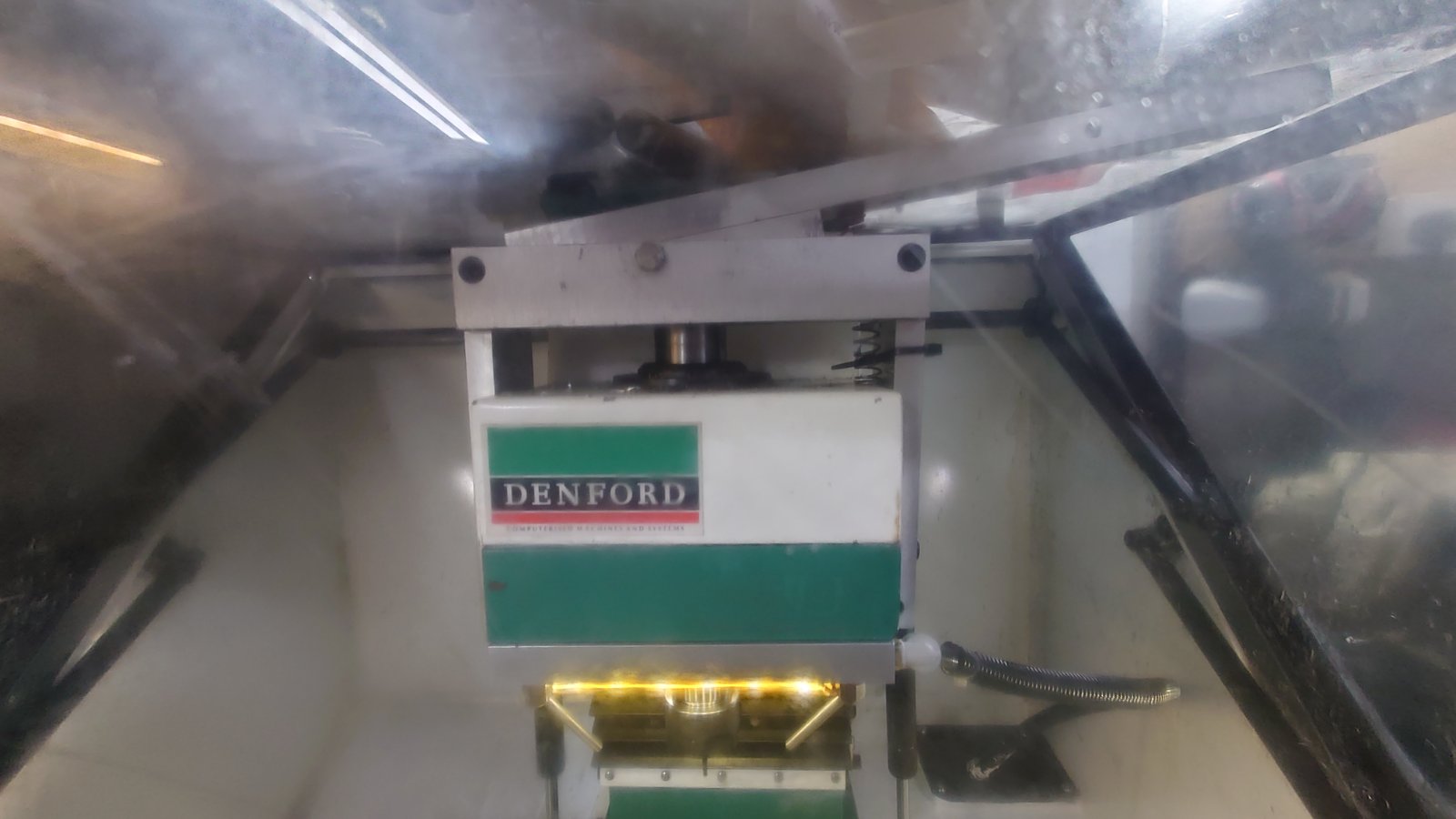

I don't have any drawings but I'll upload a few pictures shortly. It's basically a frame with a lever and a few belville washers. Because the machines so low powered I have got away with less spring pressure than they would normally have for tts. Also allows me to put direct pressure on the bearings though I admit it isn't the ideal. I will be upgrading it to be pneumatic or hydraulic in the near future.

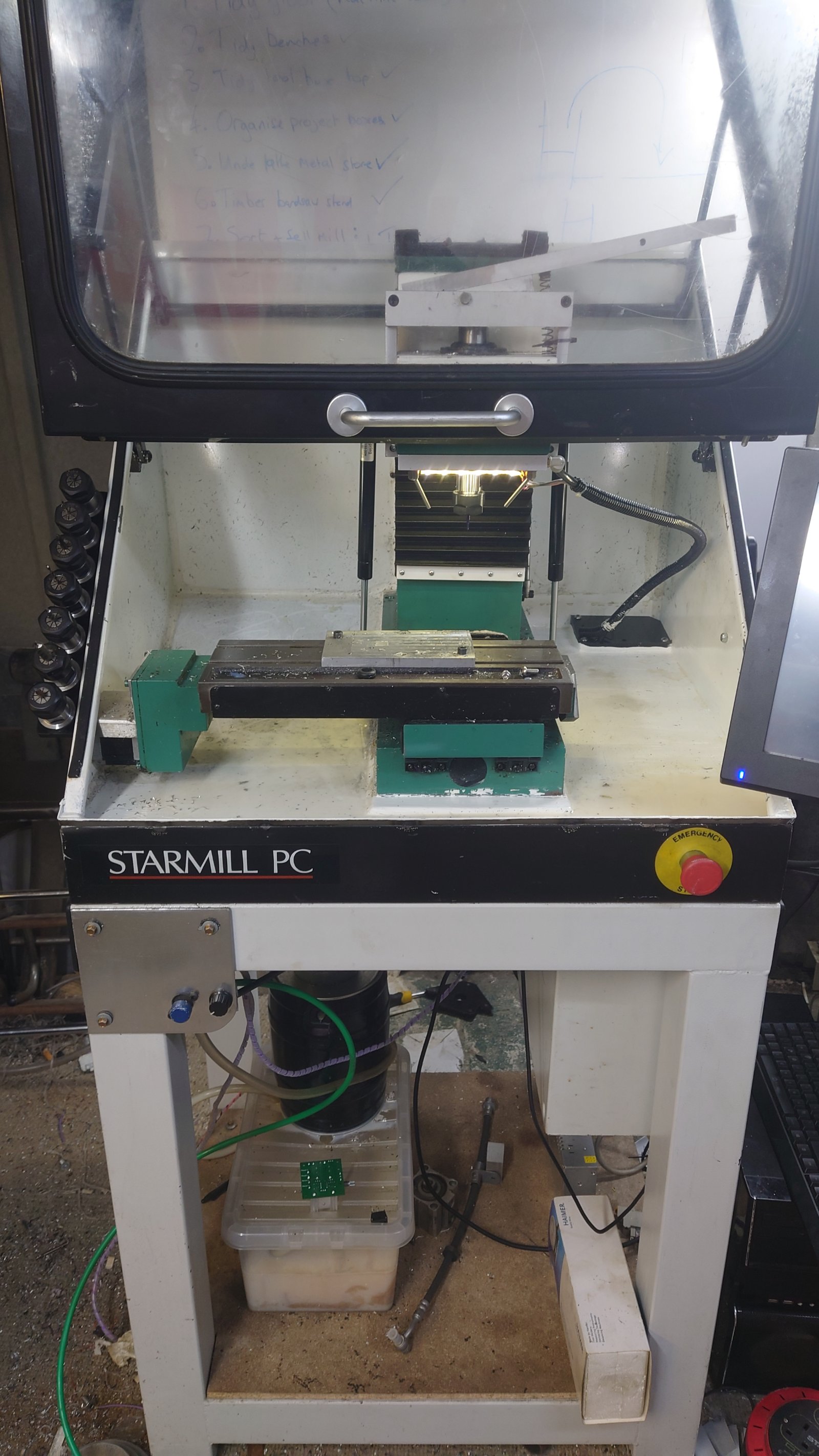

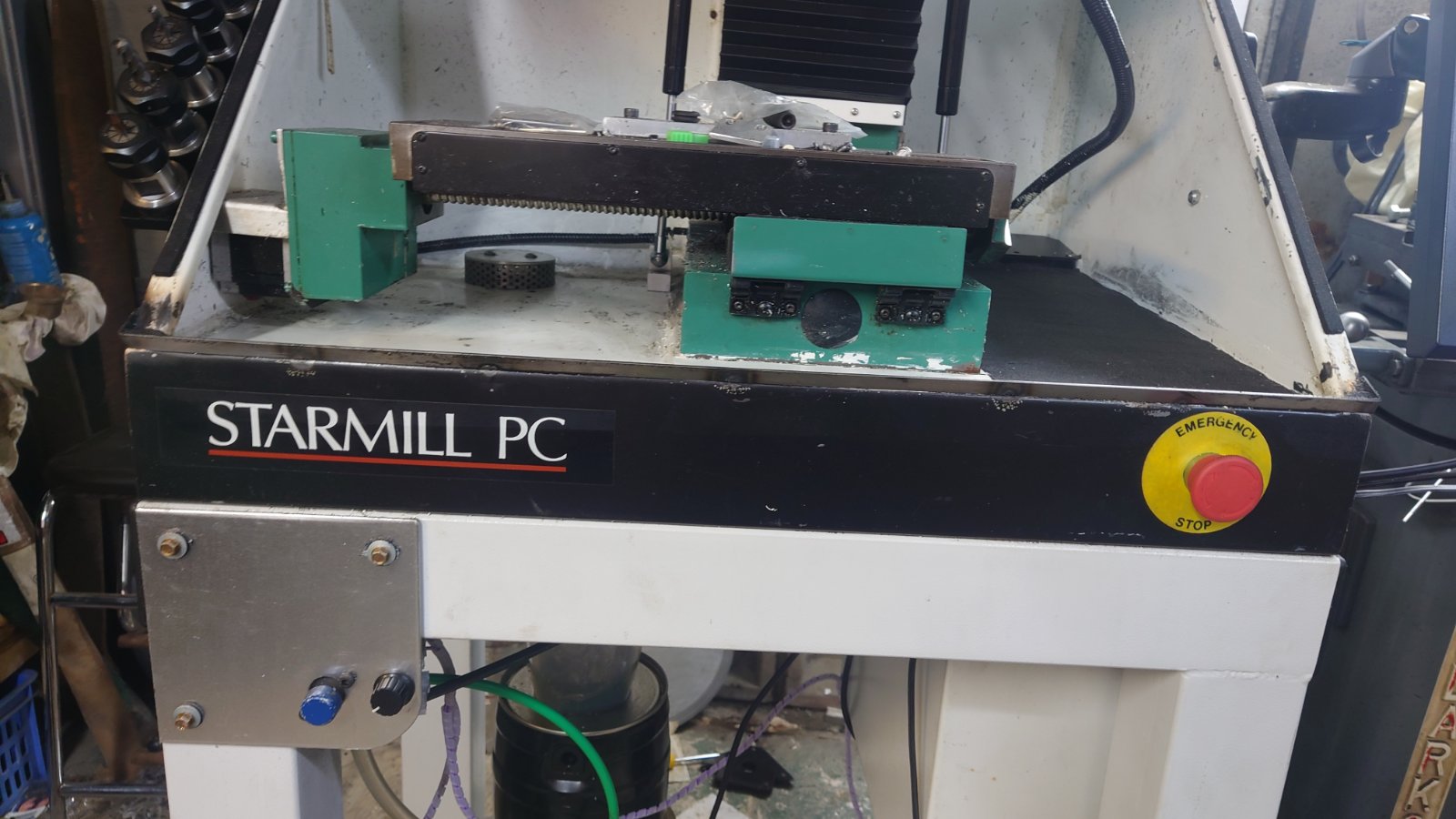

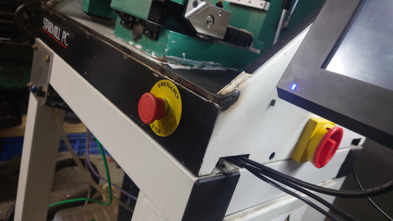

Here's the mill finally.
A lot of the upgrades not visible.
Running UCCNC with a touch screen interface.
5500rpm dc spindle 0.55kW with index sensor added and a sprint 800 drive.

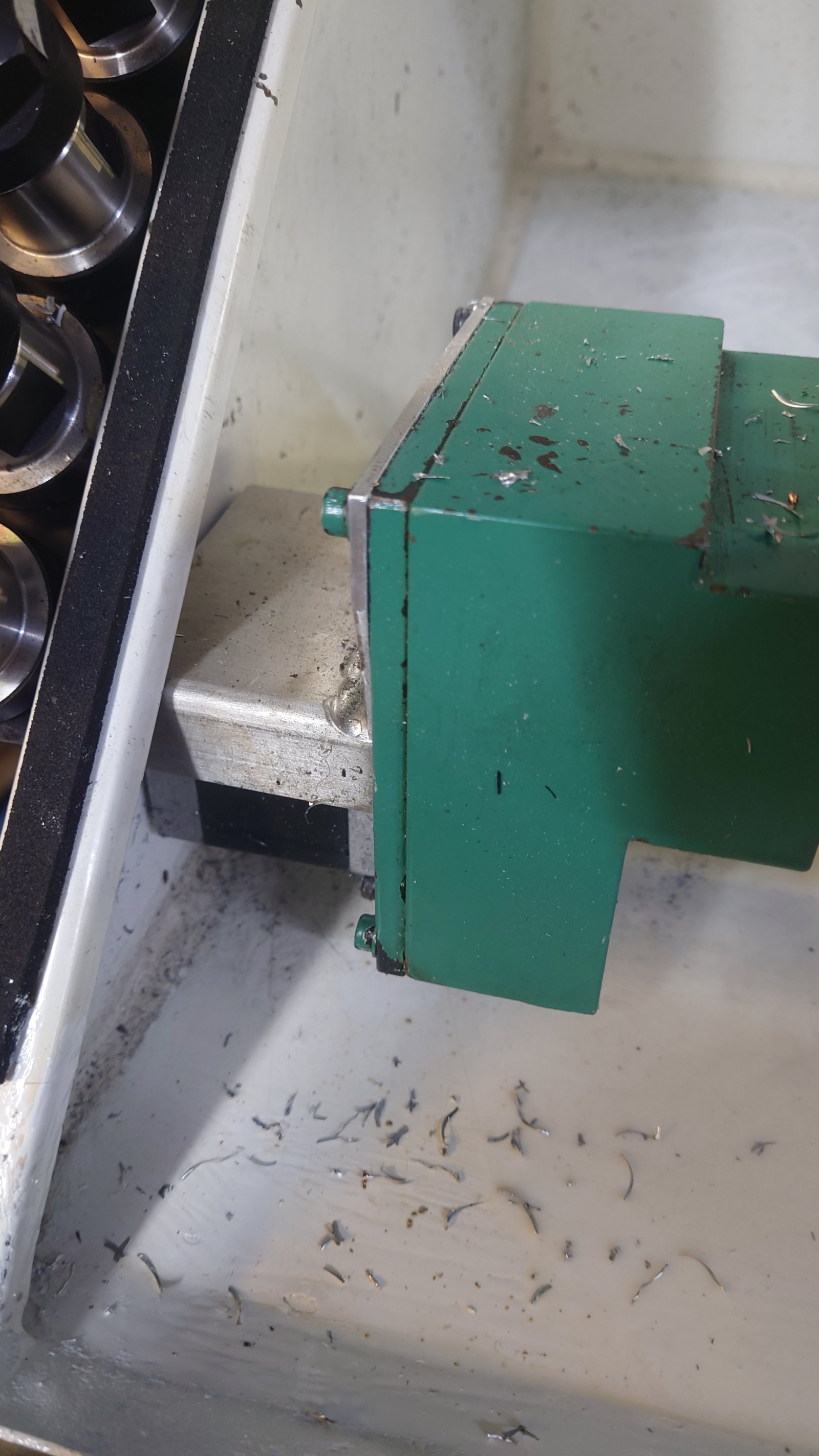

x and y steppers replaced with 400 step per rev units. X stepper has a coolant sheild (that's what killed the last one. A lot of material removed from x bearing block to extend the travel, y limit moved to extend travel by about 15mm. Gives me a total movement of 175-110. Currently running 24v.

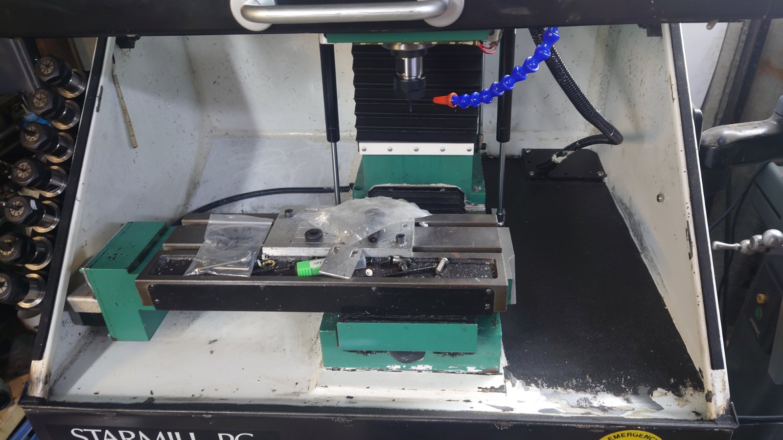

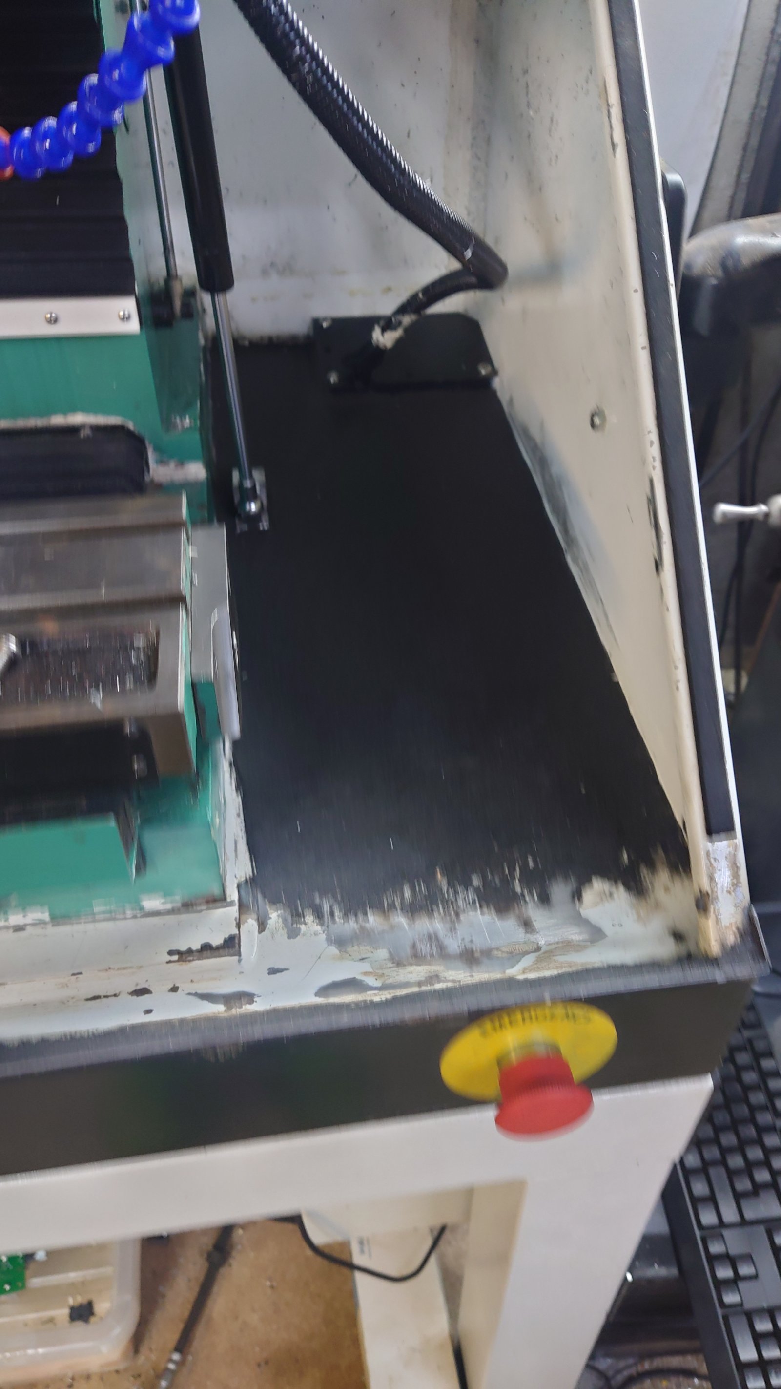

Flood coolant system added (a lot of sealing was necessary. Including the epoxy granite ramps and extentions to the front to make the tray deeper. Flood coolant tank is in process
Led strips added to see what's going on.

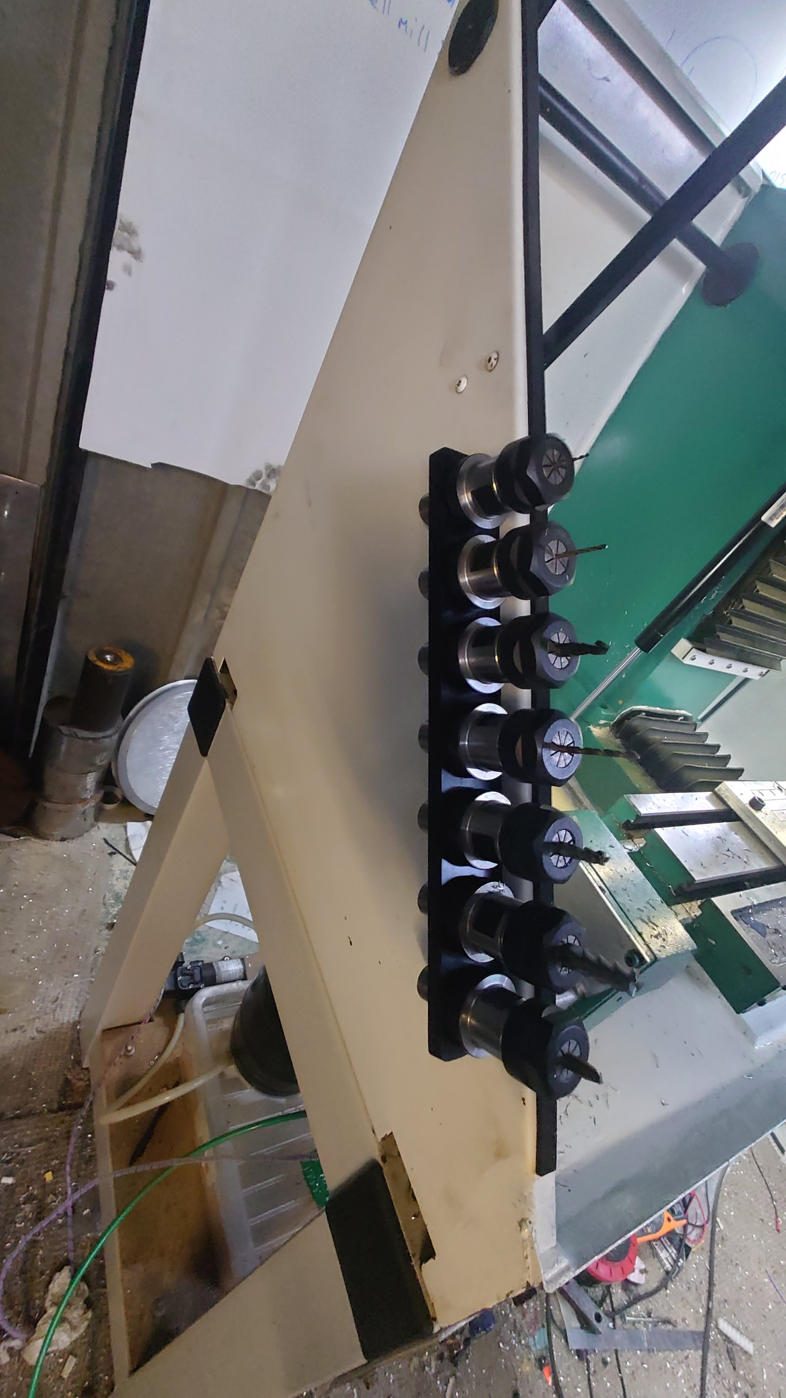

TTS lever system added and works well, with side tool rack.
Base frame is 80mm x 3mm box section with the machine bolted down.
Z axis gas spring assist 5kg each.
Mods remaining:
Fill machine base with epoxy granite.
Fill frame legs with concrete and add retractable castors with anti vibration feet
Replacement control cab running 48v and a second input output board.
Probe input
Spindle encoder
Possibly convert to bt30 to match triac
Air blast
Windscreen wiper?
Riser block
Upgrade drawbar to pneumatic/hydraulic
Possible toolchange carousel.
Stepper encoders
Replace Z stepper
