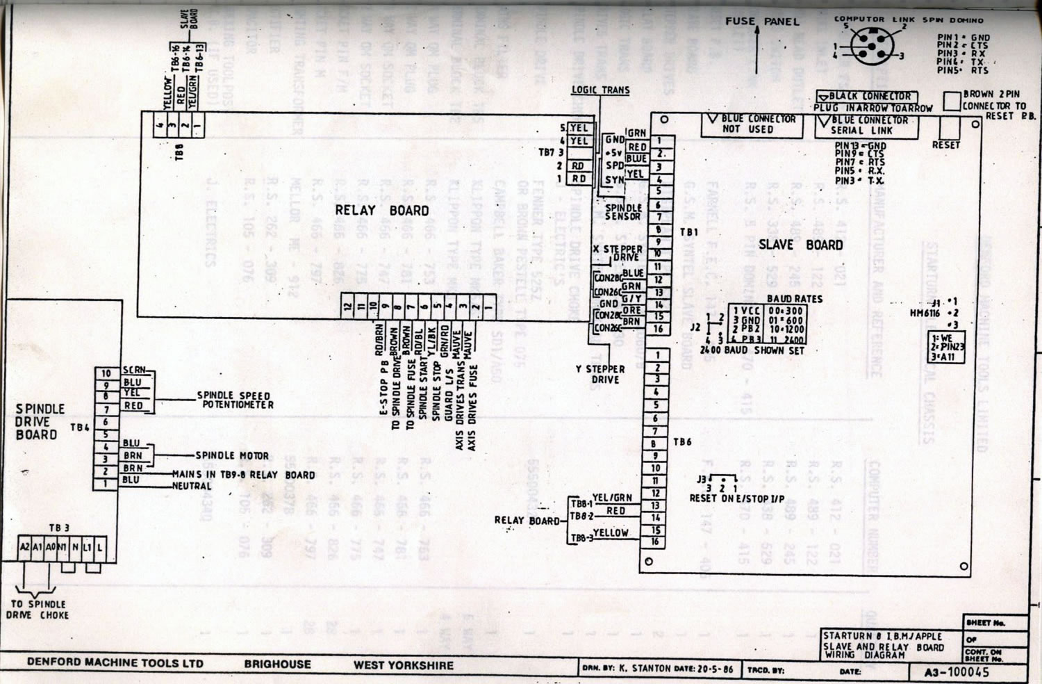

Ive got the later board (GSM LCB3) which has the 25pin RS232 on the case (9 pin on the PC) I found through looking at the various wiring diagrams some changes were made at various points (the wiring on the board itself to the case was changed with quite different pinout being written on the drawing in pen!
I needed to have RTS to RTS, CTS to CTS wired direct (I wasn't sure if they needed to cross like TX/RX do/Don't depending on how the cabinet is wired). But I dug through some of my old information from the days when I worked with RS232 and found these lines don't get crossed.
I also found digging through the info on other machines I was able to gleam more info.. The same boards were used in Mills and Lathes so sometimes notes have been written on the manuals that isn't on the drawings for your own.

I have this I got from somewhere on the site, it might help.
- Starturn RS232 and Relay Board Dwg.jpg (246.37 KiB) Viewed 18326 times
