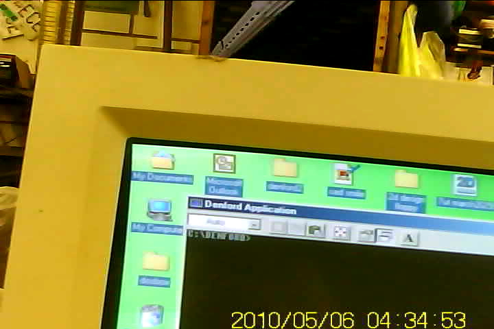

So I opened the Fanuc software on its own, it opens with the prompt c:\denford>
What do I type after that?
I have tried DATA\ABC.FNC where abc.fnc was the design saved as g-code.
And it says bad command.

(1) The Fanuc Milling (Dos?) programme that is waiting for me to type the magic command that will open the saved file in the DATA folder and start the milling machine (I hope!).

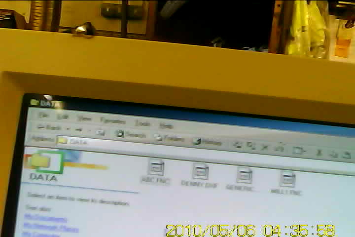

(2) The data folder with a few examples saved. Most are .fnc file formats.

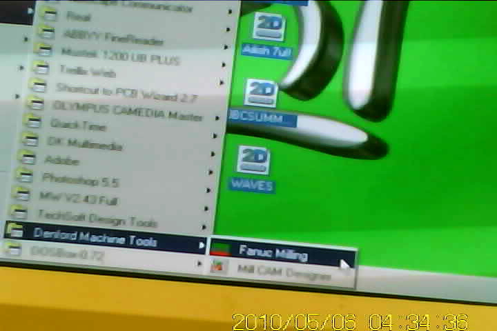

(3) the software that creates the design and converts it to G-text (Mill Cam Designer) and saves it to the Data folder as Martin pointed out and Fanuc Milling (which appears to be DOS based.

Re: Fanuc commands for Starmill PC
Fanuc Milling ??
Not sure what this is.
Is there a exe file called "Fanucsmd" or "Starmill"?
If not you can download it from the Denford website. (You will also need to copy the" DRIVERS2" file.
The correct software should link to the machine & display the Denford control Panel.
