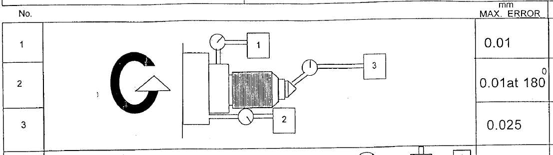

I can't find any info for the Starmill but managed to locate this for a lathe which should be similar.

Thanks very much for the info Martin, very much appreciated :-)
