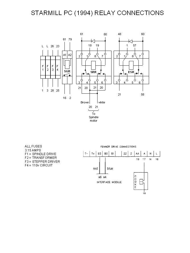

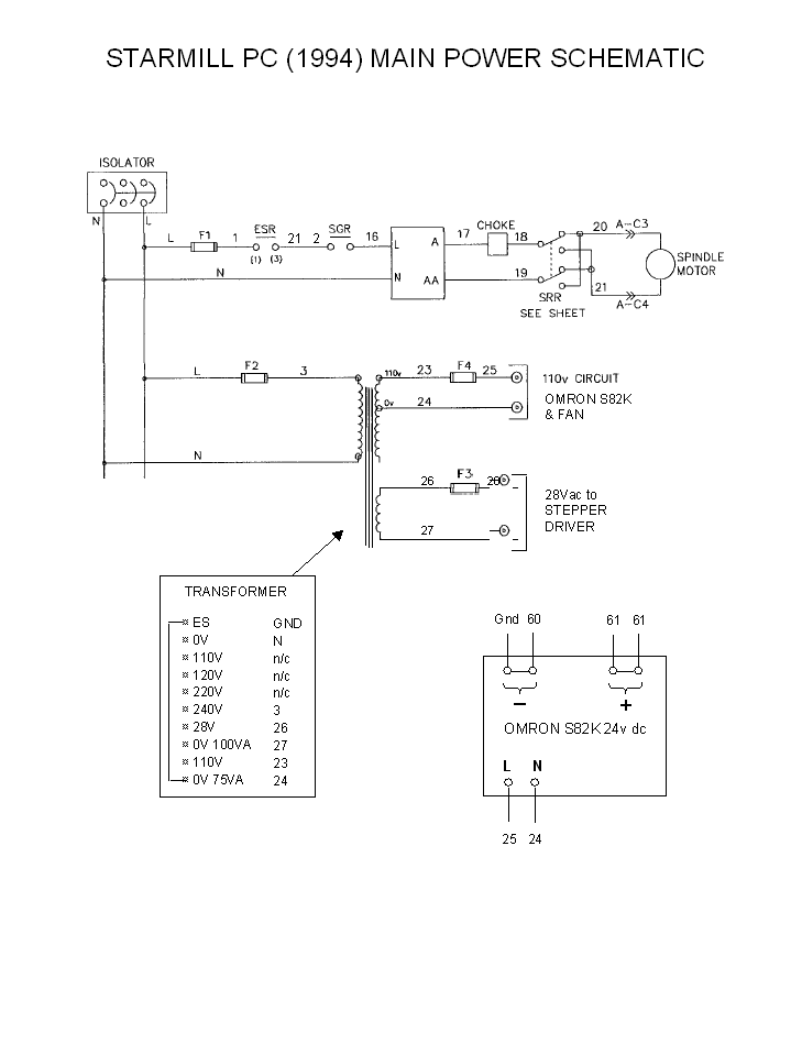

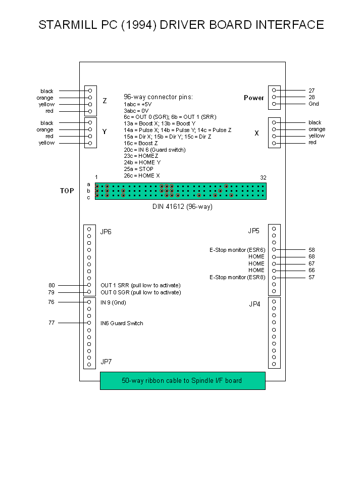

RE: My 1994 Starmill PC Mach3 upgrade. I attach a few wiring diagrams that I made over the weekend, as you can see, there are some differences to the Baldor Rack circuits. On close inspection, it looks like I should be able to re-use the existing spindle-motor driver interface board (Optimised Control D401 issue 2) with just a few minor modifications. This board already has a fully isolated pulse to dc converter –so I should be able to interface it safely to a diycnc PCPPS V3 breakout board. I will post details of the mods when I get the breakout board and test it out.

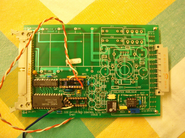

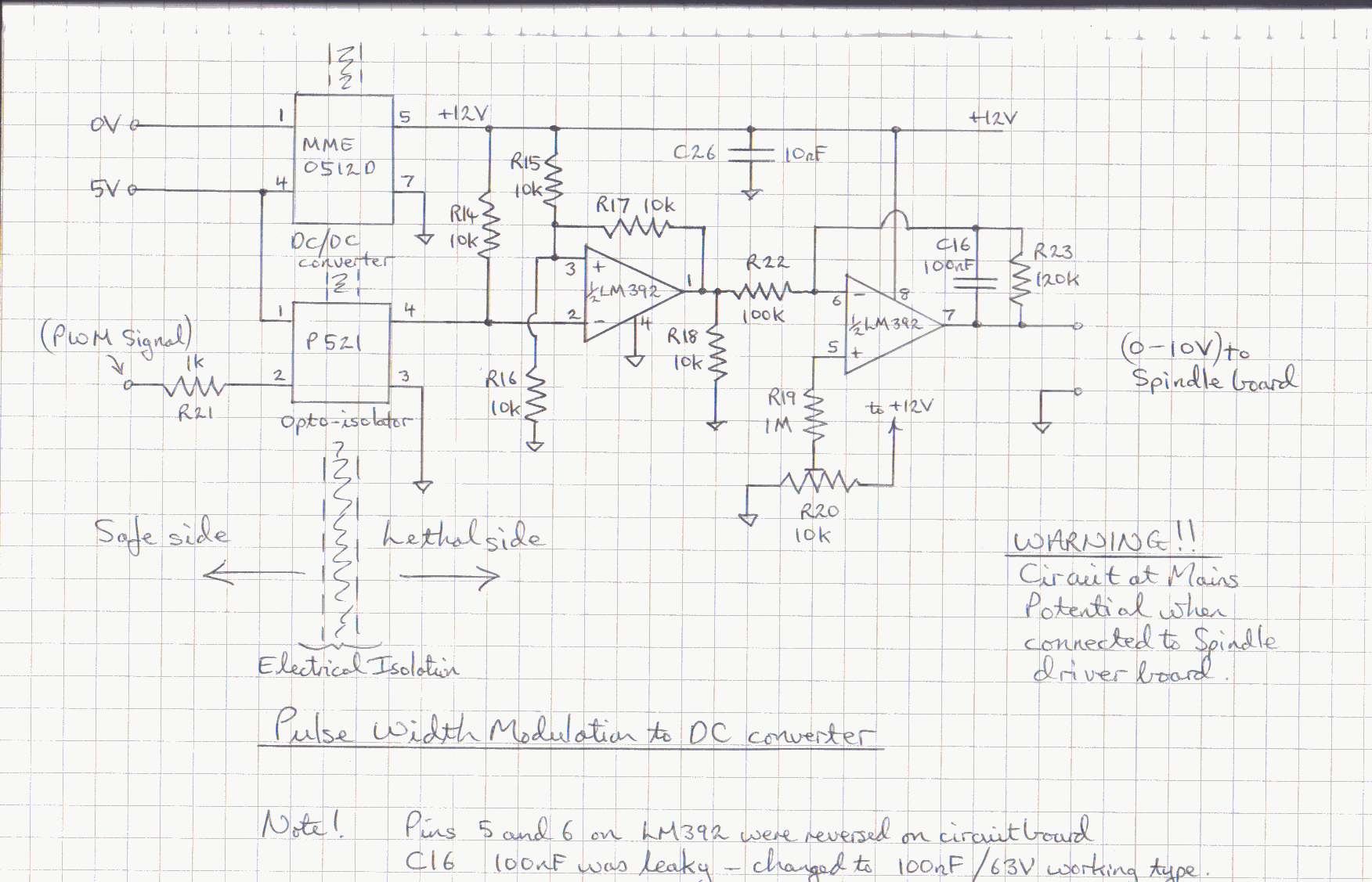

Just to say thanks again for all the help. After a short half term break, I now have my Starmill PC fully converted to Mach 3. I was able to reuse the existing spindle-motor interface board after making a few modifications (I attach the circuit diagram and a photo of the modified board). I had to replace C16 -which had gone leaky; removed the two ICs in sockets (ULN2803 and PAL16L8); connected 5V to pins 14 and 20 and 0V to pin 6 of the PAL16L8 socket. (Putting 5V on pin 14 disables the chip-select lines of the two IC’s closest to the 50-way connector as these are no longer used.) The Mach 3 PWM spindle-speed signal was fed to the board via a screened cable to pin 13 and grounded at pin 8 of the ULN2803 socket. I re-used the ULN2803 as a buffer for the PWM signal and as relay drivers for the Spindle Go Relay and the Spindle Reversing Relay. I fitted this IC on a small Euro-card with a 92-pin DIN 41612 socket for making all connections to the existing stepper driver board. I also fitted an R8 6mm sidelock end mill tool holder as suggested – great idea thank you. I bought this and a matching set of FC3 milling cutters from Gloster Tooling. Everything seems to be working OK, just need to tweak the motor settings. The Y-axis stepper seems a bit noisy when moving -probably needs a good clean out. If anyone needs more details of the conversion of a 1994 Starmill PC to Mach 3 I would be happy to help. (With hindsight, it is probably simpler to buy a new spindle driver board than modify the existing one – I have one on order to use on my lathe.)

Hi Some great info here, Can any one help please. I am just making an interface board for mach 3 and just wondering
if the connections on the 96 way conector for the X Y Z step and Dir for X y Z need to be pulled to GND to operate
or do they need a +5v signal to operate? as i don't have the whole machine here to test it is making it a bit
difficult to determin, i have looked at the wiring and i think that the pins 14 a , b c, are floating and need pulling to GND to
function. but not entirly sure, for the direction it will obliviousl be high or low for CW CCW. i have seen on another post the
96 way plug and i think it is the female to plug into the lower board, again i am not sure?
Like wise to operate the SSr and SGR relays they need to be pulled to GND to activate. does anyone know if this is correct?
On the same board i am going to incoporate the spindle speed control, (isolated) my intial thought was to
use a LM2907 freq to voltage converter for the 0 to 10v output for the fenner drive. once i have finished the PCB i will post up the
etch file for the PCB to share.

yep, they need pulling low. I think there's a pullup on the board but it wouldn't hurt to provide this on your board. Pay attention to the isolation on the spindle drive as the input could be floating up at mains potential.

Definately need an isolated 0-10v board for the spindle speed, and do watch your fingers.
Radio control servo leads are quite handy for connecting to the 96 way header for step and direction feeds.

Thanks for the info good idea on the radio control leads...
definatly be isolated from the spindle drive as it bites!!
