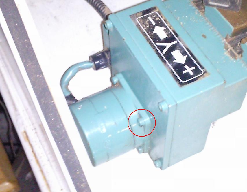

I am wondering what is the best way to go about doing this? My plan was to examine the existing motors and try to find equivalent replacements, or better still, suitable upgrades. Can I just undo the fixing's circled in the attached picture and try and find a part number or will removing the motor in this way cause any kind of calibration error?

I think you may find it easier to remove by undoing the other 4 cap-heads which cover the whole of the gearbox and lift it up and out (it looks like a belt and pulley behind the motor)
Although it looks like any information plates will have been painted over, hopefully someone will know the spec of the Starmill motors...and what you can replace them with

Also the motors shown are not as efficient as newer ones which have higher torque. You can identifie the newer ones by the round body.
The motor in the photo has a pully on the end and is connected to another pully on the Ballscrew by a toothed belt.
No calibration is required in the reassembly.

The replacement motor would be a BI00422Z they are available from Denford at around £40 plus P&P

Great, thanks for the help. I just had a look inside as previously described and can't see anything obviously wrong, the pulley also seems to turn freely so maybe the "increased resistance because of low temperatures" idea was crazy after all. In the situation I have described, does replacing the motors sound like a sensible course of action? If I order a new motor is it just a case of simply swapping them over? Also how would I go about changing the motor for the Y axis? It doesn't appear to be very accessable...

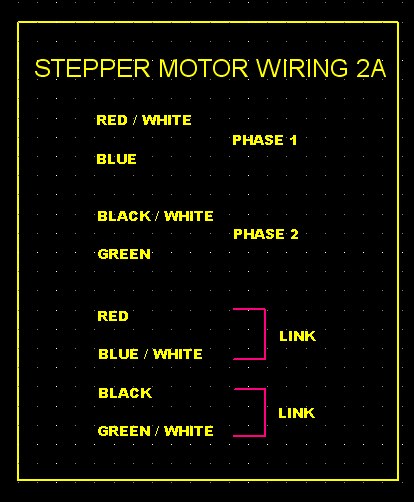

The new motor is a direct swap for the old one.
The motor is 8 lead and is wired as a 2 A
The connection diagram is attached.
