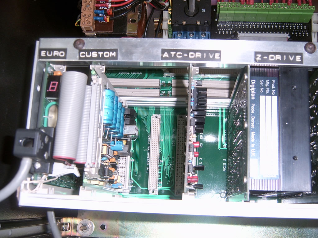

I checked the rs232 cable and its ok and in the display of the eurostep controller card appears an 8

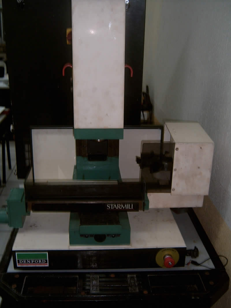

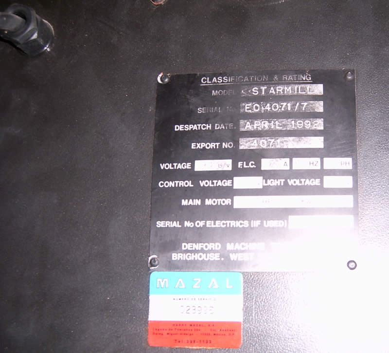

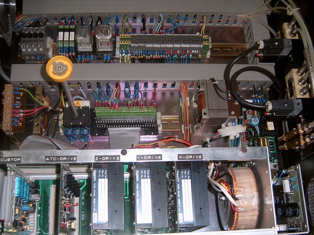

I added some pictures of my machine
- STARMILL
- SUC32432.JPG (43.31 KiB) Viewed 10358 times
- BOX
- SUC32439.JPG (57.14 KiB) Viewed 10358 times
- INSIDE THE BOX

- EURO
- SUC32434.JPG (174.56 KiB) Viewed 10358 times

The 8 on the board is a good sign

Check the internal RS232 cable from the socket to the control board inside the electrical control box is OK.

FYI:
The L means that the card is waiting for a connection..
An 8 means that its connected and talking to the PC
An S means the Emergency stop button is pressed in

I check the EUROCARD and i noted the battery was corroded, and the voltage in the battery it's only 0.5 Volts.
The machine shows the Errors when i turn it on, but after 15 minutes with the controller on, the machine works more or less and the errors desappear.
Can the battery be the problem?
Can the machine work without battery or with the battery in this conditions?
