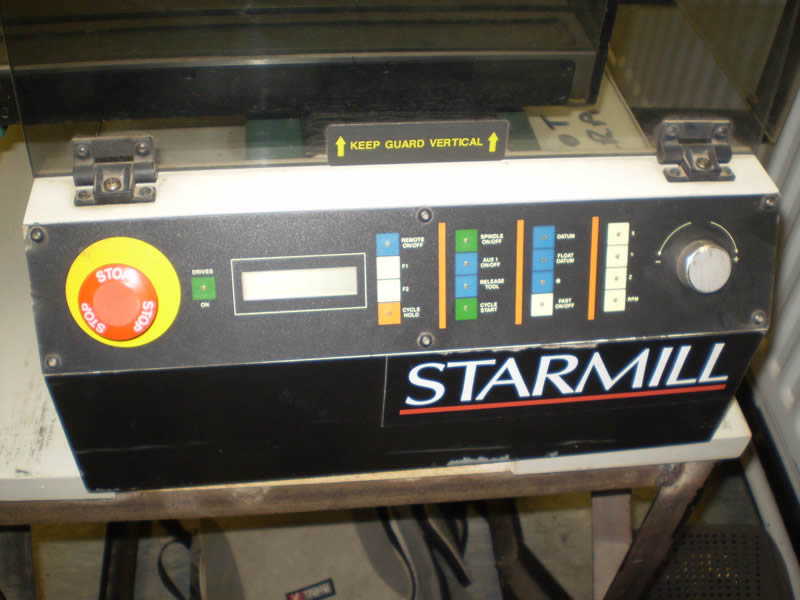

Is it possible to drip feed to this machine. We have just found this Starmill a few days ago and would like to get it moving. A manual would be useful :?: A picture has been added. :!:

I think there are different control version of these - a photo of the electronics would help.
I've found a NEE version and a Baldor / DOS version (these ones should be able to be upgraded to run the latest windows software)

This is an NEE version of the Starmill (fitted with an SMCU controller)
It must be connected to a PC to enter and run CNC programs (you can not program the machine from the front panel, only jog it around)
Software and cable diagrams can be found here viewtopic.php?t=196 - use the "Starmill SMCU" software in the zip!
