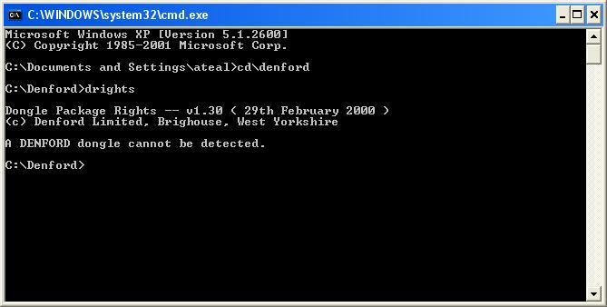

It sounds like you're running from windows ? XP ? 98 ?... run cmd (command prompt) and then run drights.exe to keep the results in the cmd window visible.
You may have to put the full path to the .exe in eg c:\denford\drights.exe

Right, did that and it worked a treat thanks.
Said dongle not detected (even though I have it shoved hard into the back).
I read on this forum somewhere that this could mean the parallel port is not configured correctly or something and I had to go into the BIOS.
Would you be able to explain what I do once I get into the BIOS, please?

If a dongle is not recognised. In BIOS try changing the PARALLEL port to an ECP (Enhanced Capabilities Port ).

Right, I got in and found that the parallel port was on SSP (I think).
The options I could change it too were, EPP1.7, ECPEPP1.7 OR ECP. So I went with ECP. I will test the machine to see if it works in a moment.

When you run drights you should see something like this screen - your screenshot appears to be running fanucsmd
- drights-screen.JPG (30.54 KiB) Viewed 34270 times
