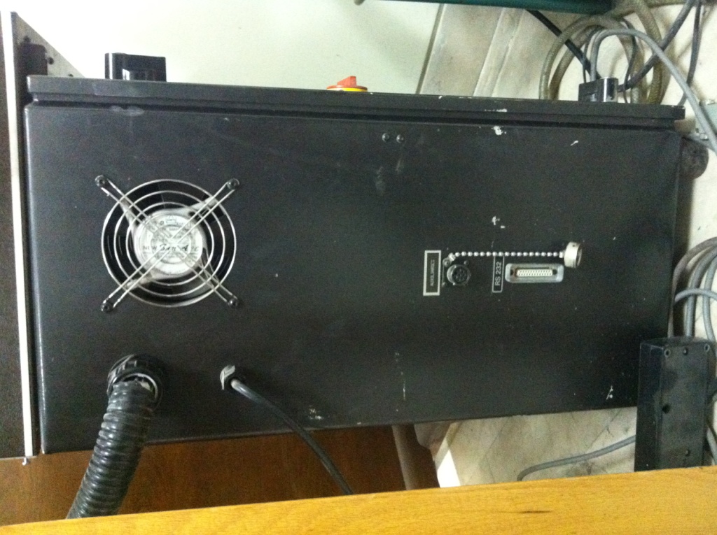

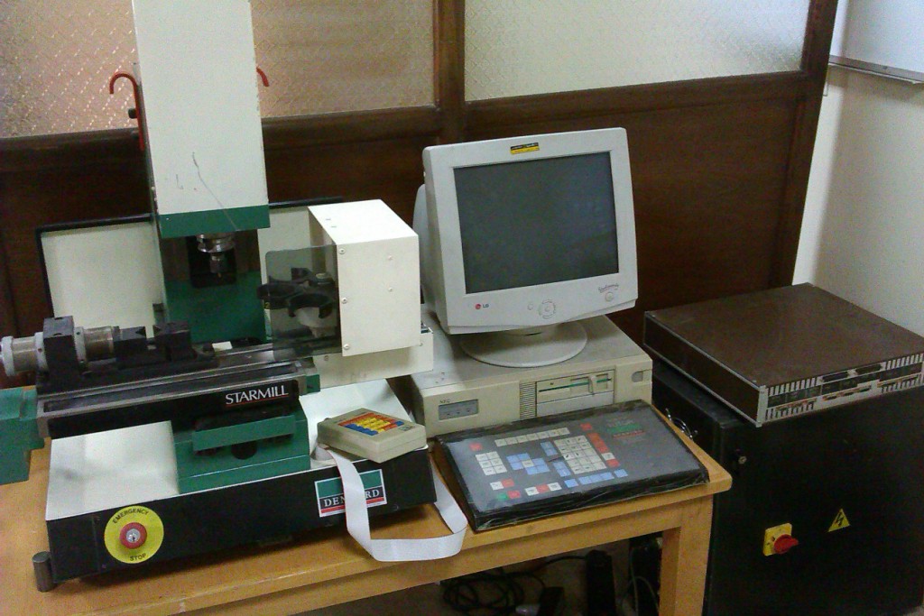

hi,i have an old version of starmill which has been bought in 1992,does anyone know how the individual parts(control panel,starmill,pc,and ...)connect together withe the cables,some pictures has been added.

It looks like the Starmill was part of a FMS or CIM system originally.
The electrical cabinet needs to be connected the serial port on the computer using a RS232 lead. The electrical box will have a harting plug that connects to the rear of the machine.
Because it was part of a system you may need to fit a dummy plug to the additional I\O socket or link out the remote emergency stop.
It will also need a air supply & the pipes connecting.
The unit sat on top of the electrical box is not required & would have been used to control the rest of the system & interlocks.

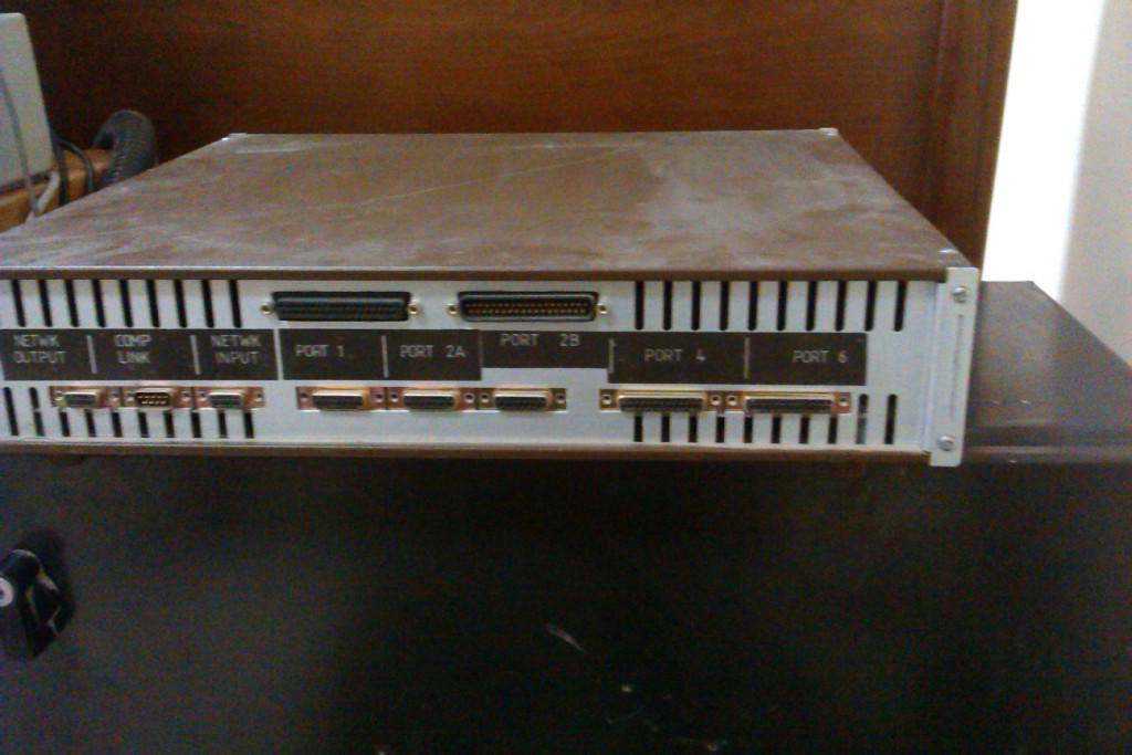

Many thanks martin,what about the control panels(the one in front of computer & the one sat on the machine),do they both belong to this starmill?and where should i connect them?
Re: starmill old version
Post by Denford Admin » Thu 11 Apr , 2013 11:41 am
The grey keyboard with white and blue buttons is the Tutor keypad and will be used to control the DOS milling software.
Not sure what the other thing is for, probably something to do with the CIM system or robot ?
Anyway all you should need to connect is
Machine > big black box
Tutor keypad > PC via RS232
Big black box > PC via RS232
Like Martin said, there is probably an additional I/O connector on the big black box which will need a link fitting (it would have been used for an external emergency stop signal in the CIM system) There may be a dummy plug with the link fitted lying around somewhere ?

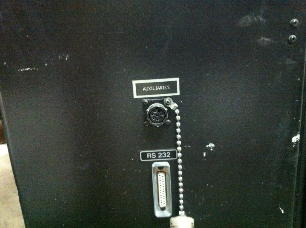

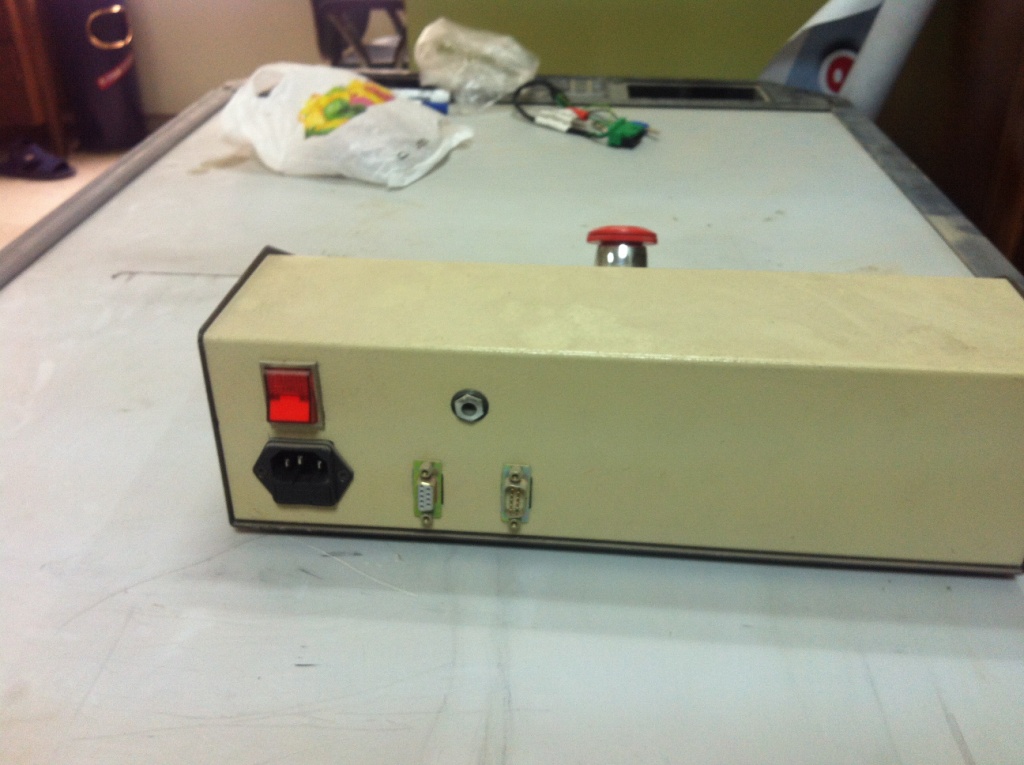

this is some more pictures from the back of the big black box and the emergency stop.the electrical cabinet has a 7pin connector and a RS232,and some more plugs is at the back of the emergency stop box!!??what's the 7 pin connector for?

Post by Martin » Sat 13 Apr , 2013 22:18 pm
Auxilaries & remote emergency stop.
