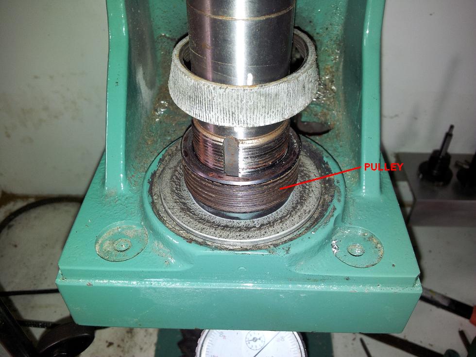

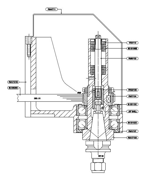

I also removed that nut to have a look at the pulley. From looking at the attached assembly drawing (from this forum) and the picture I've attached showing the pulley (minus tab washer and retaining nut), it seems to me that the nut and tab washer are there to stop the pulley unwinding itself. It also looks like the pulley sits straight onto the top of the two bearings, so really it would be the pulley I would be wanting to tighten rather than the retaining nut?
Whether tightening solves the problem or whether I end up having to replace the bearings, I'm still going to have to tighten/loosen this pulley in one way or another and I can't see any obvious way of doing so! It has two recesses on the internal thread (like the channels you would expect to see for a woodruff key), I'm wondering if there is some sort of special tool that maybe locates into these enabling you to tighten/loosen the pulley?
Thanks again!

the pulley isn't threaded in that diagram, so it will slide up and down when you loosen or tighten the nut.

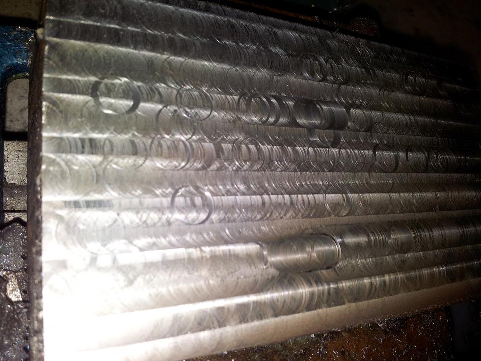

However, I still have a problem I need to figure out. I've replaced the bearings and everything seems to be OK, except for the fact that I'm getting a poor quality surface finish.
I machined a flat face on to a block of mild steel, however, you can see from the attached picture that I'm getting "rings" or "swirls".
They are very slight and can only just be felt when running a finger over them so essentially they look a lot worse then they are. Logically I can only think that they are caused by some small degree of play in the Z axis and I can only think it is because the retaining collar that clamps the spindle bearings in place is not done up tight enough?

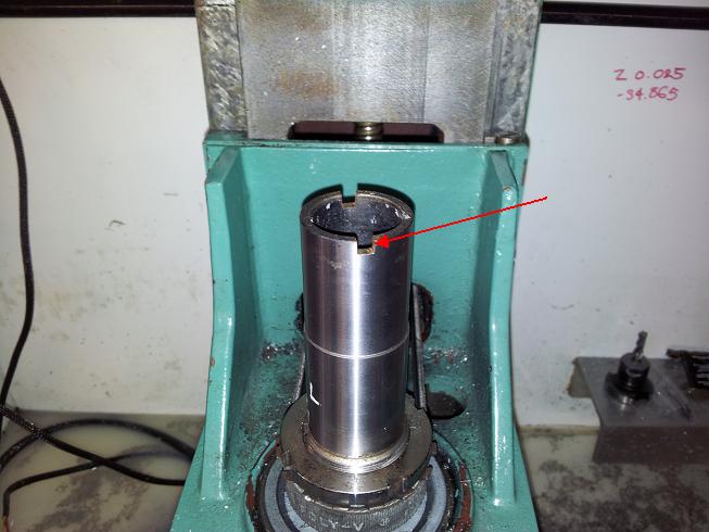

I am thinking then that I need to torque the collar up more tightly. Does anyone know what sort of torque should be applied?
I also wonder if anyone knows if there is a proper tool that locates into the slots (pictured) in the top of the spindle in order to secure it when tightening the collar?
I have so far managed to put a flat bar between the slots and tightened the collar up pretty tightly however I can only think that it needs to be tighter in order to secure the spindle and prevent any movement at all in an effort to remove the "swirls". I don't want to just rant it up and end up damaging the new bearings.
As always, any help is greatly appreciated.
