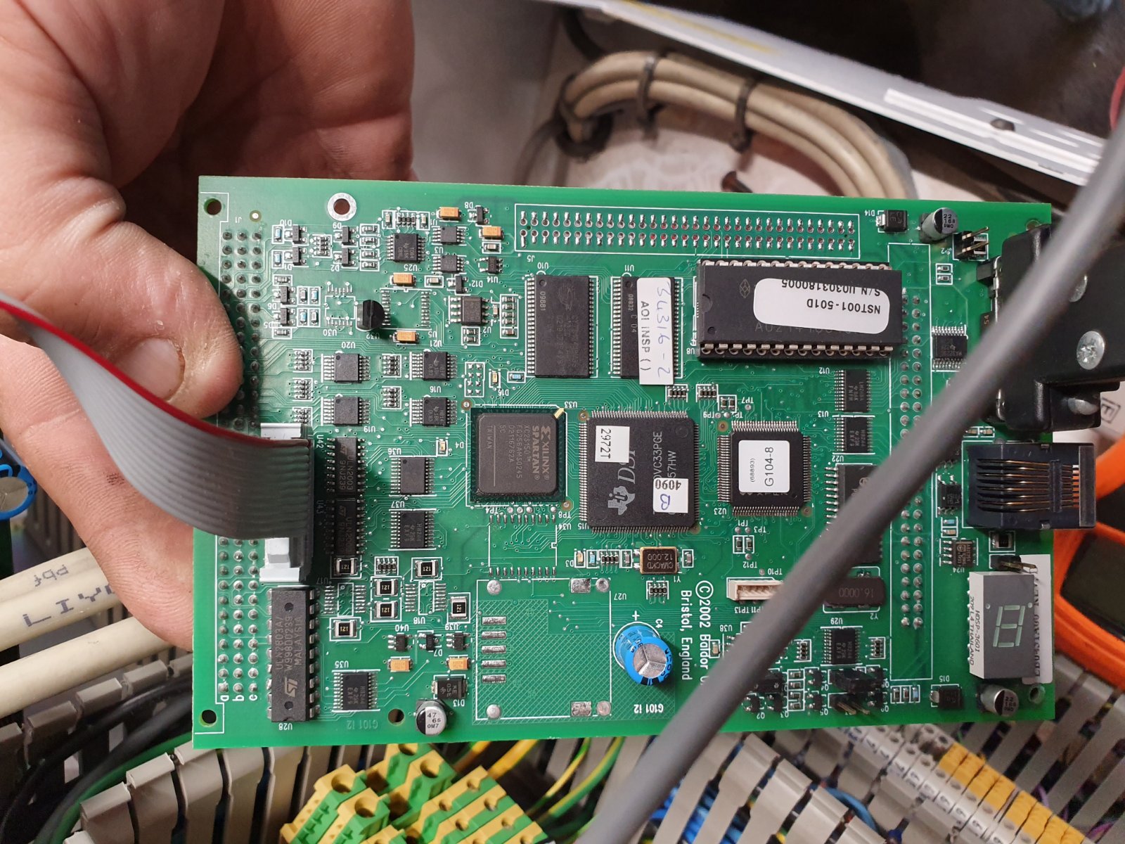

Hi Pete iv not done much the guy I bought it from said when you first turn it on it should go strait to home iv tried to connect it to the computer but it won't connect a the moment I'm using an rs232 to usb but I think I'm going to buy an old computer to try this again I have a fully licensed vr cnc milling program it. What is happening is when turned on all the axis just judder and move very very slowly I was thinking of converting so I can use mach3 but there are so many options for controllers and drivers have you any recomendations thanks for replying I'm quiet new to this but I have an understanding and like getting my hands dirty
Re: Please help juddering not homing

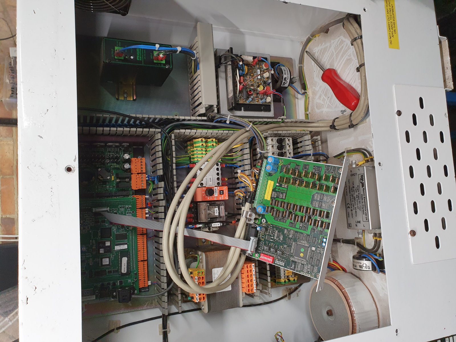

Nothing should move on the machine until it's connected to VRMilling.
Does the green LED on the NextStep control card light up?
- Posts: 613
Hi, as Martin says (he knows a lot more than i do!) it should not move until it is talking to VR milling. So something is off there.
As a process of elimination I would do the following.
Don't hook up a PC yet, fire it up and you need to look at the top board and observe what the LEDs do and 7 Segment display.
Nothing should move, you should hear a clunk after a short period as the door lock opens to enable you to open the door.
If something is moving on power up, power it down and disconnect the ribbon cable from the top board to the drivers, that will give a better clue as to where is issue is coming from.
Feed back to us on that.

Sorry for the late reply iv fixed it it was the main board luckily I found a used one on ebay for 35 and took a chance now it's working fine I use a rs232 converter and have no problems at all just got to get used to this denford software now it seems quiet easy can you guys recommend what animals I should be using I'm new to all this but want to definatly have a play around
