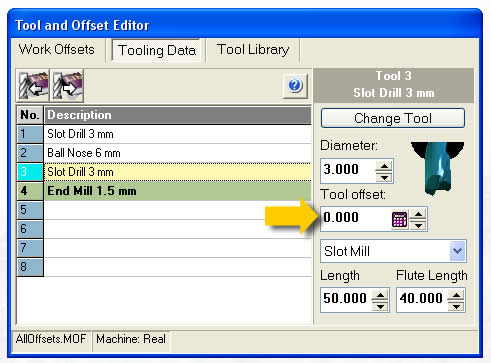

Are you doing a toolchange within the same program?
There are separate tool Z length offsets which can be activated per tool. These add onto the main workpiece offset which sets the X,Y and Z work positions.
- ToolOffsetVR5.jpg (35.52 KiB) Viewed 18436 times

what would the offset be for a 6.35 mm diameter ball nose?
Re: datum issue
The diameter of tool makes no difference to the machine.
Tool offset is the difference in length (or Z position) between two tools.
Say tool 1 is short, it's tool offset would be 0.000
Tool 2 is longer and it's tool offset might be +5.650 (nb, I may have the sign the wrong way round but you can set the second tool by activating it, jogging and touching on the surface and clicking the datum button in the Tooling Data window)
