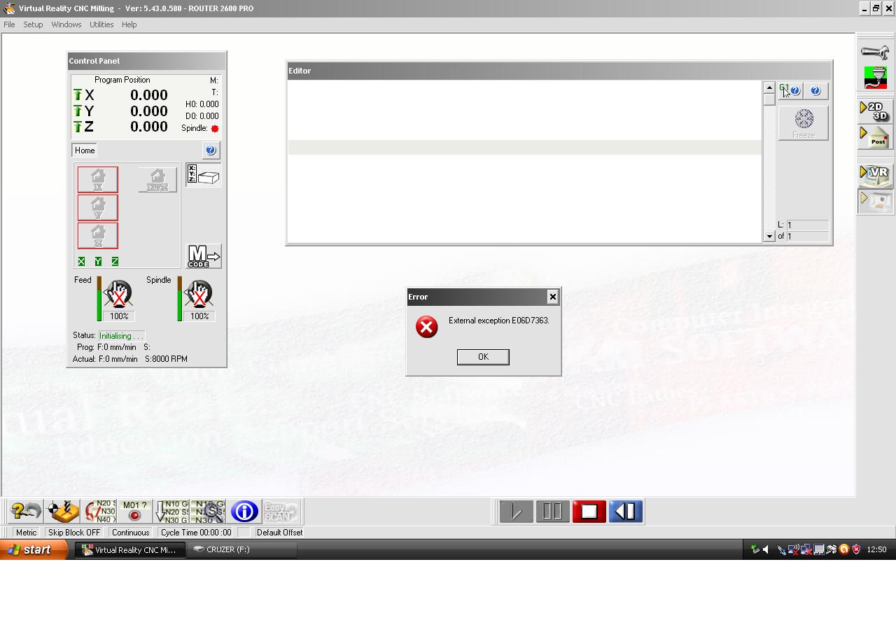

Hi, I have a router 2600 Pro.I didnt really know which category to put this under, so I a posting it here aswell. When Using VR milling 5.30, it works fine on one laptop, but the other laptop has the latest version (5.43) and when trying to connect with the machine a error comes up saying "External Exception" and a few numbers (Cannot remember them it started with E0 though). I cannot install VR milling 5.30 on the laptop as the supplied disc is too scratched to be read. Both Laptops run Windows XP Proffesional, and use USB 2.0 to connect to the machine. When I go to Device firmware Update, it shows all the information about the machine, So I definetly know the drivers are working and the laptop is connected to router.

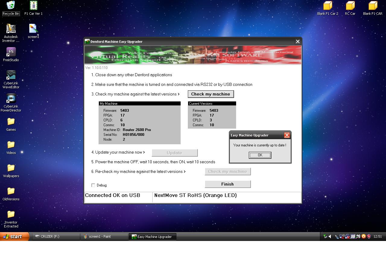

Easy Upgrader syas that it is connected fine and it has the latest firmware. The little box that says erasing flash or downloading does not come up, it just goes straight to the error message.

If esayupgrader connects ok then VR Milling should do as well.

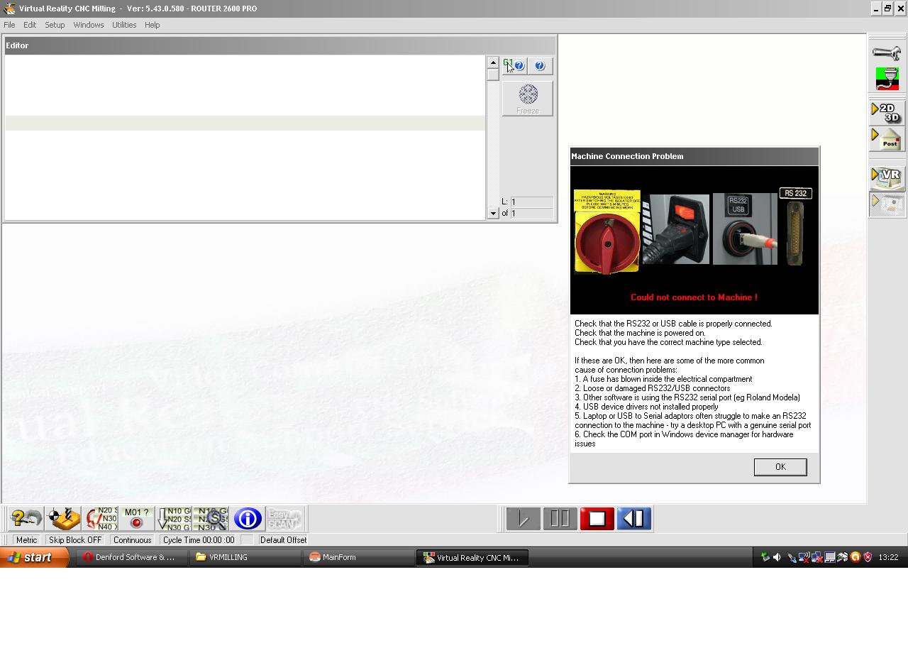

You don't normally get exceptions as soon as you press the connect to real machine button, but it's been known to happen when you press the VR machine button - when there is an issue with 3D graphics drivers. If the real machine can't connect then it usually comes up with a picture/message showing the machine could not be found and to check usb/rs232 connections.

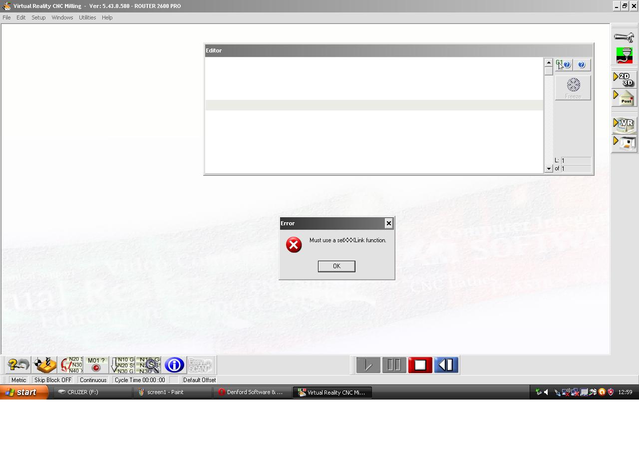

Yes, VR milling is set to 2600 Pro. The Virtual Machine runs perfectly, the laptop has a pentium 4 and a ATI Radeon 9200, Windows XP and 512MB Ram The 3D virtual machine works fine. Also sometimes it goes to not responing, and after clicking on the connect to real machine and axcpeting the error, the control panel comes up but nothing is clickable. An error saying something like XXXLink Must be used comes up aswell, not sure what that is about. I will try and get a screenshot of all the errors sometime today.

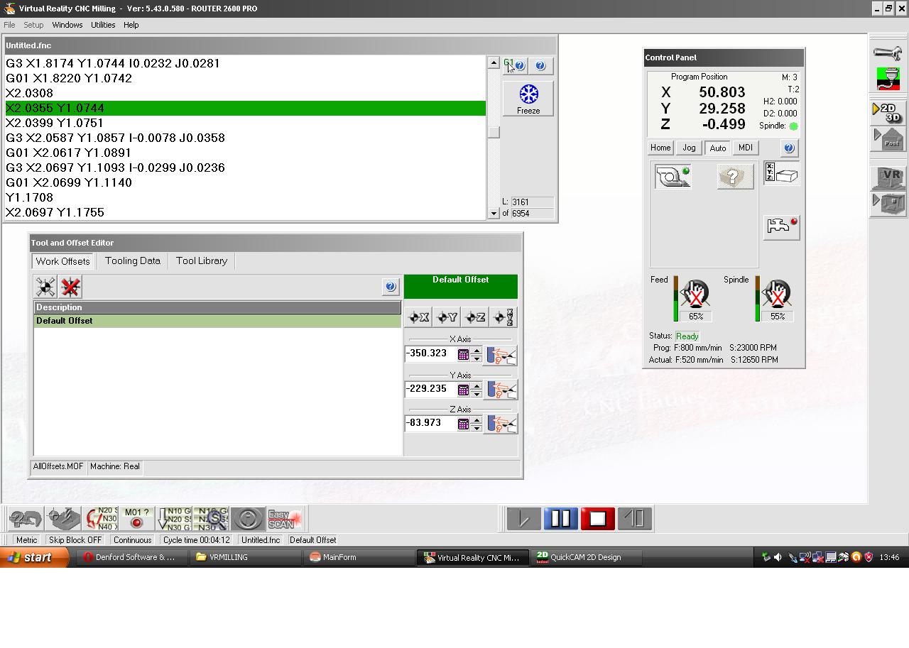

I first removed VR Milling 5, and the baldor drivers, and then re-installed everything. The first time I tried to connect, it gave me an error saying it wasnt connected, then the second time it worked fine. All the screen shots show the errors, and then it working. Thanks for your help!
