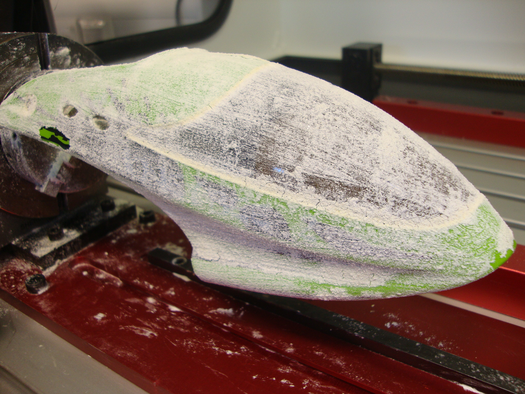

For one of our student’s projects he wants to redesign the body of his model remote controlled helicopter.
I am trying to take a laser scan of the existing body so he can run it through Solid Works flow simulation analysis and compare lift, drag ect. with his own design. The plastic body is very shinny and the laser will just reflect off this surface.
Normally I would spray the model to be scanned with matt grey primer but I can’t to do this as we will not be able to remove the paint once finished.

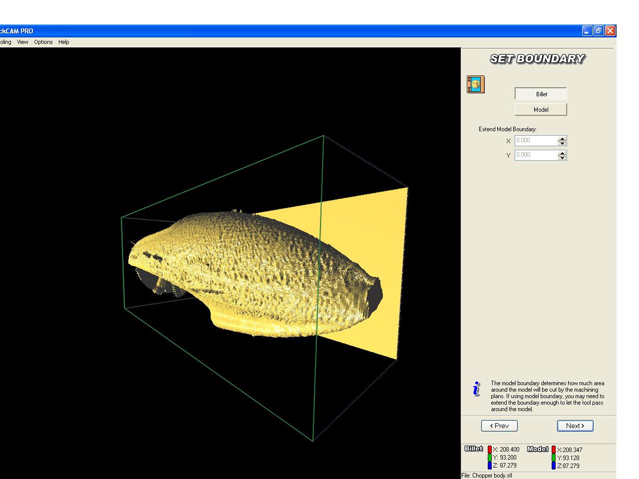

I have had some success lightly spraying the plastic model with multi surface cleaner and then dusting the model with flour to give a matt finish (see attached photo and screen dump). Obviously this just washes off after the scan with some water. I have tried a sugar and water solution but this did not work as well.
Has anybody got any suggestions for an alternative way round the above problem?
Any help or feedback would be much appreciated.
Cheers.
Rich.
Posts: 3651
Re: Laser scanning question
Post by Denford Admin » Thu 17 Jun , 2010 13:43 pm
I managed to have some success with white face paint (ie grease paint) that I got from the local card shop.
It goes on much like paint, but can be wiped off afterwards.
Grey might work even better ?...
https://www.fancydressdirect.co.uk/Face- ... -Grey.html
Let us know how it goes.
