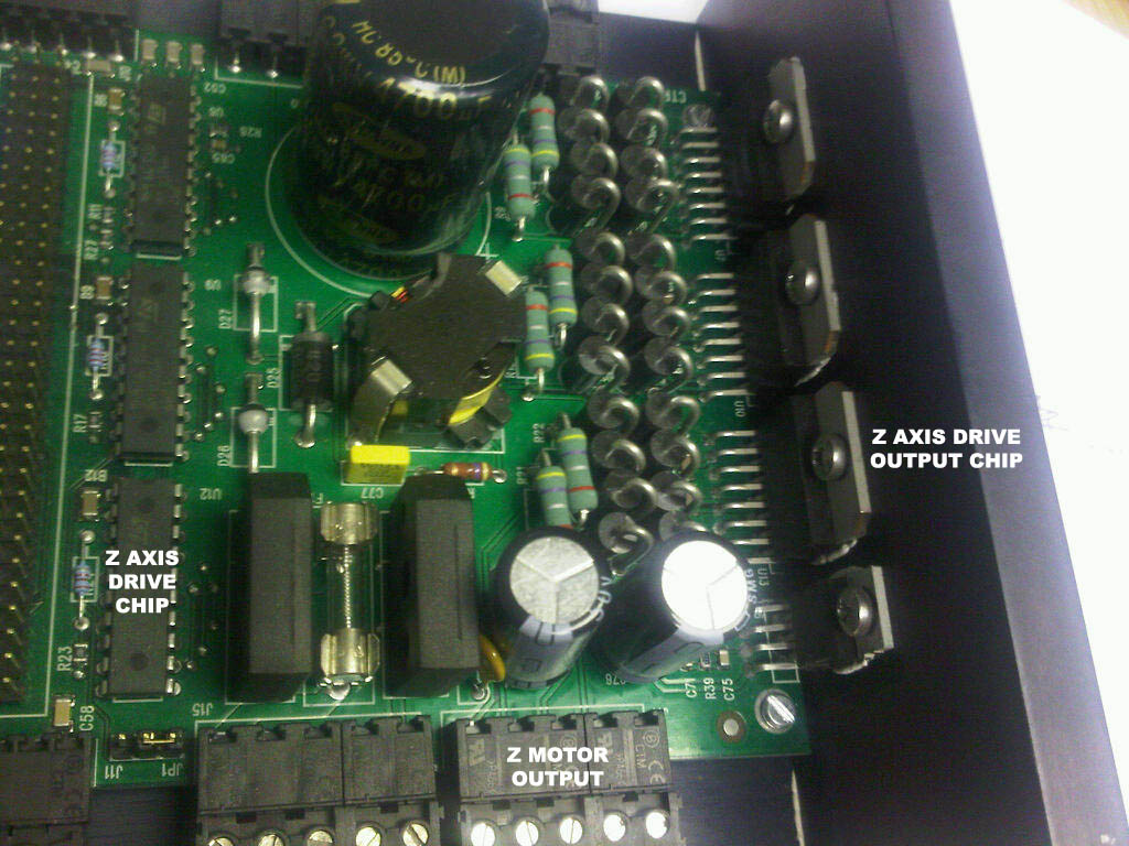

I think from what you have described the problem will be with one of the driver chips (the L297 or 298)
I attach a photo showing the devices.
You should be able to buy them from Farnell or RS
If you replace both it should fix it.
However if you attempt this and damage the tracks on the board then you will have to buy a replacement rather than get the service exchange as the board would then be unreparable.
The cost then would be £535

Many thanks for the picture Steve, I was wondering which chip belonged to which axis.... I figured it might be those 2, but wasnt sure. - That helps a lot with which ones to take out and change first.
I'm just getting my old man to order the 2 chips on the company account.... Hope it works! - Are the diodes also a potential fault or is this a red hering?

The diodes could be a problem but I feel it very unlikely. They are there to suppress the back emf from the motor.
The failure of the axis could be down to the control chip rather than the output device as when these fail there is normally smoke and a fuse blows.
If its the output device then this would normally be because either one of the motor windings has shorted to earth (its worth checking the motor wires as they come out of the motor body to see one is not damaged) or that there is not enough heatsink compound behind the output chip and it has overheated.
When you replace the 298 make sure its got plenty of heat sink compound under it and its tight down on the heatsink!
