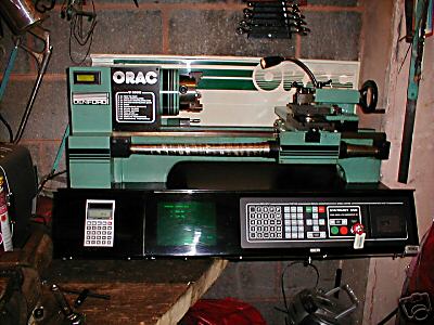

I have just bought an 'Orac' ID plate says it is 1988,the serial no. is AC 1908 B3, the circuit boards have serial numbers 48121414. I have a number of spare boards that came with it, they have serial no,s starting 381---. I have attached a photo, if anyone can come back to me with any info as to whether it is genuine or not.
It came with a 'Hieidenhan ME101'. If anyone has a manual or copy of or even how to operate this.
It came with data cassettes with programmes on which I can download into the 'Orac' and run it. I can write programmes save to cassette on attempting then to reload cassette onto lathe, the screen displays 'insufficeint memory'
Also I cannot seem to connect the computer to the RS232. The computer displays 'sending' and the lathe displays 'ready' but nothing happens. On the forum there are 2 cables, one for IBM PC and the other 'Orac IBM' . Anyone know which is the correct cable, I constructed an 'Orac IBM cable,but with above results.
Any help would be appreciated.

Well I've never seen a lathe with the rev counter before - I would have thought that was an addition by a previous owner.

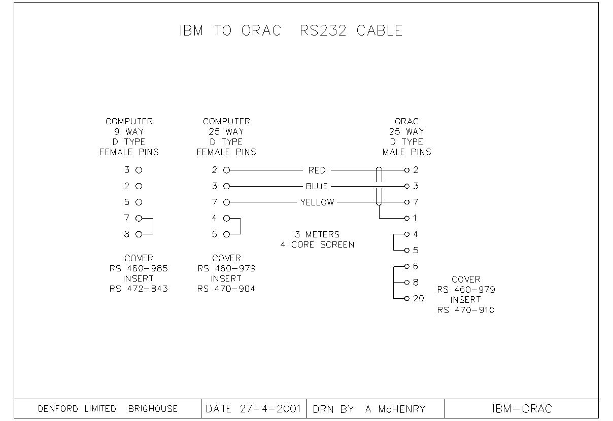

The tape deck is an antiquated thing, it just contains a record and a playback head. On the main screen, when you select "store on cassette," the recorder rewinds to start then saves, overwriting everthing in its path.
Over christmas ive read almost every mention of rs232 related questions on the forum. It was stated somewhere that the orac is connected Tx to Tx, and Rx to Rx. I have attatched two wiring diagrams, which one is correct.

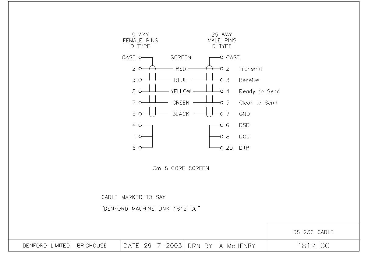

I would stick with the IBM-Orac drawing, and work it out from there.
The problem seems to be that the Orac connector was designed to allow the use of a pin to pin cable, and the TX / RX lines would be crossed over inside the machine.
Normally a cable for PC-Machine would communicate over two 25 ways with pins 2 to 3 and 3 to 2 (crossover)
9 way RS232 confusing things further by having the 25 way function pin 2(TX) on pin 3, so a 25 to 9 crossover cable would be pin to pin (2-2 and 3-3)
see this link on what should be standard RS232 pinouts
https://www.anotherurl.com/library/rs232.htm
As a starting point you know that Orac pin 2 is TX - all you need to know then, is what pin to connect to RX on the other device
Its impossible to say what the ME101 pin assignment is, unless you have the book or its on the Internet somewhere
