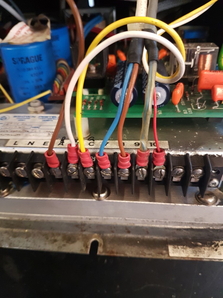

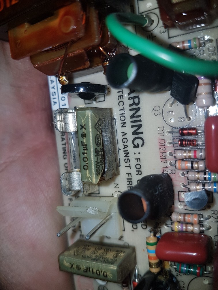

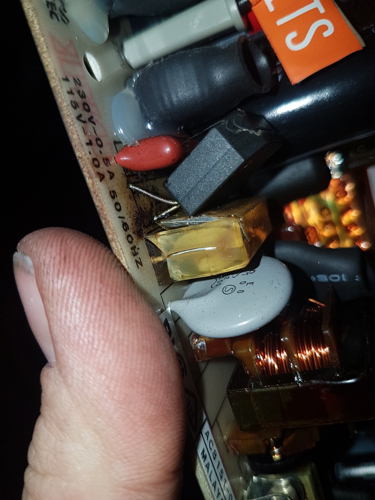

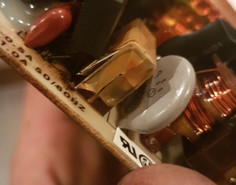

I have repaired the power board by the drivers as there were faulty components (electrolytic and paper caps) The inputs to the motor are all reading 158v.
I've looked through all the schematics but I'm at a bit of a loss now.

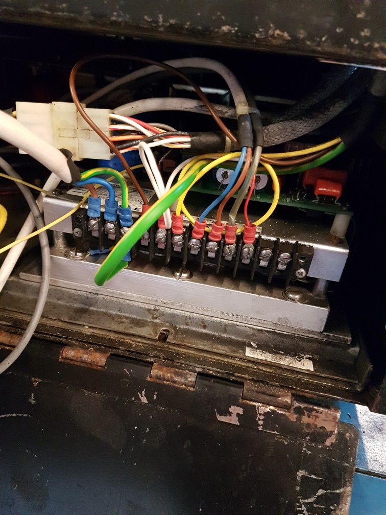

Re: Z and X and spindle all of a sudden not working

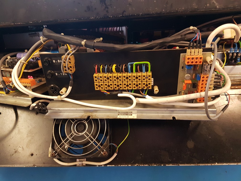

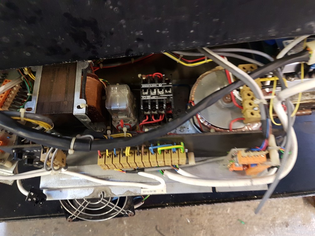

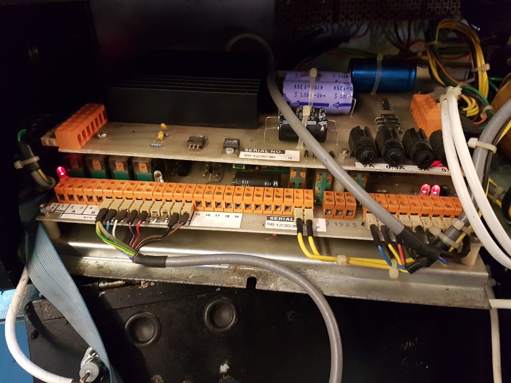

Photos attached
- 20180216_125137-1008x756.jpg (166.76 KiB) Viewed 33191 times
- 20180216_125135-1008x756.jpg (185.87 KiB) Viewed 33191 times
- 20180216_125141-1008x756.jpg (180.06 KiB) Viewed 33191 times
- 20180216_105239-756x1008.jpg (157.6 KiB) Viewed 33191 times
- 20180216_125146-756x1008.jpg (192.76 KiB) Viewed 33191 times
- 20180216_105849-1008x756.jpg (157.7 KiB) Viewed 33191 times

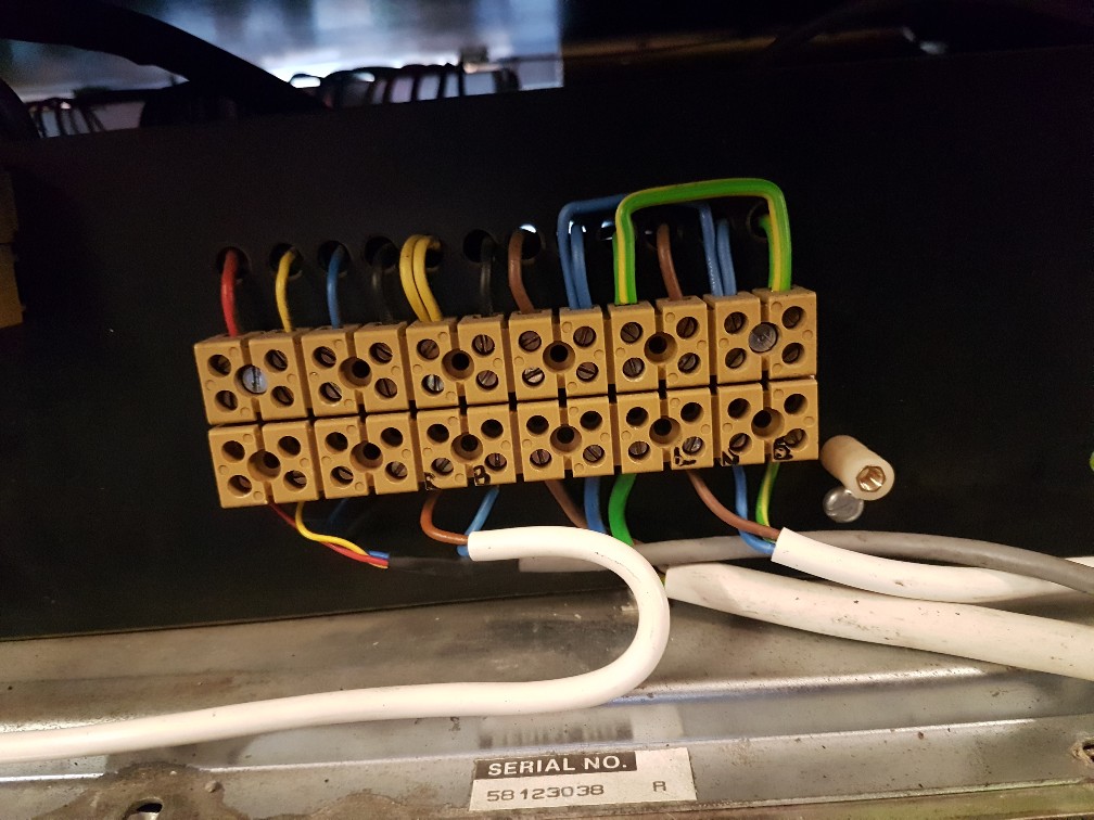

Power board repaired
