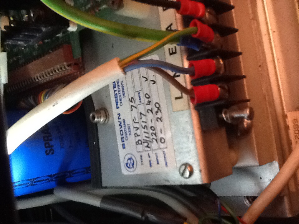

Re: Denford Orac. Not moving in Z and X axis

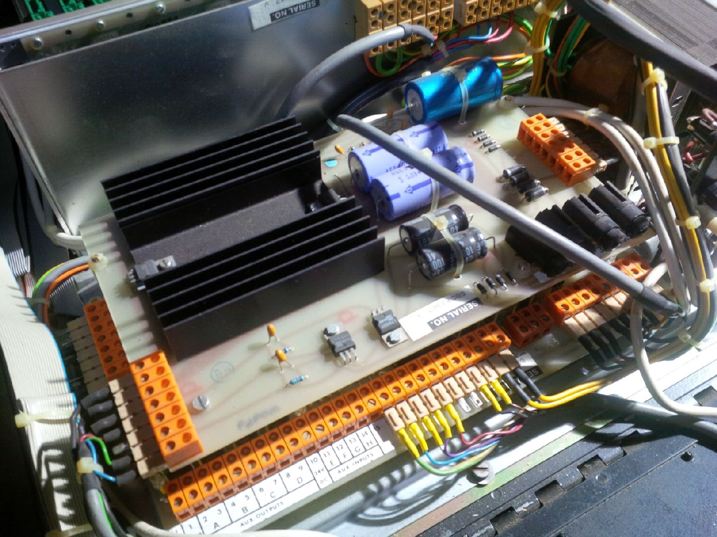

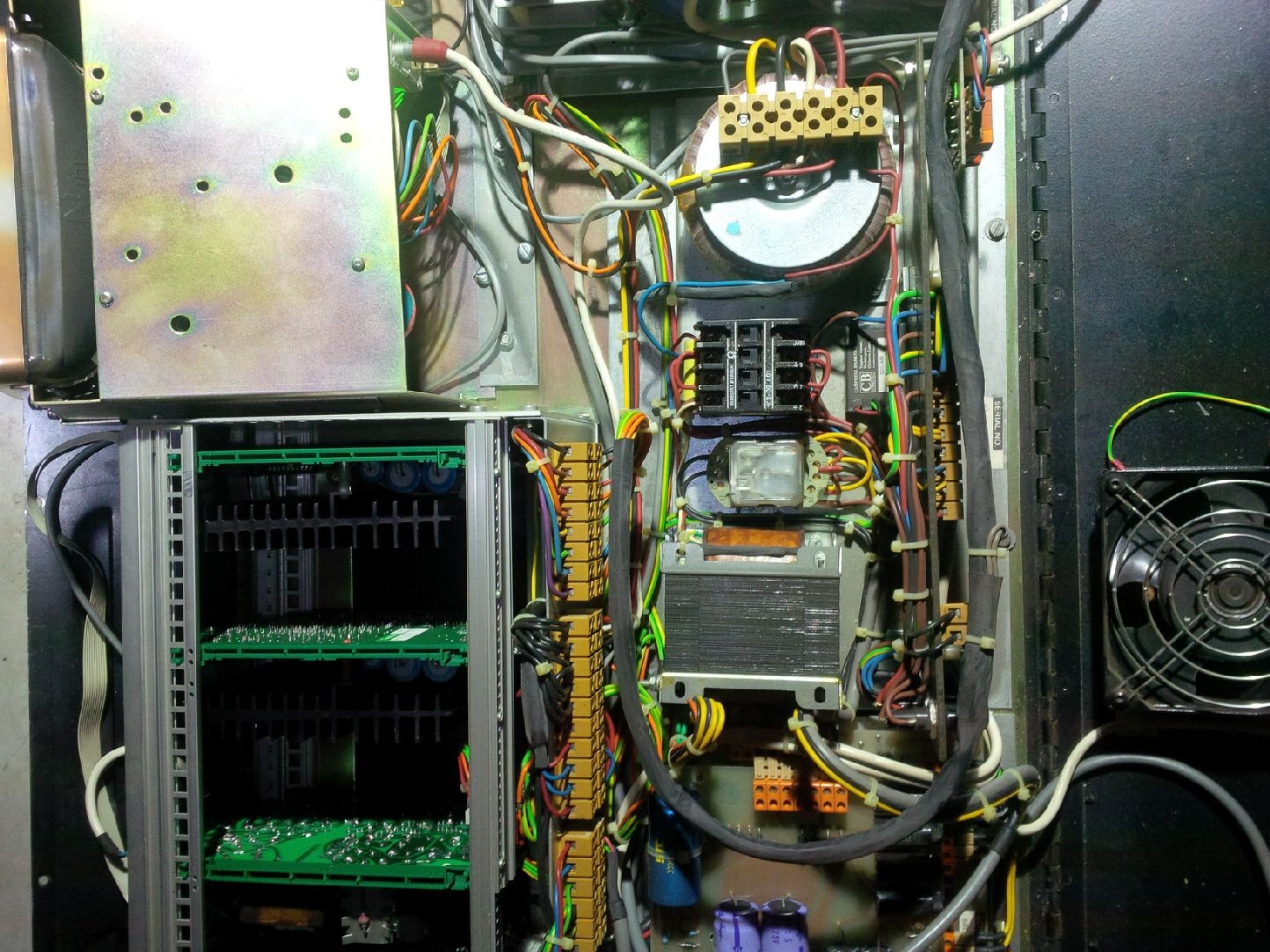

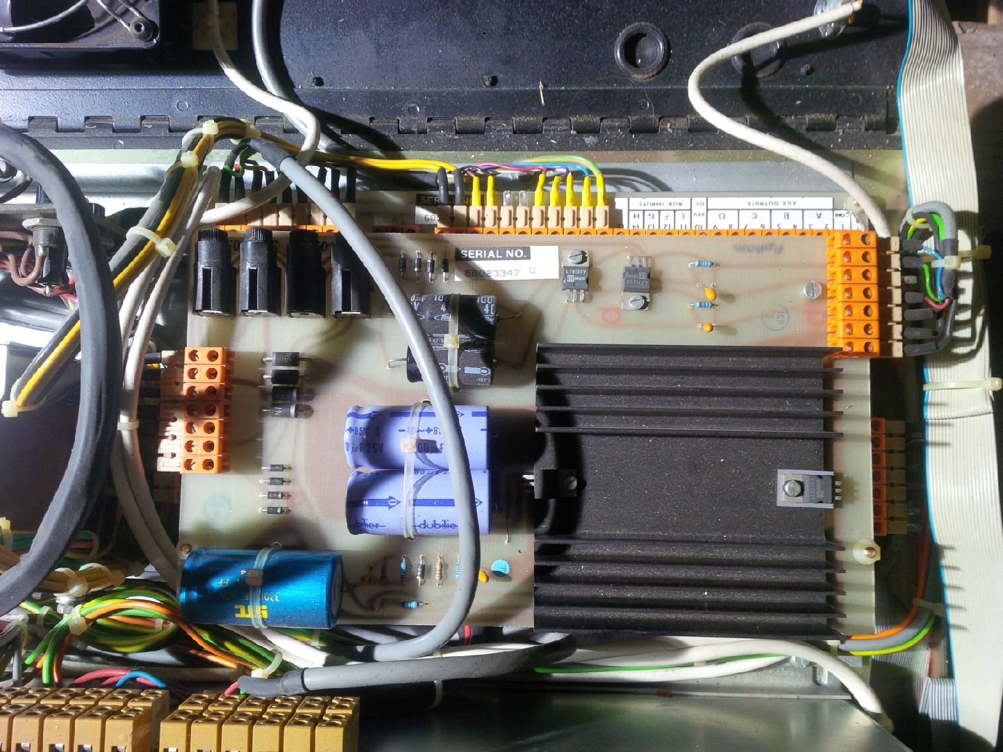

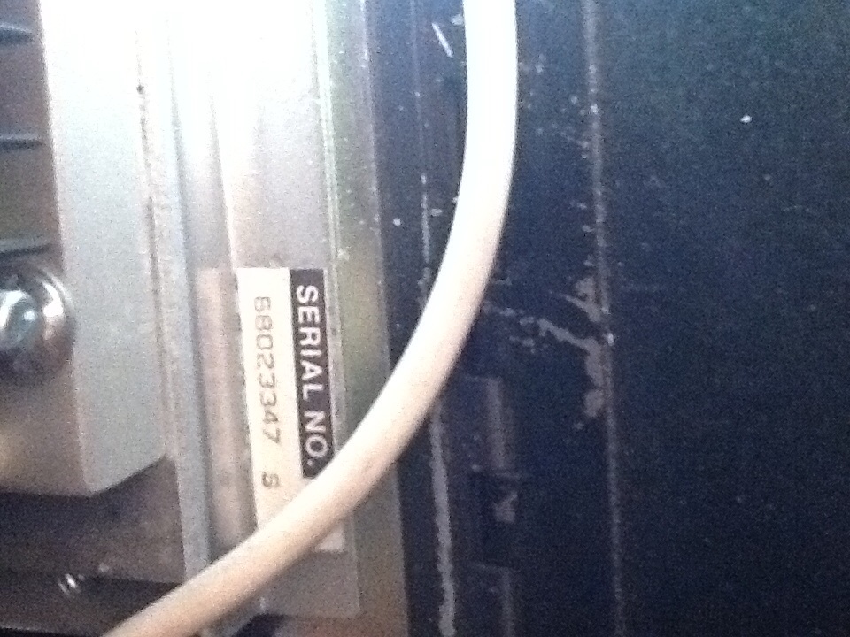

that's an early orac, and possibly it has the wrong drivers in there. Can you measure the supply voltage for the drivers, and take a photo of the power supply.

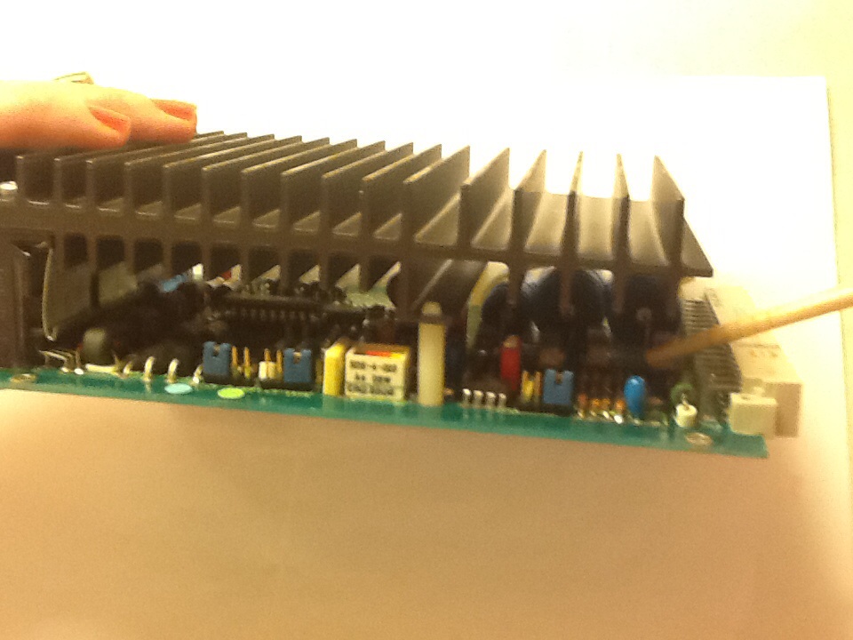

Here are some pictures. I can take better and more pictures, but maybe it's good enough?

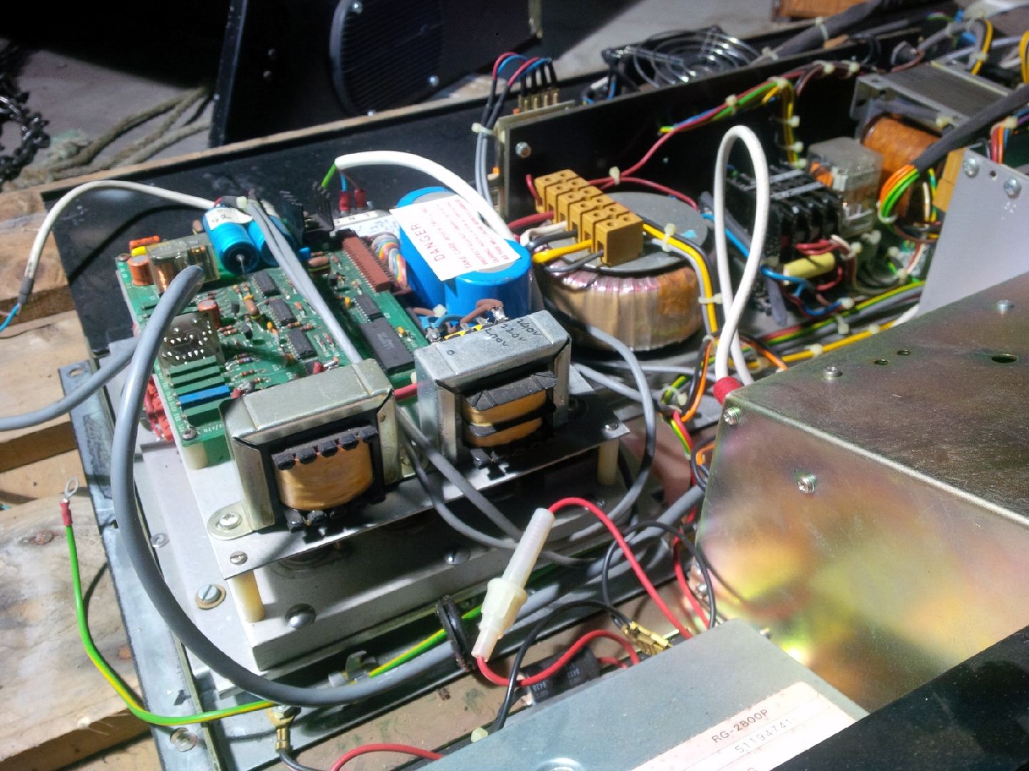

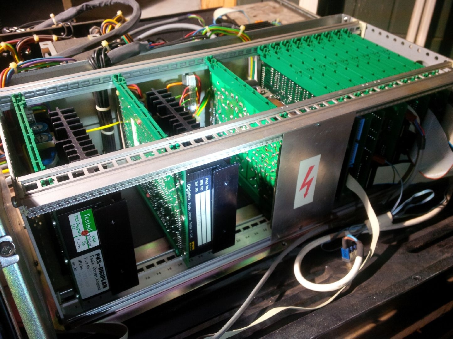

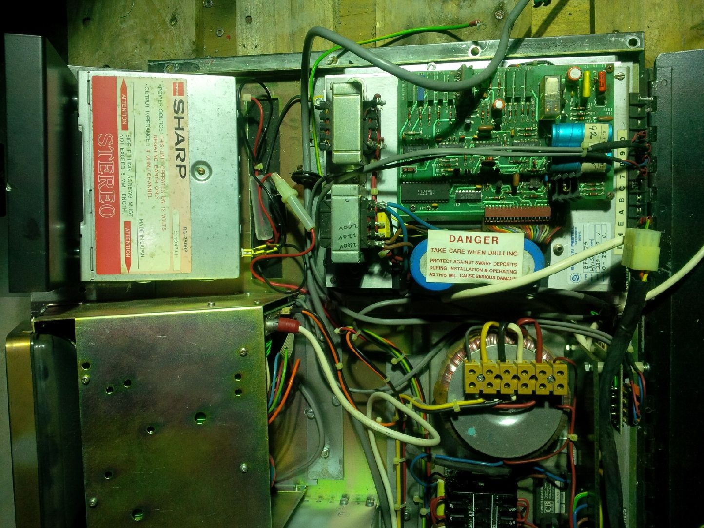

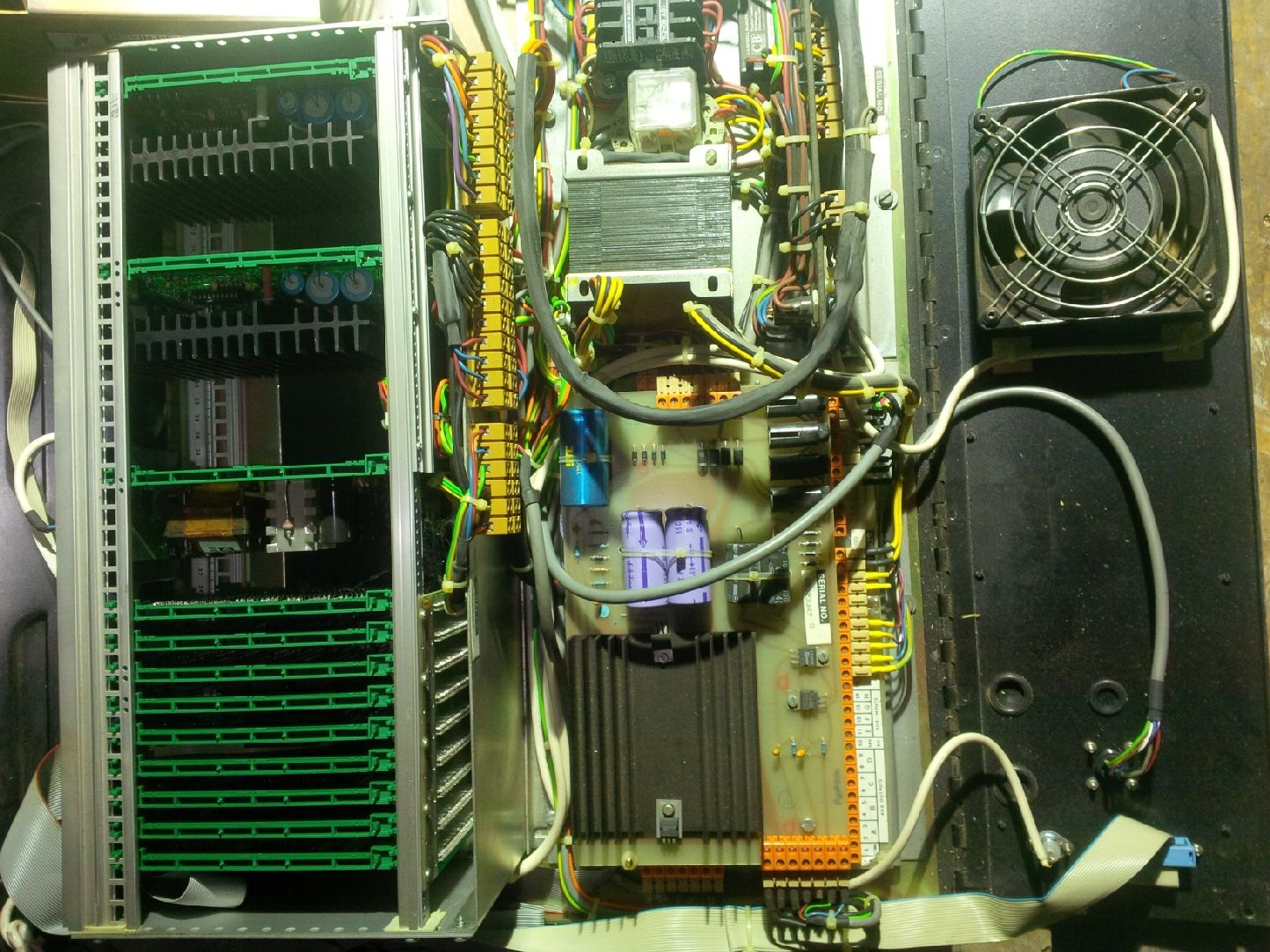

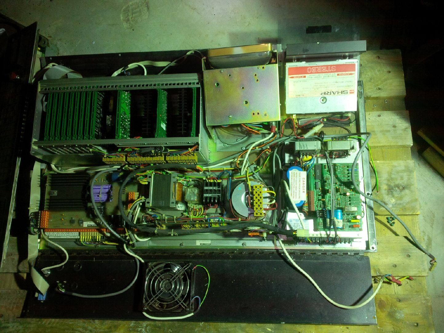

can you take an overall picture of the electronics
More pictures

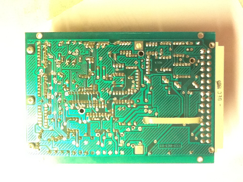

that is an sd2/3 drive, a lot of the earlier oracs had cd20 drivers and they are not interchangeable.
can you take an overall picture of the electronics.
I have never used this lathe before, I bougth it this spring together with a Triac mill and was told that it was in working condition. The mill works like it should, maybe the seller didn't know about this fault or it appeared after I received it?
Where is the supply voltage for the drivers?

2 x SD3 driver boards

Unfortunately it's not clear which version the lathe is and to tell you would have to separate the base panel from the lathe body.

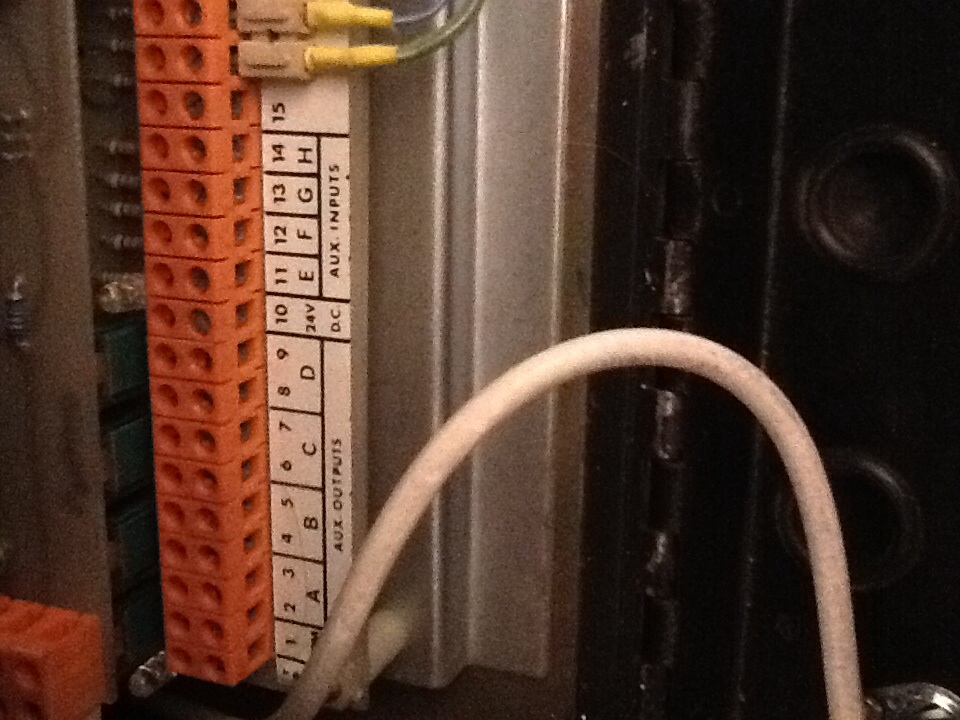

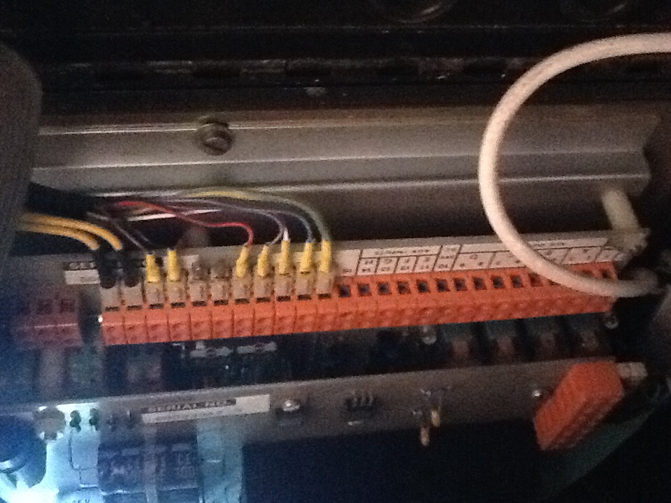

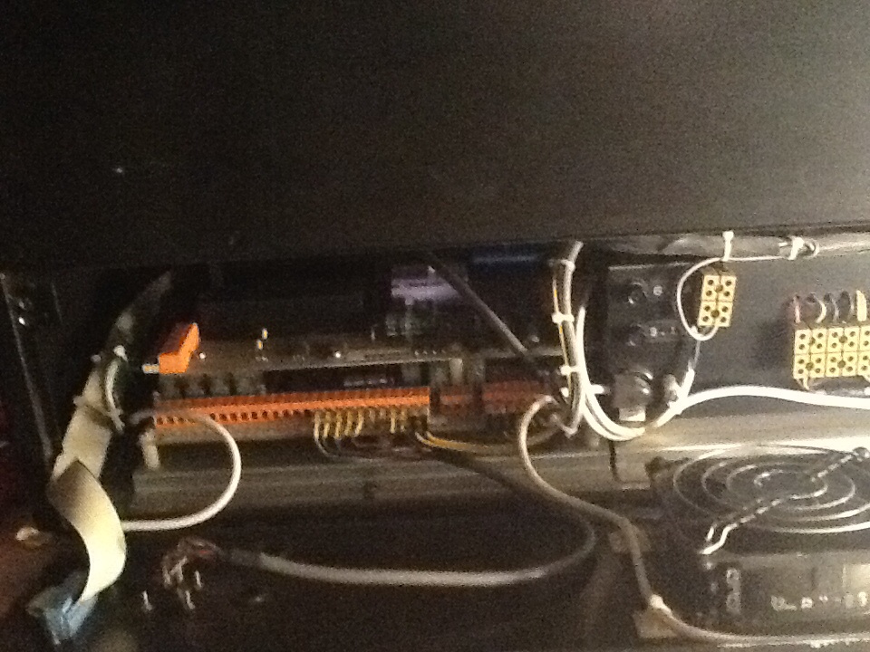

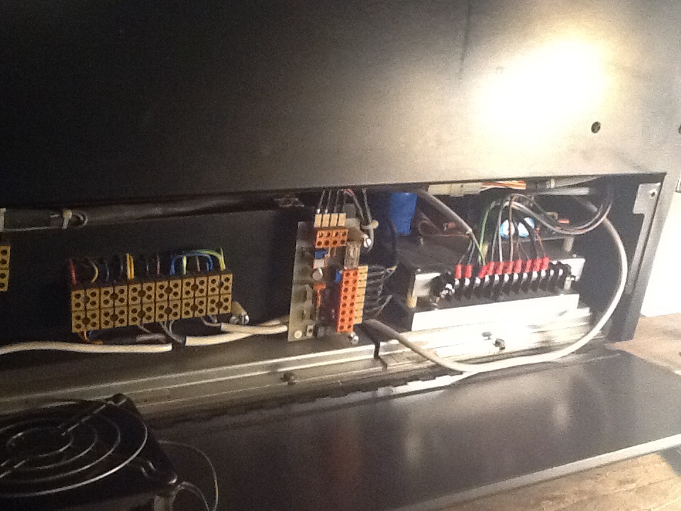

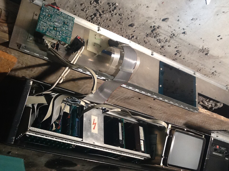

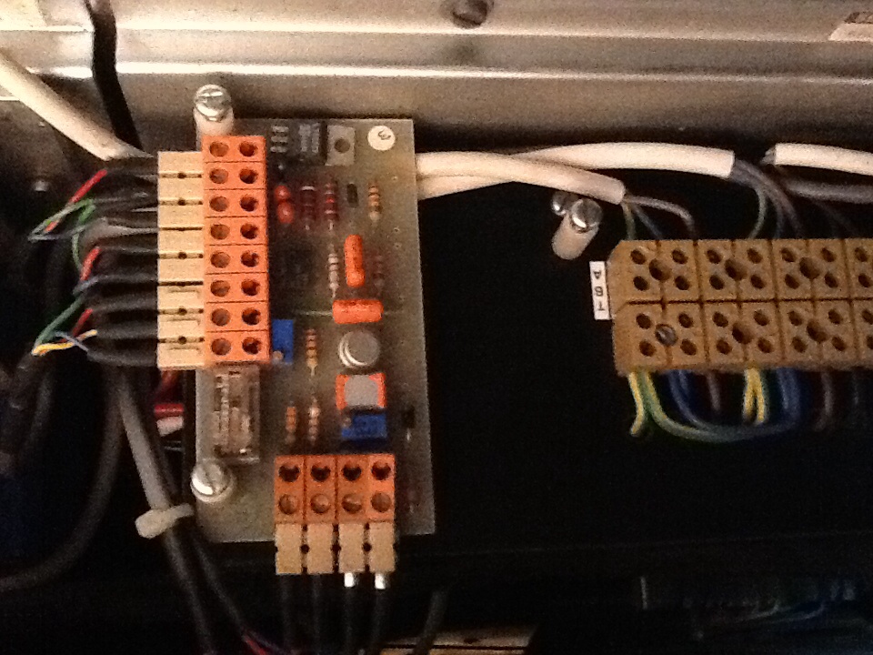

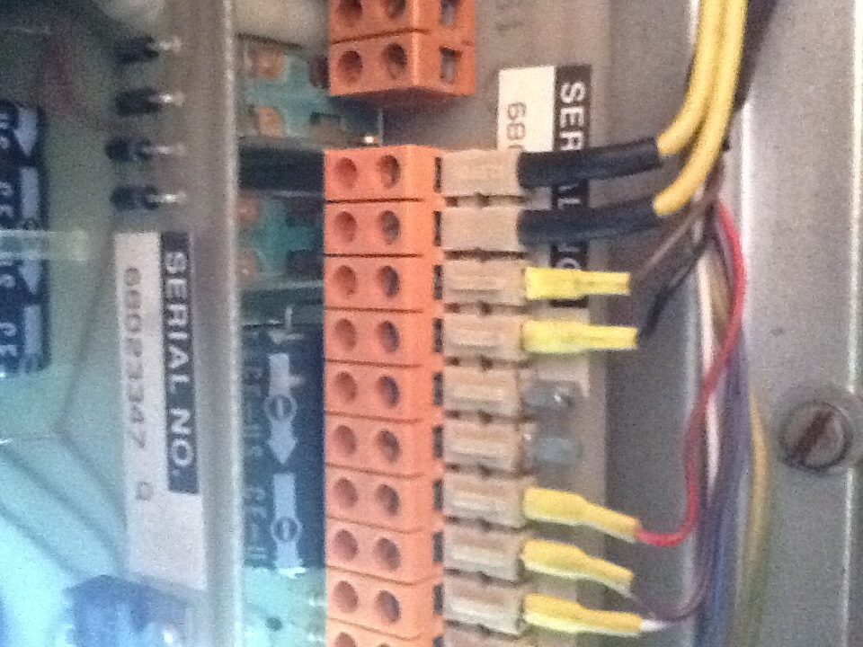

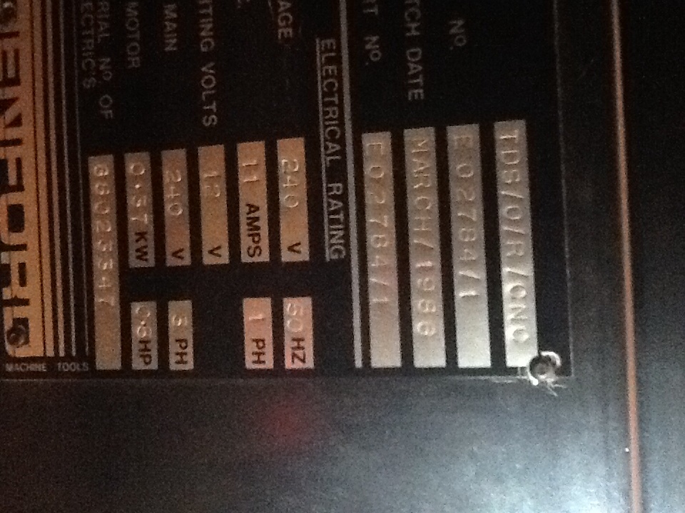

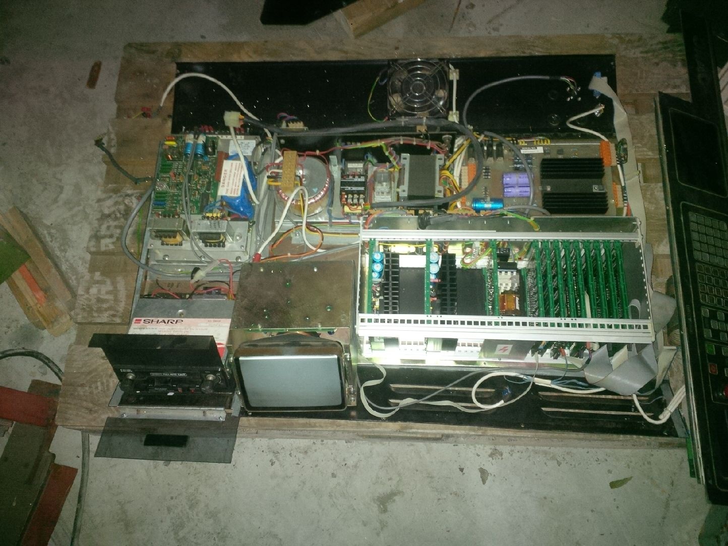

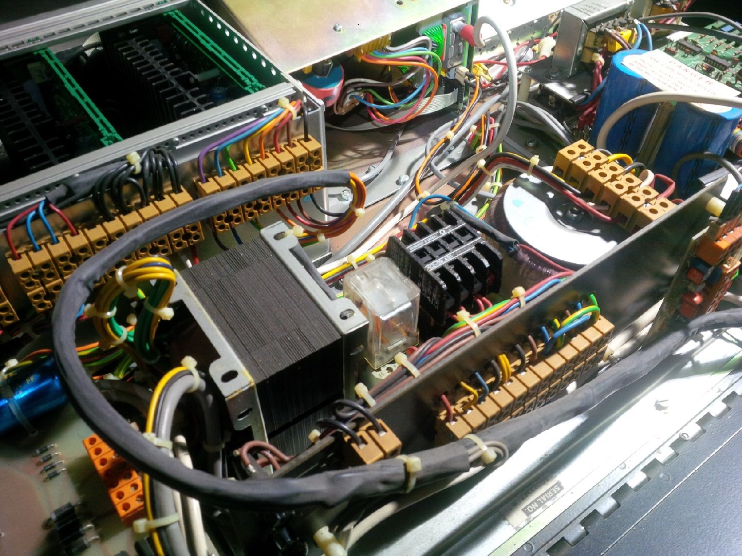

I have seperated the lathe and taken some pictures
it looks like the lower voltage orac, so the sd2/3 drivers are correct for that machine. Have you tried the reset button.

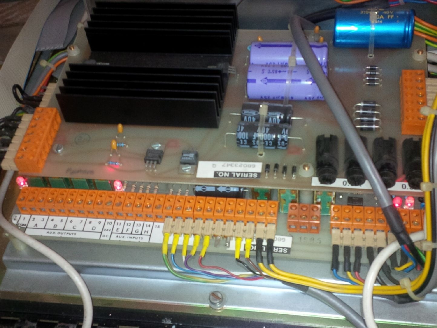

Here is a picture of four red ligths that turn on. I guess they are indicating a failure?
- image.jpg (313.62 KiB) Viewed 28784 times
I don't think any of the LED's are showing faults. I presume the one on the left is either 5 or 12 volts, the one in the center is the 24 volts & the two on the right are showing the spindle encoder. If you turn the spindle by hand they should alter.
