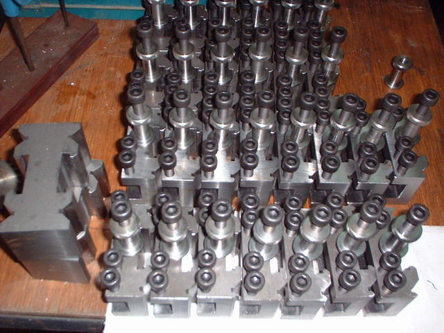

Took a while to find the photo but included it to motivate you (or to drool over)
- Dixon holders.jpg (120.75 KiB) Viewed 11061 times

These were done the old fashioned way before I had a Triac
They're size 1 holders - I think the orac etc uses smaller ones. 63mm between Vee centres seems to be etched on my mind (don't know why
If that's anygood to anyone I'll do you a dxf or dwg when time allows
