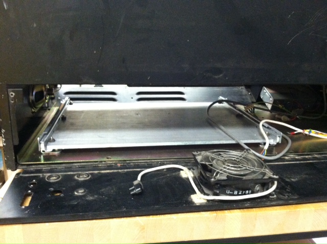

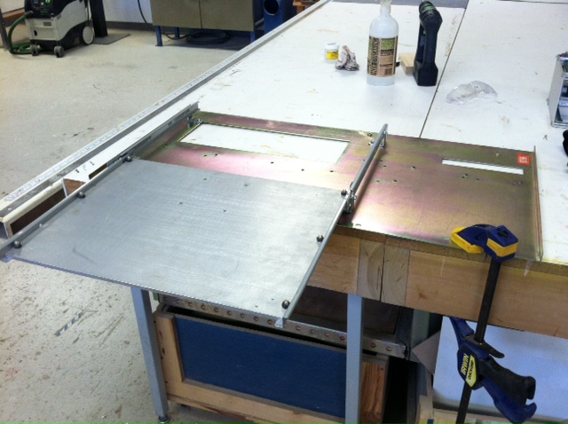

As stated, I removed the old electronics, including the brass panel in the bottom of the cabinet. I've mounted a 6mm thick aluminum sheet onto drawer slides and then mounted that all to the brass panel. This will allow me to slide the electronics in and out of the rear of the cabinet with ease (though I'll have to remove the fan temporarily).

- photo (4).JPG (122.63 KiB) Viewed 15170 times
- photo (3).JPG (122.41 KiB) Viewed 15170 times

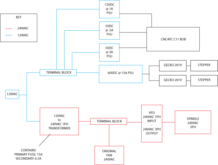

So far I haven't finished all the wiring and cable routing, and wanted to get some input here first. I've attached a real shoddy schematic of the wiring as it stands now. Since I'm no electronics expert, I'm wondering where I should put fuses.
One quick thing: The power supply I'm using to power the VFD/spindle/fan is one that was commonly sold with models in the US, to ramp up the power from 120VAC (wall outlet) to 240VAC. This will be mounted inside the cabinet.

- ORACSCHEMATICS1.jpg (170.57 KiB) Viewed 15076 times
Re: Orac Drivers - Swap?
I'm no expert either but it pays to protect everything you can... before it burns out or blows up.Since I'm no electronics expert, I'm wondering where I should put fuses.
Unless the drive has quick blow protection already, then I'd fit some quick-blow fuses to the mains input to VFD.
I'd probably fit one fuse to each input to the four 110vac power supplies...they might have output protection already but worth checking.
You could just fit one,say 15amp fuse on the 110v line (ie before the terminal block) but it might not protect the smaller supplies from damage, unless it was something major like a dead-short.
Fuses could be fitted to the spindle motor output and field coil (if it has one?) but it depends if the drive has some short/overload protection..they may not be required.
Basically, try and fuse the inputs and outputs to each device...especially if there is a chance of a short (eg wires running through a drag chain or connector that could be crushed). Something cheap like the fan you may decide to not bother with.
