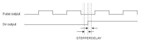

Post by Denford Admin » Tue 12 Apr , 2011 16:52 pm
A very belated follow up to the MSD542 losing position - we ended up not using the drives so the problem went away...for a while
Recently, we ended up using some larger current drives that appear to be based on the MSD542 logic... these gave us the same problems of occasional lost steps.
To cut a long story short, we fixed it by setting the StepperDelay on the Baldor control card to 4 microSeconds.
This parameter in effect, stops the step pulse from changing just before, or after the direction output has changed state.
We think that the Motion Control Products drives were losing position because they were outputting the occasional step at the previous direction (ie, it hadn't been fast enough to notice that the direction had changed, before outputting a step pulse)
HTH - it's the kind of issue you'd probably only notice with a very fast move-buffering system and a program that changes direction often.
