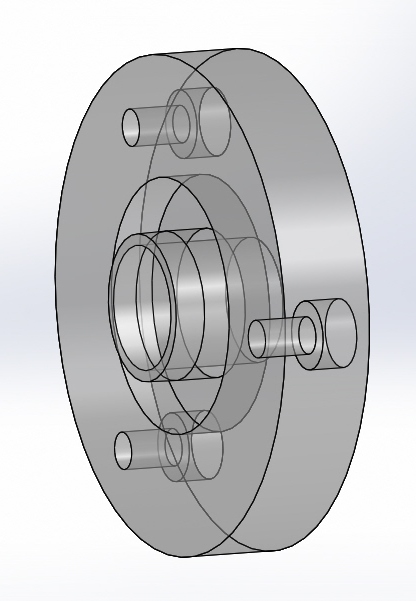

I've been wondering about fitting (or making) a collet chuck for my Orac. It looks like no-one knows definitively what the taper is on the spindle nose. I'm wondering about simply using the morse 3 taper on the inside of the spindle to provide concentric registration, and using the m8 bolt holes to hold the thing in place. Seems like a simple solution but no-one seems to discuss doing this - is there an obvious reason why not that I haven't though of?

Hi Luke,lsteele wrote:I've been wondering about fitting (or making) a collet chuck for my Orac. It looks like no-one knows definitively what the taper is on the spindle nose. I'm wondering about simply using the morse 3 taper on the inside of the spindle to provide concentric registration, and using the m8 bolt holes to hold the thing in place. Seems like a simple solution but no-one seems to discuss doing this - is there an obvious reason why not that I haven't though of?
I thought about that, The problem with that is you loose in spindle bore... 20mm is already not very big.
Laurent
Re: Orac spindle nose taper
Yes I've just realised that myself!
But you could still make the morse taper hollow. Like this (attached)
Obviously it's a compromise between wall thickness and smaller clearance diameter.
The ideal would be to know what the outer taper is - seems crazy that no one knows!
-Luke
-Luke

The problem is even if you know the taper angle, you still need to know the diameter of the taper coincident with the plane where the flat of the spindle nose meets the backplate surface (if you see what I mean). The taper and flat surfaces need to be in contact at the same time. It's hard to get an accurate measurement of that diameter. Perhaps it'd be possible to do it by some amount of trial and error, but that doesn't sound like fun.EVguru wrote:As far as I've been able to find out it is a variation of the DIN 55021 spindle nose standard. The standard starts at 3" (size 3), so the Compact 8/Orac is smaller than the definition of the standard. However, the taper is the same on all sizes; 7 degrees, 7 minutes and 30 seconds, or 7.125 degrees.

Exactly...lsteele wrote: Yes I've just realised that myself!
Well, what's even more crazy is that you can not even machine your own back plate on the ORAC itself!lsteele wrote: The ideal would be to know what the outer taper is - seems crazy that no one knows!
