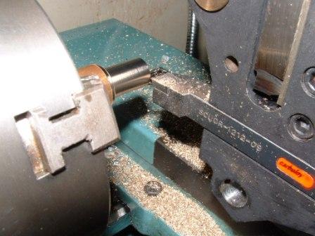

Hi Martin
Thanks a million, removed cover to find brass chips at bottom up to light connections,
blew them out and all is back working. Brass wasn't the last material used in the lathe so for some reason there was a delayed action !!
Thanks also to AngelTech for advice.
Rgds, Emgee
Tool Collet turnedemail.JPG (29.87 KiB) Viewed 8459 times
