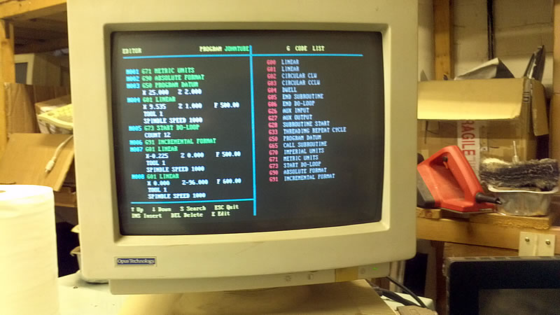

See image below for the original
Rob

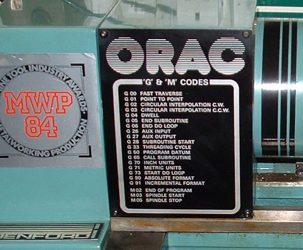

Re: something strange on my orac
Hi Rob
The Orac I have does have programmable spindle start and stop functions (M03 & M05) and it's not even one of the latest variants, manual shows spindle commands for all Oracs listed.
Rgds, Emgee
Rgds, Emgee
- G and M codes.JPG (59.55 KiB) Viewed 14832 times
The plate on my Orac does not have the Bottom 3 lines on it, finishes at the G91 Incremental Format
