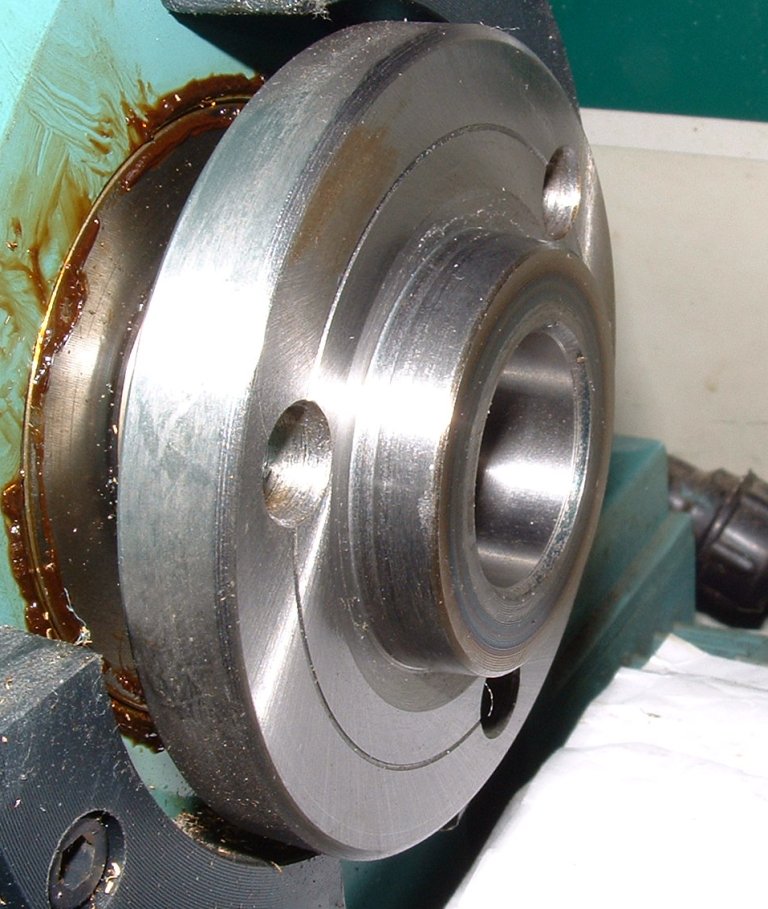

I would love making a new back plate to mount various chuck.
The problem is, on the ORAC the spindle nose has a kind of male taper used to locate the back plate.
therefore the backplate has to have a tappered hole in the center and....I don't know the angle! :-(

This question has been asked on the forum before but nobody has the absolute answer, it seems by the diameter to be a size smaller than any of the ISO charts I have been able to locate on the web searches.
You could make the hole in the backplate to suit the parallel portion of the spindle nose, it will need to be a wringing fit for repeatable accuracy.
The other alternative is to use a good release agent (wax and PVA release agent) on the spindle nose and apply some liquid metal paste to the spindle taper and bore of the new backplate before securing to the spindle. When cured and before removal, face the backplate and create the spigot to fit the recess in the 4j chuck, finally turn the OD to suit the chuck body.
The chuck to backplate fixings can be drilled and tapped off the spindle after machining as above.
Hope this gives you some more ideas.
Rgds, Emgee

It took me a bit of time and effort to get the chuck off, but it may have been there a while... I'll try again, it maybe easier now.
L
I tryed again... It won't definitively not fall off by itself after removing the 3 nuts! It needs a few taps from the back...
Just notice something on your picture, It looks like your spindle has been re-machined, I don't have that staight part on mine...It's a tapper all the way.
That's maybe why yours comes off easly ?
