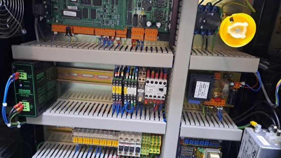

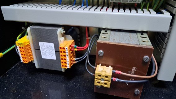

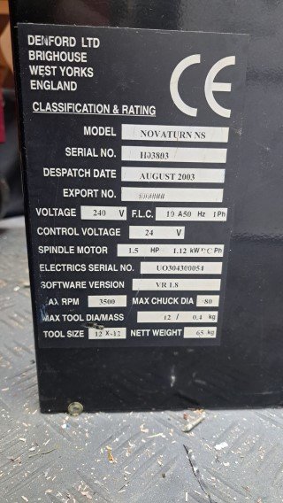

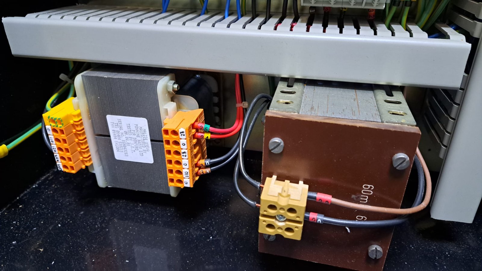

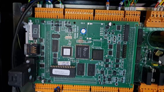

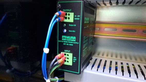

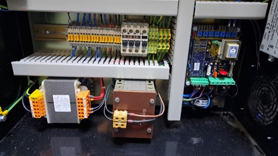

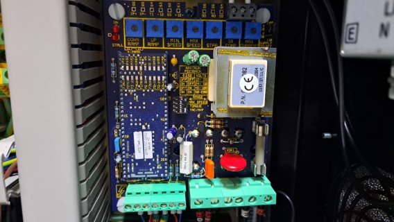

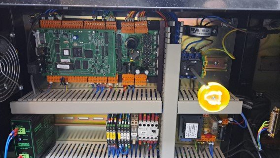

Can you post some pictures of the serial label & the control unit.
Novaturn-1 (Phone).jpeg (49.51 KiB) Viewed 9190 times
Done.
